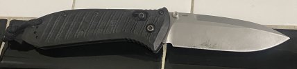

I have several knives with S30V steel. Benchmade & Spyderco. I can get a shaving sharp edge on them but with just a few soft cuts the edge is gone. Knife still sharp but not shaving sharp. What steel would be a step up from S30V?
This sounds like a wire burr. Your knife should shave long past that.
If you want actual "shaving sharp" then you want the type of steel used for razor blades. That would be a steel without carbides. 13C26 taken to a high hardness would be the thing. Such an alloy will retain it's shaving edge longer, but would then dull much faster than a carbide-containing alloy.

When you start cutting with a carbide containing alloy, the carbides (bits of ceramic) begin to protrude from the surface as the steel is worn away around it. That means you lose your "shaving edge" relatively quickly. But once exposed, the carbides wear MUCH longer than steel. That means that the somewhat lesser edge is retained much longer.
Steels without carbides do not have chunks. So, the fine edge lasts longer. But then there are no hard particles to resist wear and the edge degrades faster.

Spyderco and (especially) Benchmade do a good job with their s30v
IMO of your edge go after a few soft cuts you should have done something wrong with your sharpening
If you are confident with your sharpening skills and really want to upgrade the steel, try s45vn or m390
I posted this a couple months ago. Maybe you'll find it helpful. I can get my benchmade bugout (s30v) to split hair and it will hold a shave sharp edge for a while.
Anyways, if you have a wire burr this should solve your problem.
