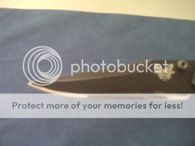

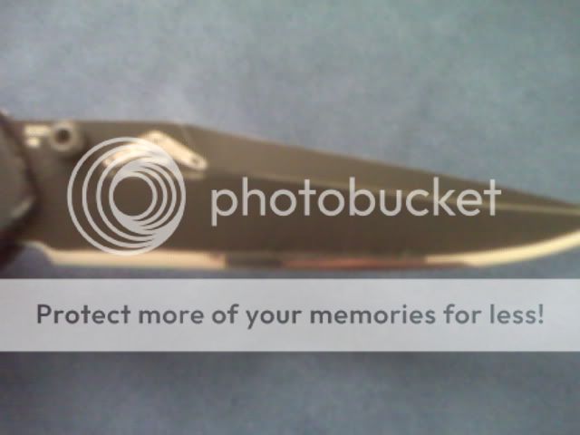

When I get home later, I'll take a crappy cellphone picture of how far up the blade the bevel on my 943 goes so that you can see what I mean about putting 30 degree or shallower angles on a "short" BM blade.
I thought the bevel was the edge?? I mean it's coming off of the shiny edge part that cuts! :D
In these two pictures you can see the bevel on the 943. The bevel measures 2.55 mm high.
If you think about triangles and trigonometry, the taller the triangle, the lower the angle is. The shorter, the more obtuse.
With short blades like several BM's, you end up having to increase the size of the bevel in order to accommodate this if you want to get the actual edge to 30 degrees or lower.
All other things being equal, in order to reach the same edge angle, the length of the bevel will increase as the height of the blade decreases.
