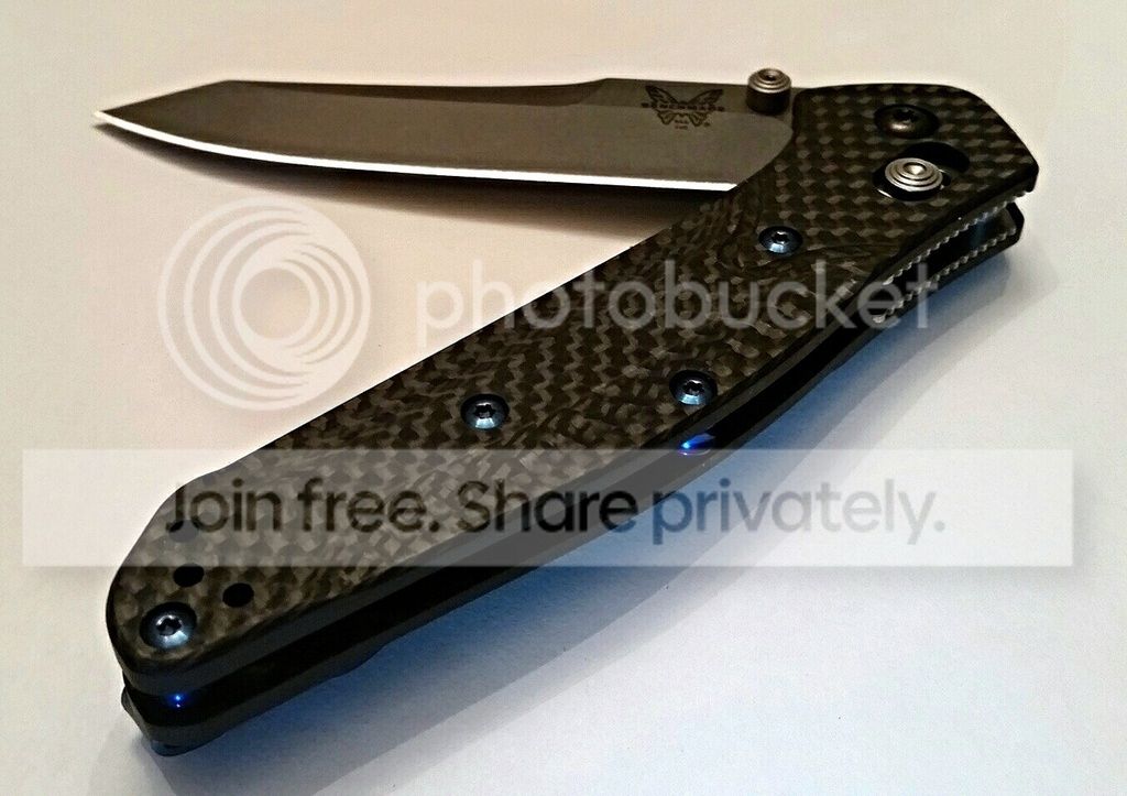

I haven't had mine long enough to speak on the steel, I hope yours was a lemon. I've had a regular 940 for years and love the CF/s90v combination. I can contribute with a pic though :D
Gorgeous knife isn't it? Very capable design too. Let us know what you think of it with some more use, if you don't mind. Thanks for the pic!
