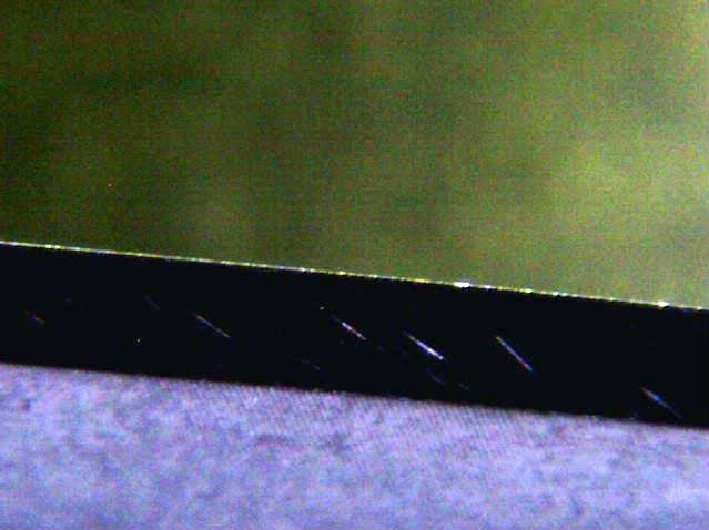

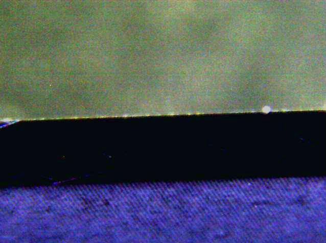

Edge after sharpening
Next day

I honestly don't see much of a difference. It's a bit grainy and the color is off though.

Well acording to that pic, you've got a lot of shine.

Looks like the edge from the second day is better.
But honestly what is going on with that...?
I am trying some new pic's now, I am having lighting problems and the shine of the polished edge is not making it that easy either. I know its not that big of a difference but notice how in the second picture there is more "teeth" and a roundness to the edge.

I guess it kinda does, although from the quality that could just be grain in a gausian distribution along the edge. Meh.
If you discount the quality, it looks almost as if the edge in the second picture may have a small microbevel on the edge. If you microbevel the knife, you could just be messing it up...
