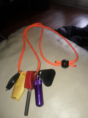

I haven't seen any that will withstand much pressure at all. I would suggest a cord lock with the cord ends threaded opposite through the lock, so if you pull, it has some resistance from the cord lock, but will pull out completely under sufficient pressure. It's how I wear my paracord necklace with my whistle, flashlight, firesteel, etc on it.

Chris, if you have a pic of your set up I would be very grateful sir : ) Thanks for the input no less :thumbup:

So, I took a quick picture of the necklace, showing how I have the cord lock on it. Sorry for the crappy pic, it's from my cell phone:
It's not uncomfortable and I haven't had any issues with it in the last 2 years wearing it on a daily basis.

Chris many thanks for taking the time sir! Gonna have to source some of those and give them a whirl.
