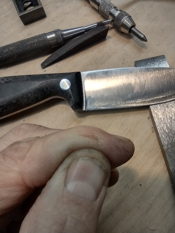

I'm so stupid
This would have been a trip to the emergency room if I hadn't just started the process of getting my edge sharpened.... I'm rushing on my coarse bench stones and my finger slipped off the knife's tip that I was supporting/guiding Hard into the blade. 15 minutes later once I actually put an edge on, and it would have been.... Ouch!
*Still scared the Sh*t out of me....
I got lucky.
