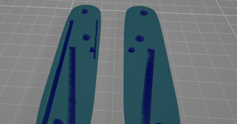

Thanks. Yes, I’ve seen some of the third party ones but the better ones are quite expensive. Yes, I’d like to retain the scale mounted tools. As well as the tweezers and toothpick I’d like to add the Victorinox pen.
A custom set from a 3D printer on the big auction site or the related site that starts with "et" might be your only hope.
AFIK all the factory "PLUS" scales with the pen slot have the cutout.
(I don't recall if any of the no cutout aftermarket scales have the pen slot. Heck, just the two side tool slots were rare.)
I could design the scales for you but thanks to Trumps Tantrum Tariffs you will need to find someone to print them for you if you are in the US.
Edit* Here is the file if you want to print them yourself.
