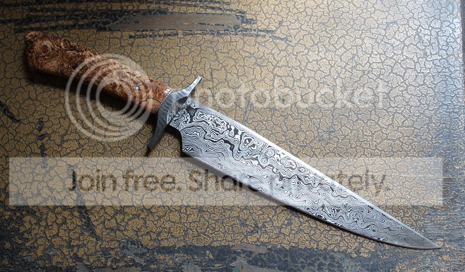

It's this one Salem. I've still yet to make a sheath for it. Too busy making sheaths for customers. I will get to it soon tho.
Oh yea, that's alright
The dimple in the guard is a nice touch.
Is there a coined spacer behind it ?
Salem that knife is absolutely breathtaking!!!! What is that handle material.......redwood burl?

Thanks, guys! Sam, yep it's a coined spacer, in Zildian cymbal bronze of all things. Antlerhog, it's spalted maple burl.

I watched your video and have a question for you; could you explain what you mean by "heirloom fit"?
Sure. I'm referring to the handle wood being shaped and finished so that it sits a little proud of the bronze spacer. This is so that even should the wood change size slightly with time and varying humidity (not super likely) the feel and appearance of the joint there won't appreciably change. Also, it looks cool if done the right amount- you'll see it in the furniture/handle joining on a lot of the nicer custom knives these days. I don't know who coined the term, though. Seems like an ABS thing, offhand.
Also, I feel that it makes assembly easier in some ways to have the levels of things separately defined... trying to get the highly finished handle matched exactly to the contour of the finished spacer could be a little trying, much better to slightly define them separately and not need everything to be flush. No need to worry about "struggling edges" if you accept and accentuate things sometimes.
Here's a closer shot of that area.

Please help me with the terminologies, do they call bullnoseing the joint area?

Stezann, I've not heard it called that, but it makes sense. I bet people do refer to it that way.
