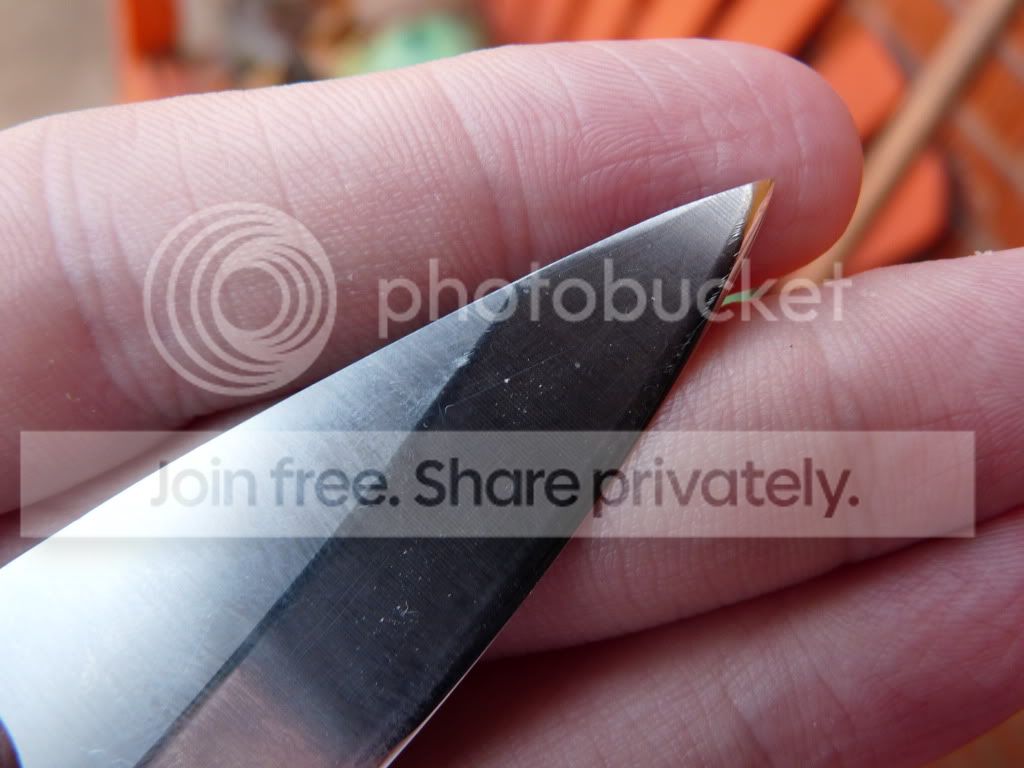

seems like a bad dream, nearly all my knives have corrosion. i've had a salt 1 a little while and was very happy with the rustproof H1.
upon closer inspection, it looks like my salt 1 has some corrosion on it! egads!! :eek:
it was kind of hard to photograph, its near the tip on the hollow ground portion of the blade. at least it should be easy enough to clean off. :D
Can't see it, but did you do any recent cutting or sharpening where you may have imbedded other metals into your H1 blade? That might be the source for any fine "rust" you discover on your knife. I've seen this on other "stainless" knives before.
Also, while H1 steel is theoretically rustproof, it is not corrosion-proof, so you may be observing some other type of non-water corrosion.
Remember, too, that rust has approximately 5x the volume of the iron consumed by it. It wouldn't take very much "foreign" steel on the blade for that to happen.

there are two dots on the blade. kind of hard to see in the pic but its there. i dont remember cutting anything that held metal in it, but you never know.
It's really tough to see in the picture. I must admit, I've neglected the hell out of my Tasman Salt and it still isn't showing any signs of rust or dulling. I would have to agree with the above that a bit of non stainless might be causing the spots or the possibility of non water corrosion.
Have you been stropping it? It may have picked up steel residue from the strop.
If that's the case, it will wipe off.

That's really interesting, but since it is only isolated to the scoring on the "1" and not he "H", I would still suspect residue left-over from the etching tool and not selective rusting of the H1 steel itself.
