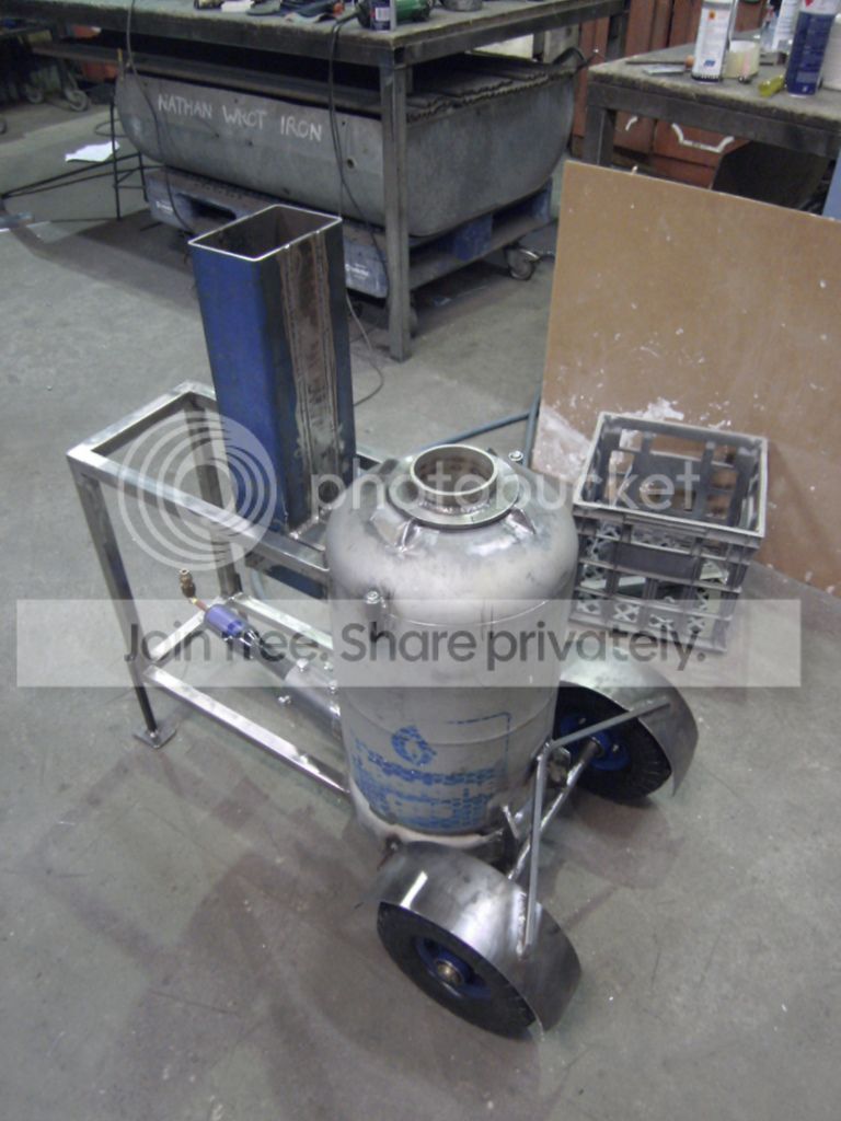

Sorry for the slow reply Tim, and thanks for all the info. I ended up going with Auber instruments as they were extremely helpful when i emailed them. I also managed to get 316L tubing instead of 304. Here's some photos of my progress. It's almost done, just need to line it with ceramic wool and fix on the gas equipment and electronics.
Chimney is designed so that i can pre heat blades in it to remove any moister before going into the salt. Wheels are solid rubber so will not puncture and also have splash guards so they don't catch on fire. SS pot hangs from flange that sits on lid, and is located by 4 tabs.
Salt tube it 100mm or 4" ID and 500mm or 19.5" deep.
Gas tank body is 600mm or 23.5" tall and 300mm or 12" diameter.
The chimney is 100mm * 150mm or 4" *6".
Burner is a 1" venturi.
Any thoughts or suggestions welcome.
[/URL][/IMG]
That looks pretty impressive so far, and you've clearly thought about it, which is a good sign.
Preheat in the chimney seems like a good idea but check the temperature with a thermocouple first: I suspect the exhaust temperature will be higher than the salt temperature. Good contact with the outside of the chimney might be enough for preheat though?
I've not actually used a salt pot of any decent size myself, but I've seen a tapered rod advised for the cooldown: it can be pulled after the salts are solid and leaves somewhere for the salt to expand into if it heats/melts from the bottom up. It looks like yours will probably heat from the bottom up.
I'd also fit a pressure gauge and mark up the burner choke sleeve so you can easily return to a setting once you've found it.

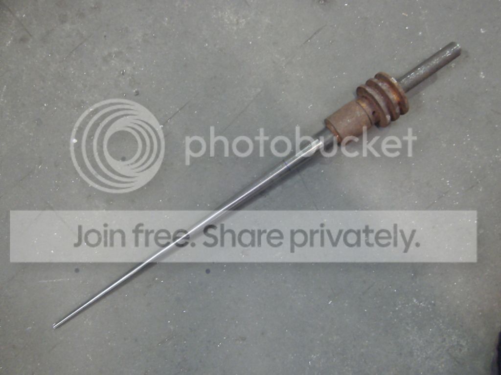

Yes I've almost finished the tapered rod. I'll upload a pic.

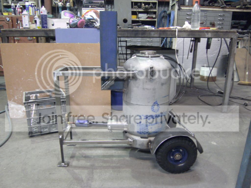

Here you can see the adjustable stand i made to hang the blades in the pot for heating, and the cover that can swivel over the pot. I will use the cover when firing it up, as the salts will absorb water while not in use, which will cause some spitting as it is heating.

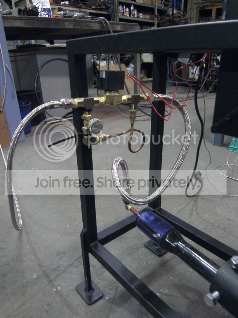

Here's the solenoid valve and needle vale for idling.

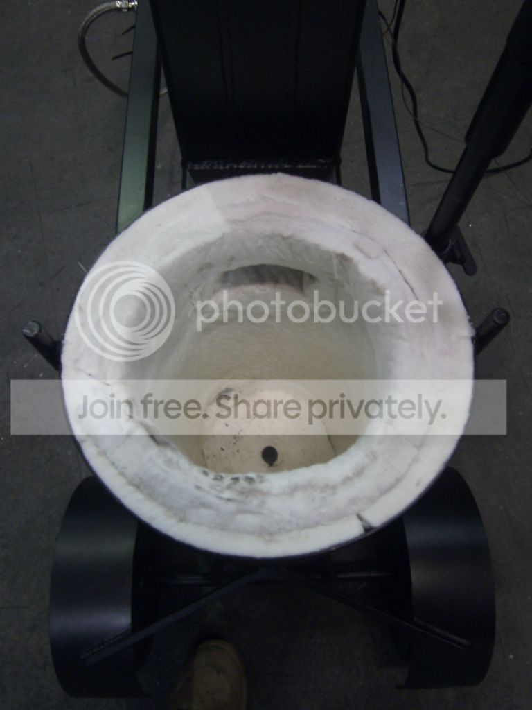

Inside of the body. You can see the support rod at bottom of chamber that sits 5mm below SS tube in case the lid slumps in a bit.
Tapered rod. The rusty piece of steel slides up and down the shaft and will be used as a form of hammer to remove the rod from the solid salt. I still need to weld a cap on the end that i will strike upwards against.
That looks like it'll work fine.
With the idle circuit, the pressure gauge is probably best located at the burner, or at least downstream of the solenoid valve and needle valve. It seems to me it would be nice to have a pressure reading when setting your idle circuit: flow through a jet varies as the square root of the pressure, so if you want, for example, a 4:1 ratio between heat input on full and heat input on idle, you'll need a 16:1 pressure ratio (maybe 16 PSI on full and 1 PSI on idle?).
