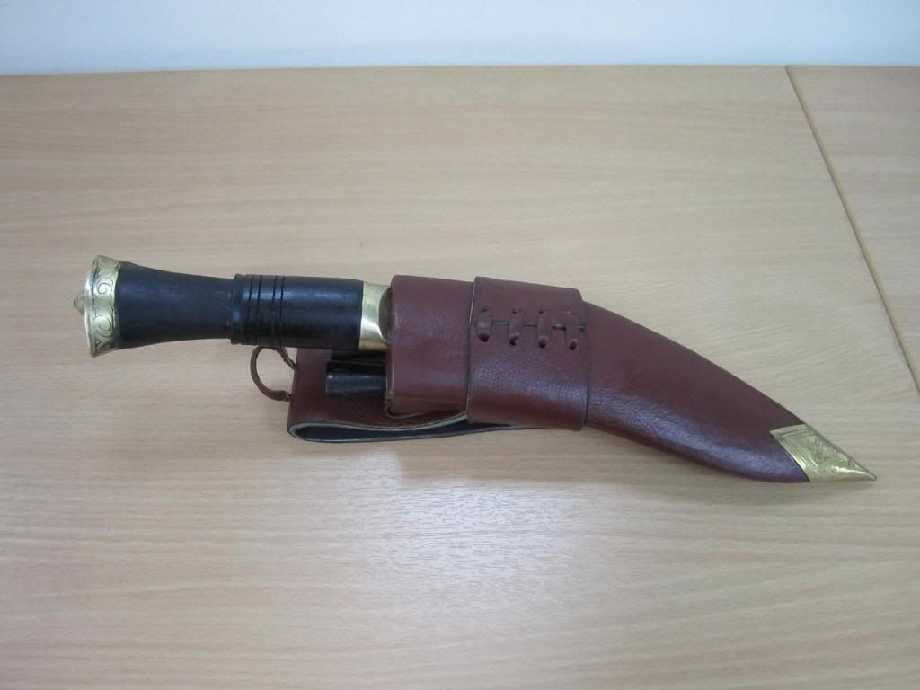

This Salyan is my 1st ever H.I.

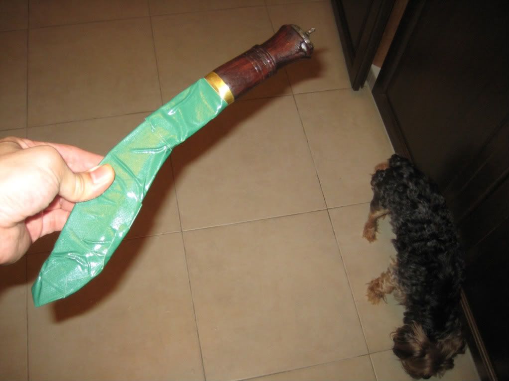

I have a rather big paw for an Asian and the handle dug into my palm during chopping so it got me to change a longer handle.
After the some searching i found a DIY shop in HCM City, Vietnam where a nice chap runs a shop, Hmong Imports and i asked for his help.
He was really helpful in helping me to select the wood to match with the fiery red scabbard and brass pommel and bolster.

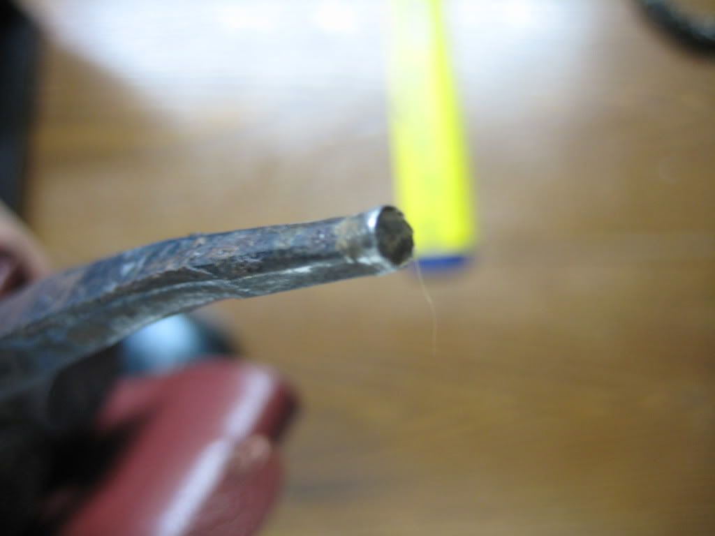

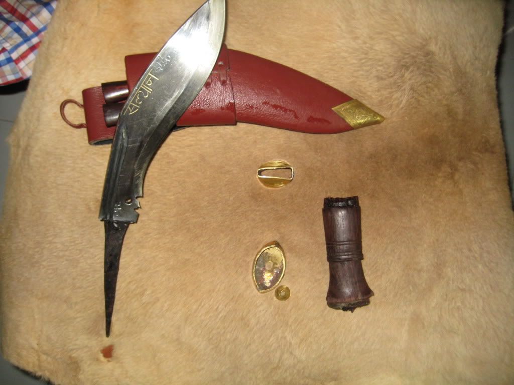

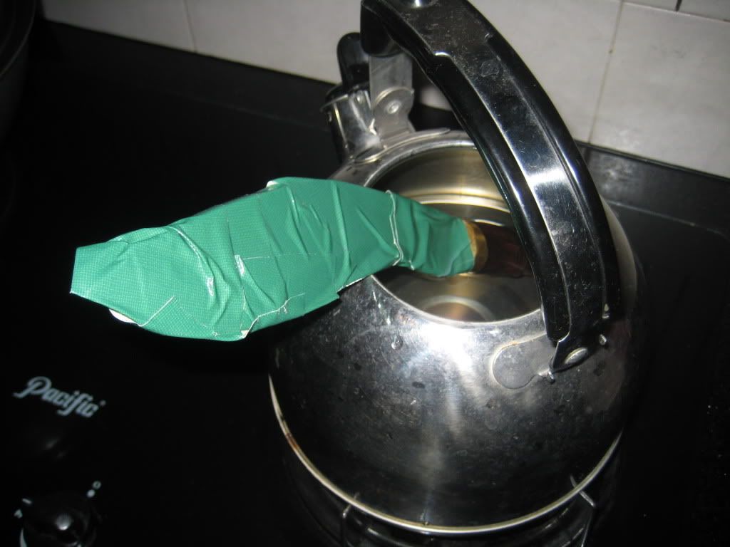

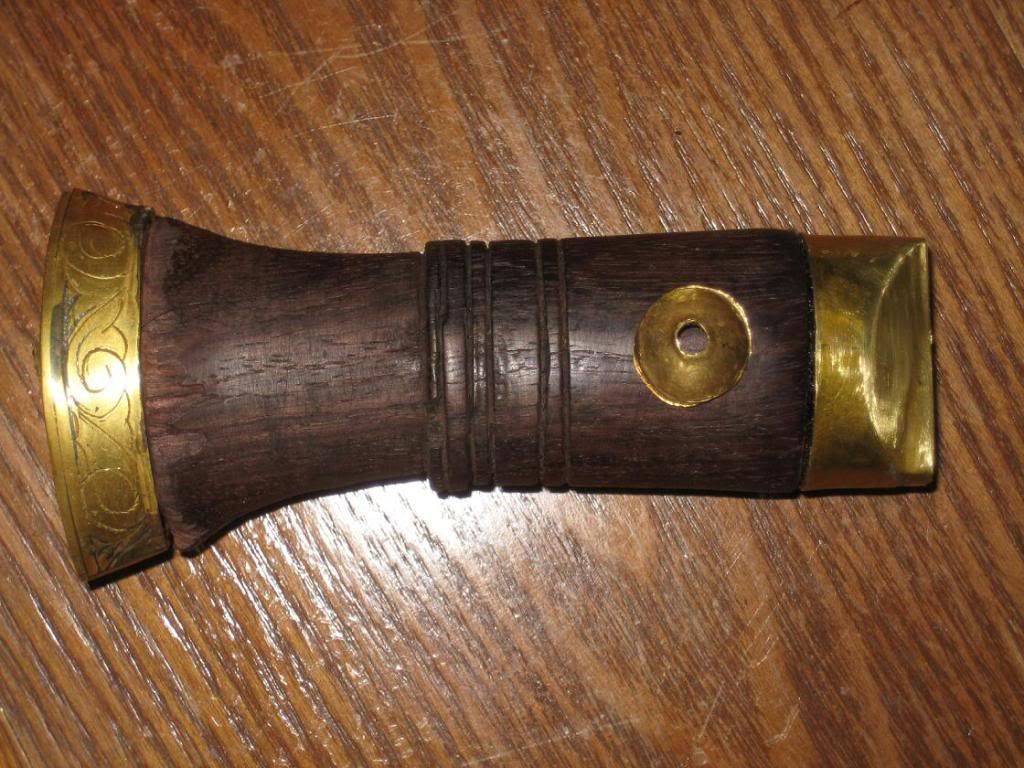

Before so i have to send him the original handle; The blade was wrapped with surplus of duct-tape for the sake of all the 10 digits i have now. The pommel, pin ring were easily removed with a few knockings after a scalding hot bath inside the kettle.
The wood handle took a longer time (20 mins) to seperate the laha.
I broke the famous notion here that laha is not tough; It's CRAZY tough. It smelt different too.My terrier probably wants to take a bath? sorry mate i'm afraid you won't survive.
Since everything was removed the excessive laha was difficult to scrape off the tang.
Have the tang measured for Mr.Hmong to start working on the handle length.

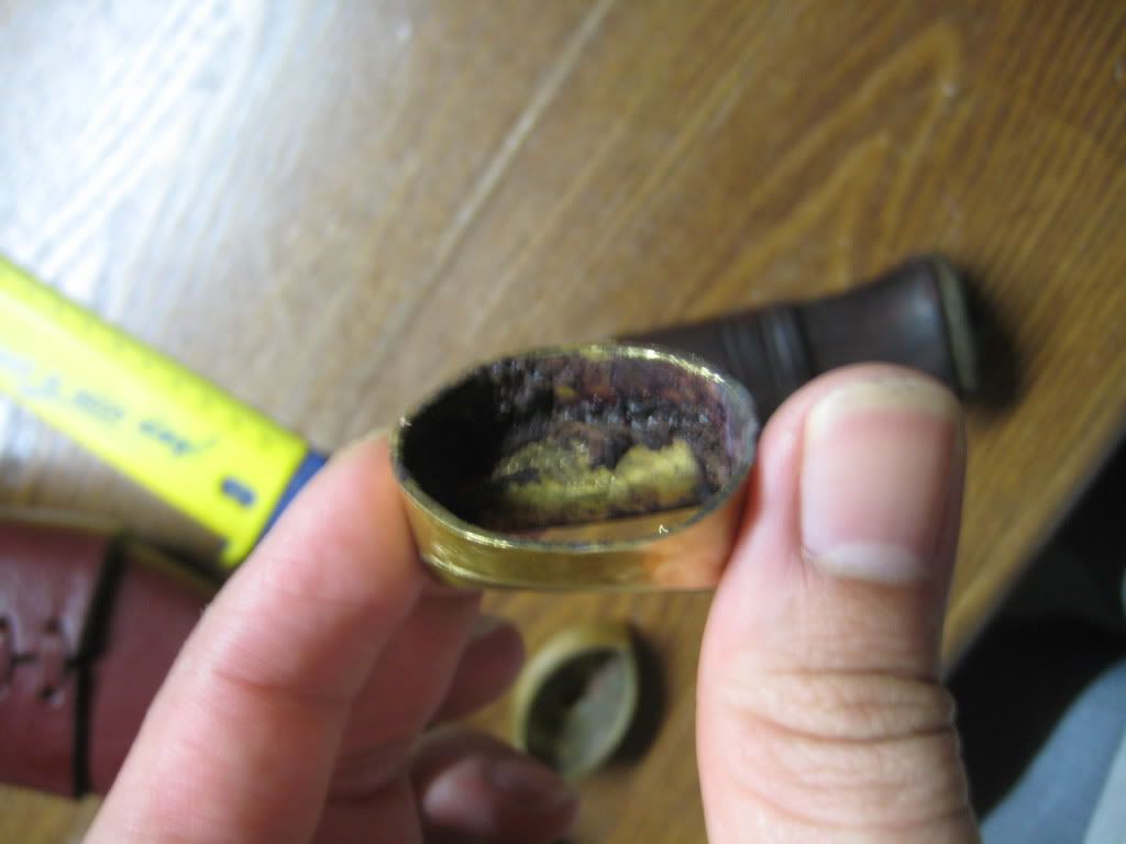

The inner surface of the bolster needed some works.
Ready to be sent to Hmong Imports.

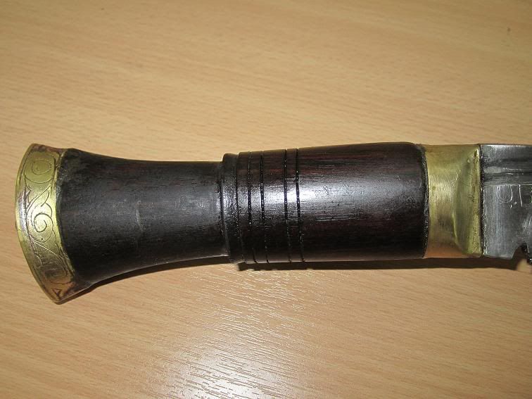

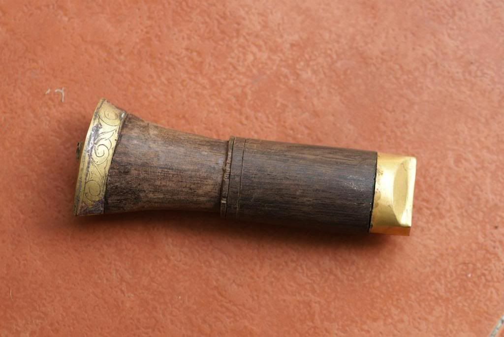

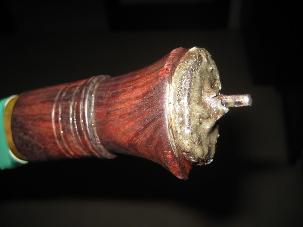

So off we go he got a very nicely done handle from Ironwood with the newly welded pommel time to get busy!
The new handle, welded pommel, ring pin and the bolster were sent back and it's mating time! Meanwhile the ironwood just came back from a week long bath of tung oil. The length of tang was welded with a longer piece of 5160 by a local smith.
I used Loctite Quickset with 3200 PSI and this thing is no joke. You want to make sure all your alignment is good and it hardens after 5 mins.

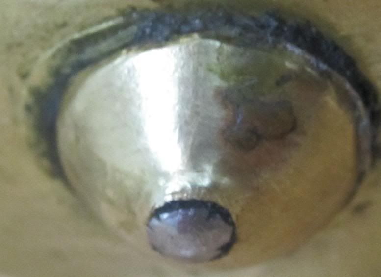

The exposed tang was then removed with a little head protruding.Another trip to the table clamp and i hammered the pin so it blocks the pommel from play during high impact (chopping).

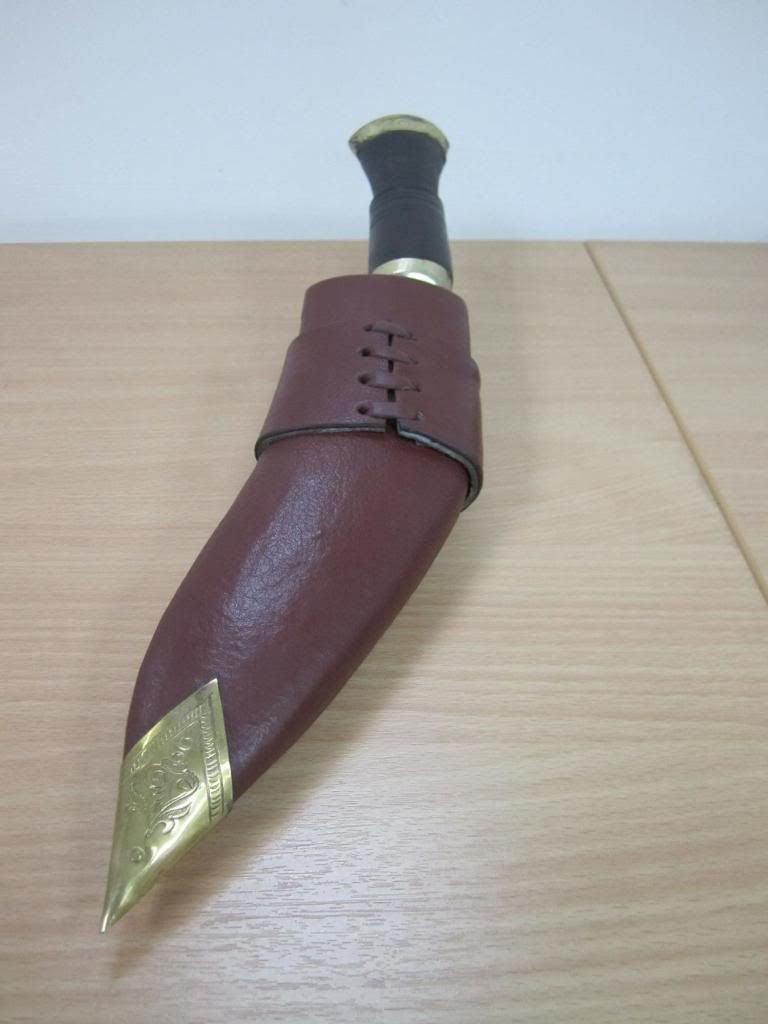

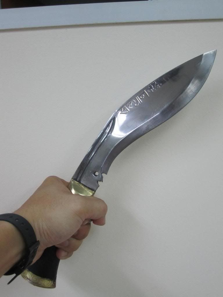

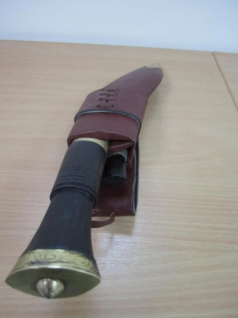

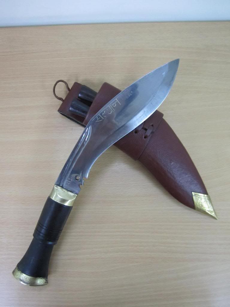

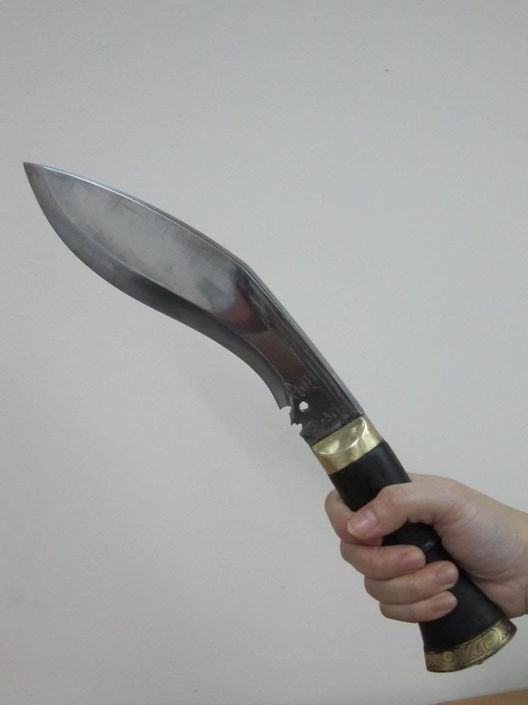

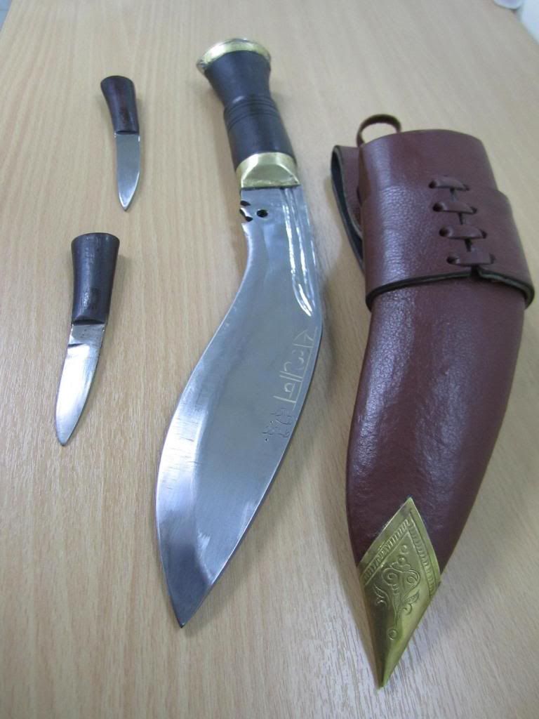

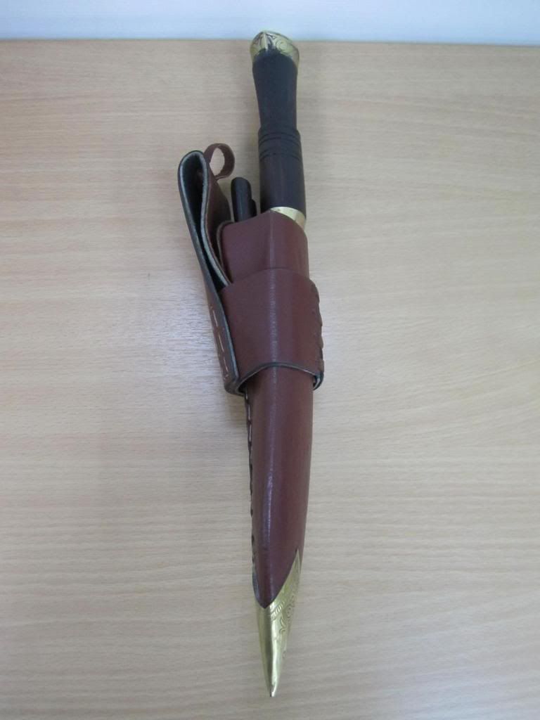

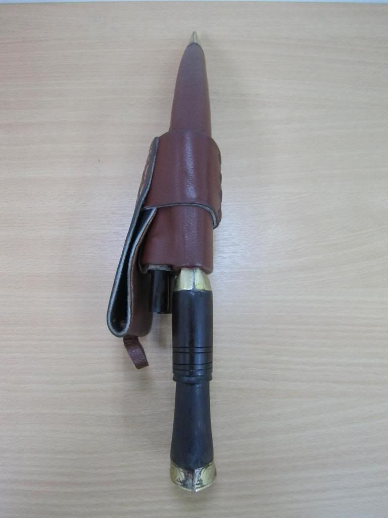

So here's the final product, 13.5" Salyan with longer and more ergo handle.
Mr. Hmong made the upper part of the handle slight longer to accommodate the space in between palm and wrist.
A comparison between a male and a female grip:

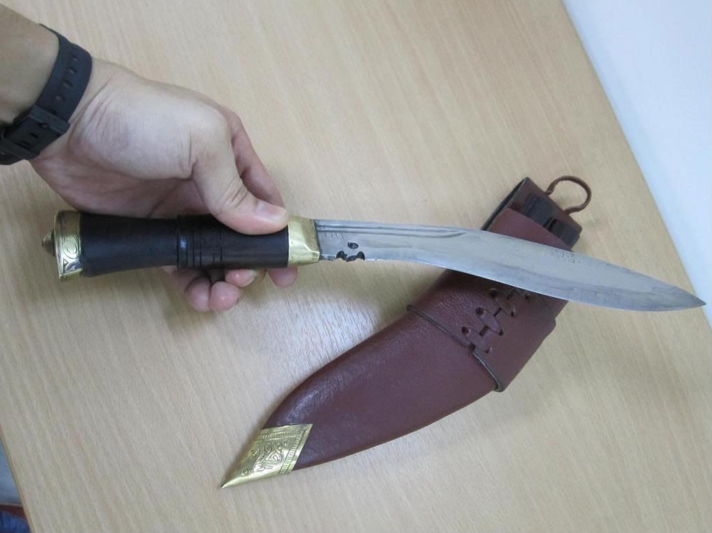

Last Saturday I went to see Jay in Penang Island to collect my Phillip Patton's cutter which was sent to Jay by Aunt Yangdu together with Jay's khuks. We had Hainan Cha (i.e. IIANM it's a Hainan coffee) and we had a nice talk about knives and khukuris for about a couple of hours :D
Before departed back to Kuala Lumpur I showed my Shop 1 18th Century Model to Jay and Jay showed couples of his khuks including this rehandled UBMS (i.e. Uncle Bill Memorial Salyan). I found out that the rehandling was done great. And it felt very nice in my hand. The 1.25" additional handle length really improved the hand grips and it matches nicely with the OAL of the UBMS. Surely this 13.5" UBMS is just the right khuk for backpack and camping activity. Hung and Jay's collaboration effort in rehandling UBMS was a success. Congrats to Hung and Jay :thumbup:
