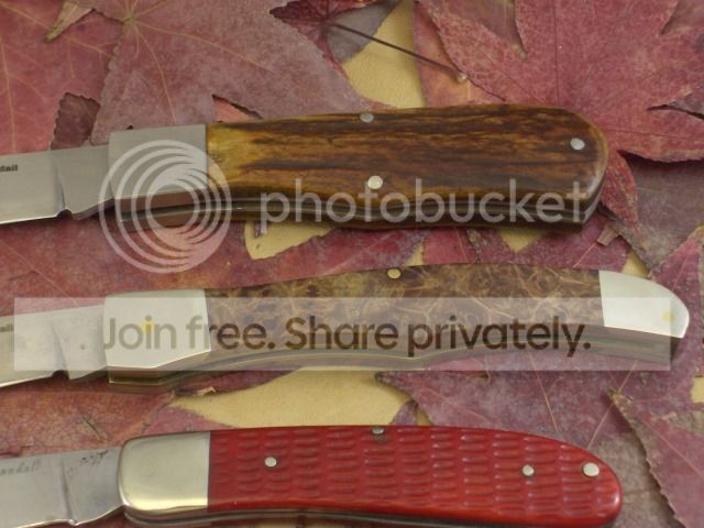

You could also consider Elk, it looks real nice an is wider and flatter than Sambar. The top knife in the pic is elk, it came from pieces more than wide enough. It is usually a little washed out in color so this is dyed with leather dye
