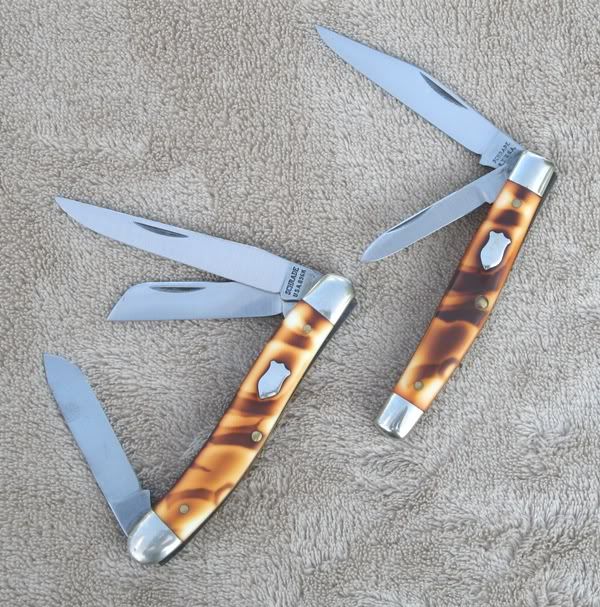

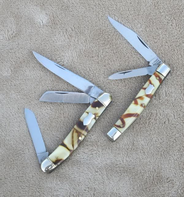

Here's a few more, including a couple of uninvited 89ers.

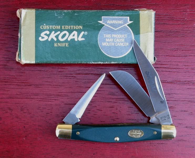

Skoal 36OT
33 and 34's
