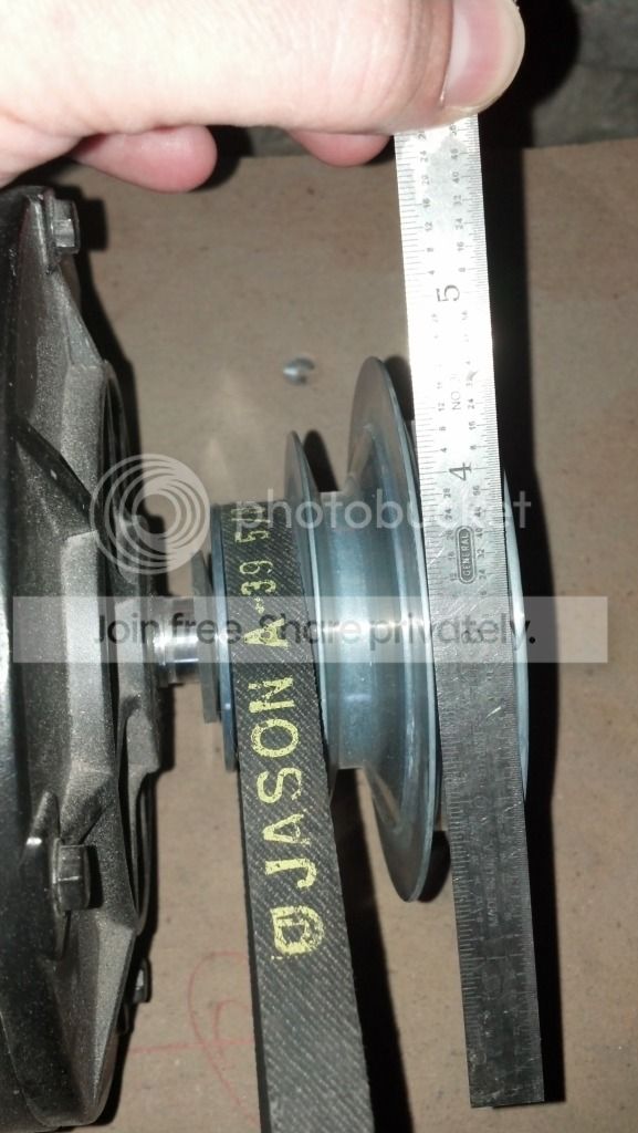

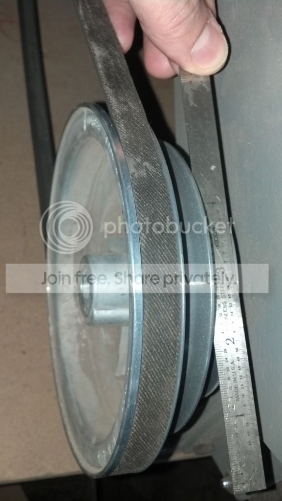

I am currently building a 2x72 grinder and will not have the $$ for a VFD for it, so I will start with a step pulley setup. Seems that everyone likes a slower grinder, rather than a fast one? My thought was that with a 1 HP motor that runs at 1750 RPM, by running a smaller drive pulley, rather than a larger one I typically see on peoples grinders, I can actually have lower belt speed and more torque available? Is my thinking correct? I turn my own wheels so I can make a drive pulley pretty small! I am thinking a 2" drive wheel. Thanks, Don
That is correct. Smaller pulley on the motor and larger on the grinder will give you a slower speed. Perhaps someone will chime in with a ratio to determine the actual speed, as I'm curious about this myself.
Motor:
Grinder:
You can just use a ratio of the diameters to determine the new speed, for example if you have a 1" pulley on the motor and a 2" pulley on the belt drive an a 1750 rpm motor you will have a new speed of 1750 x 1/2 or 875 rpm. To put this in perspective the small pulley must turn twice to rotate the big pully once. You can determine the belt speed in feet per minute but using the formula, RPM x drive wheel diameter/12= belt speed in FPM. Two step pullies mounted oposit of each other gives you a slower speed, no change and faster speed.
Torque is an odd animal, a smaller pulley will have less torque, you have less lever arm to pull the belt. You can maintain torque buy using a larger pulley and make the pully on the grinder twice as big, so rather than a 1":2". use a 3":6"
