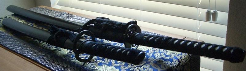

Do they need to be expensive blades? I have a Cheness Cutlery Katana and Wakizashi, very good beater blades.

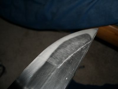

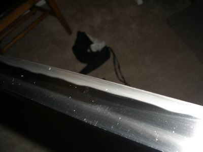

And the other pictures are also not "fakes", by my definition at least. Each was hand made, in a Chinese owned/operated forge. I have videos of there forge and a step by step video of how they assemble each sword. It's DEFINETLY not a "custom" kind of deal, and they are still pretty much "mass produced" if you will. But they aren't stamped out by machines either, each blade is forged and hammered by hand, they are also hand polished. The tsuka and ito wrap are all done/fitted by hand, no machine work there.
But like I said they are beaters. The kissaki is definetly not polished well, and really it shouldn't be. I've slammed that sword into 2X4's, through tatami mats, a good polish would be wasted the way I use it. I bought them to "play with", and if they break I won't have to take out a loan to repace them :P
the "hamon" on the welded blade pictured looks like it was done with applying some sort of resist while etching the pattern. Doesnt look like actual "activity" of a Hamon etc.... Looks like a fun blade though.

They clay it and fire it, differentially hardening the blade. It's alot more evident on my Shura model. But yah it leaves something to be desired when comparing to other methods such as acid etching or wire brushing. You'll definetly get a better looking hamon out of a, say, Bugei blade.

I believe that is 100% correct. But acid etching can be used on a "real" hamon to simply give it a different look. Take for example my Shura pictured in the 2nd pic, the hamon is somewhat "milky" I guess you could say. If you didn't like the way it looked you could polish over it and acid etch a different look.
But yah, most cheaper blades are simply wire brushed.
