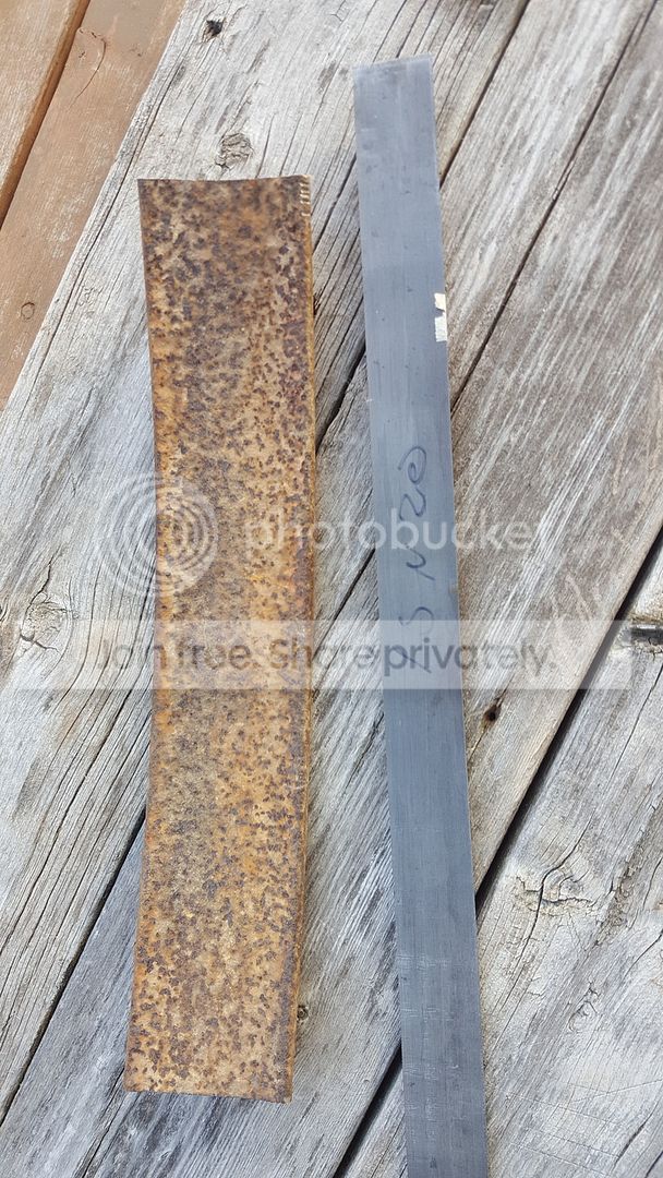

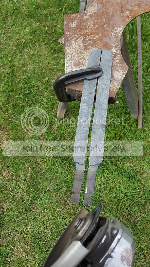

Wrought Iron fromm a wagon wheel rim (that my dad gave me) and 15n20 from Aldo Bruno:

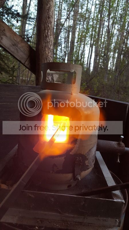

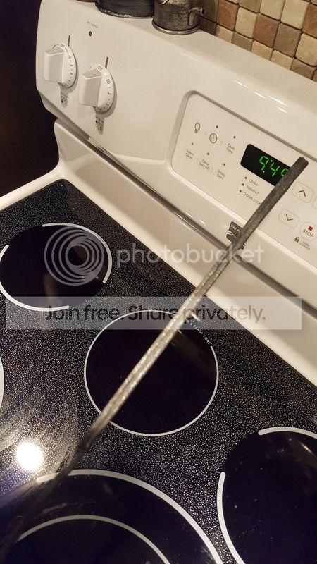

First up is to straighten the wagon wheel:

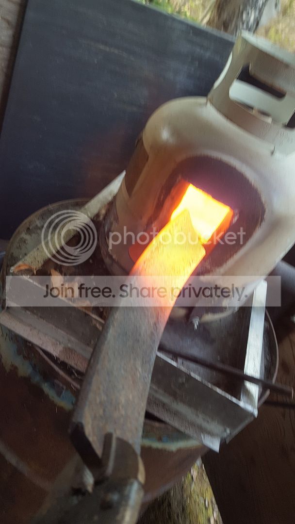

I was told to get wrought iron good and hot for forging:

I guess I missed photos of the next couple steps, but I cut two pieces 5" long x 1.25" wide from the straightened wagon wheel. Then I ground one side of each of them to clean, solid steel and tack welded them to a bar of 15n20:

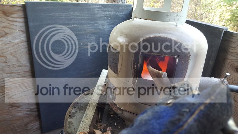

Run your forge hot if welding wrought. Also a little rich so you have nice flames coming out of the forge.
Thanks for the tip JT. I run a venturi burner, so not much control on the atmosphere. I did run 'er hot with flames coming out the doors though:
My friend DEllis stopped by with his 10lb sledge which made easy work of drawing out the billet:
The billet stretched out from the initial 5"x1.25"x7/8" to 9"x2"x1/4". Gonna split this billet into 2 and we'll each make a knife:
Looks like it welded and the core stayed pretty centered:

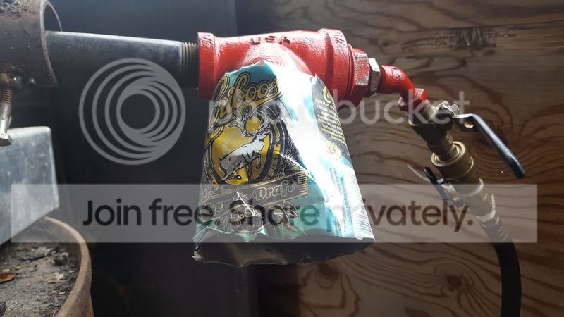

Here is the Adjustable Air Intake Control Cylinder I use on the venturi side arm burner:
When you depress the end of the cylinder it does reduce the air flow causing both more flames and lazy flames to exit the door of the forge.
You can see in this video that it was in place for the forge welding project:
[video=youtube;Y_N5-GdSCgo]https://www.youtube.com/watch?v=Y_N5-GdSCgo[/video]
Right. I do use a proprietary Adjustable Air Intake Control Cylinder (AAICC) that I developed. I'll post a pic of it later....

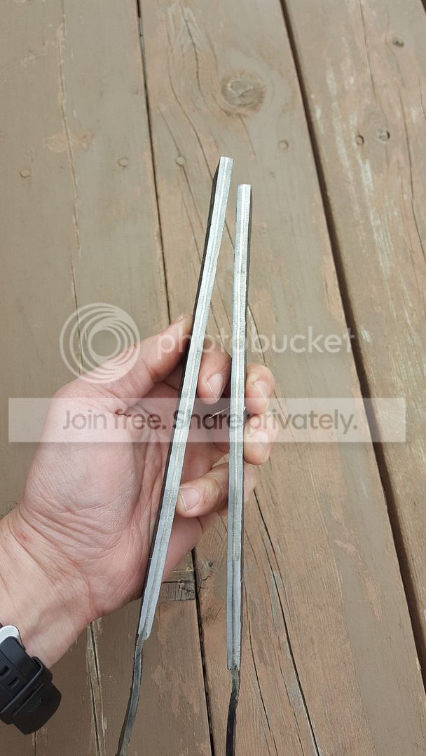

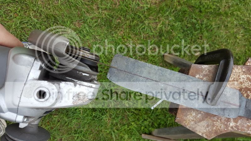

I marked the billet down the center, then cut it in half with a zip cut:
Then into vinegar for a quick etch:
DEllis and I were each going to make a knife from the billets but ran into some issues - which I'll let Darcy explain.....
I decided to make a Japanese inspired style blade from my half of the billet......I will let the pictures do the talking for a minute.
It showed much promise for turning out nice, except the core was a bit on the thin side. That, unfortunately, was a bigger problem that I thought. I managed to keep the core centered nicely along the edge, but after hardening the blade(full quench) it is not rigid enough. I tried to flex the blade, and it will take a permanent set with minimal pressure. The wrought iron just doesn't have enough strength on it's own, and the core is too thin to add the required rigidity. The core ended up about .035" and the blade is .190" at the thickest with minimal, but full length distal taper.
