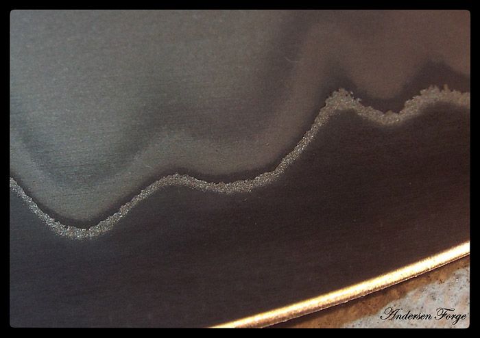

I have been using 416 for guards, fittings etc for like 8 + years. Like many others. I love it because it machines, sands and polishes easily.  410, which I have had to use on occasion because thin 416 stock like 1/8 got kind of, well, thin on the ground a few years back is not so easy to machine, cut, etc. I know that people use 416 for san mai cladding for field knives, but most of the Japanese san am kitchen knives seem to use 410 or some other variant of that recipe. My understanding is that 416 is more "free machining" because it has like 5 times as much sulphur as 410. My question is will that sulphur also have the effect of making the cladding more reactive to food acids and possibly give off a stinky sulphur smell? I have heard that mentioned with other steels. My other problem is that while 416 is readily available in thickness up to 3/8 or even 1/32 inch, 410 seems to only come thin. Any thoughts or suggestions?
 Where do you get your 420SS? BTW, that blade is NICE!!! Love that diffusion line.
