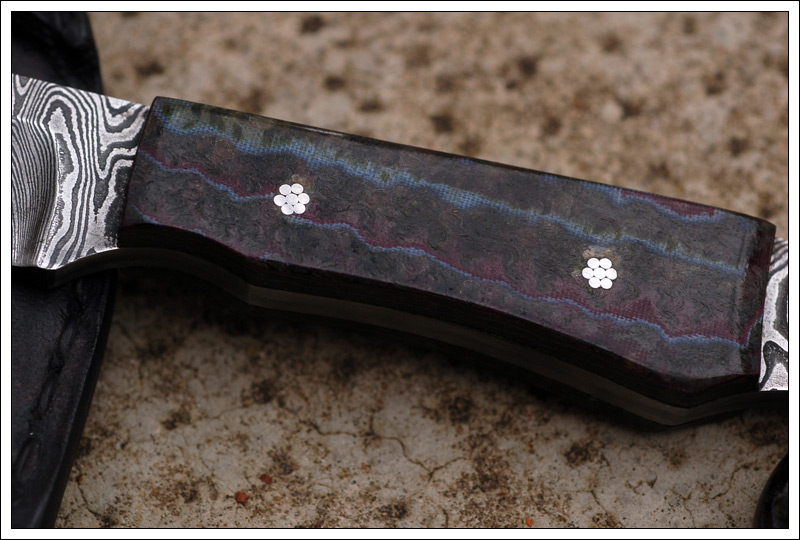

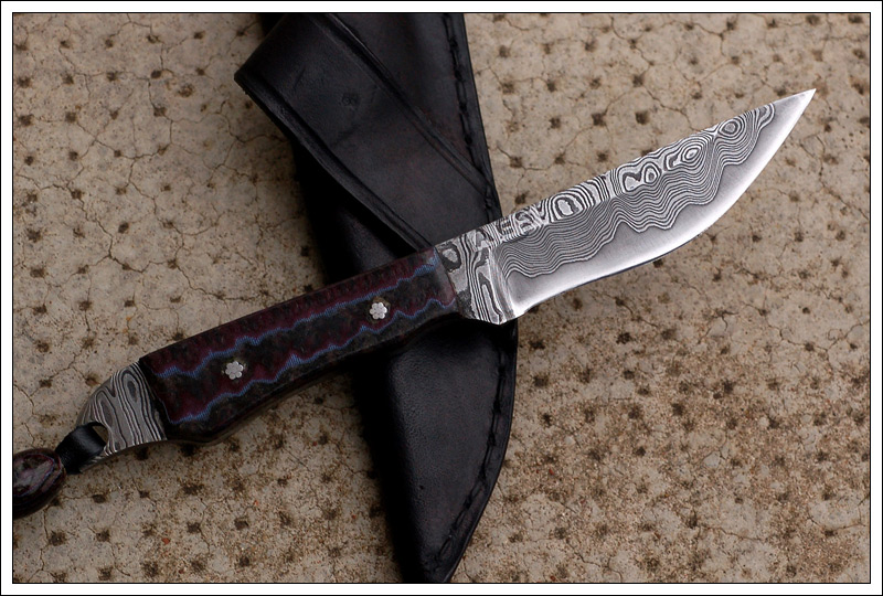

San Mai Damascus Recurve Utility Knife

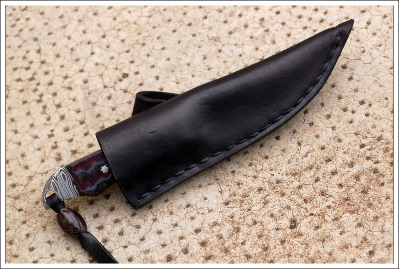

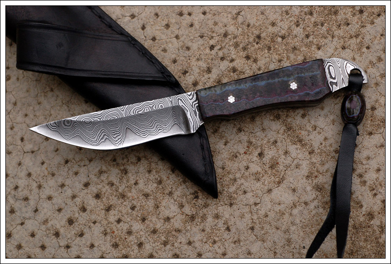

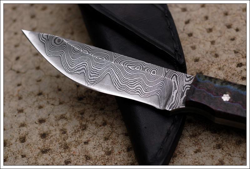

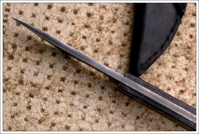

San mai damascus from 1010/1070 with a 5160 core.

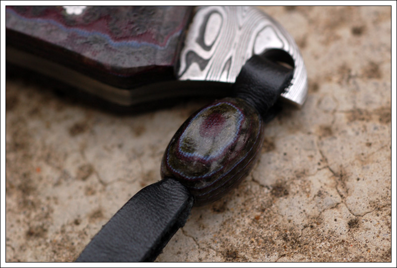

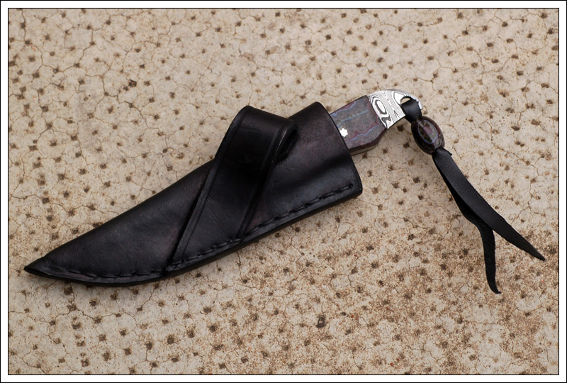

7" overall length, 3 1/2" from tip of the blade to scales. 3/16" thickness. Rug micarta with cable pins. Leather lanyard with micarta bead. Hand made leather sheath.

Dan, they are not 90 degrees angles, they topped with a 45 degrees angle (abouts) as I finish all my flat scales knives. They're quite comfortable to grip, even if the pictures may make it appear otherwise :)

Nice work once again, Ariel! I like the harmony you achieved with the materials, textures and tones. Those cable pins gave "the" touch. I am getting tempted to get one to complement the two nessmusks I got from you last year. Keep it up!
