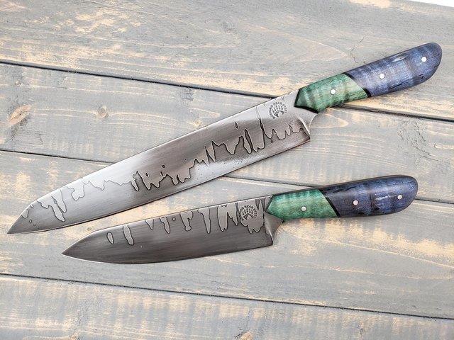

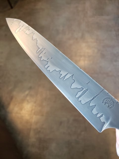

Here is my first attempt. I went with my normal etch, followed by two short coffee etches. It's not a great picture, but I'm pretty happy with the results.

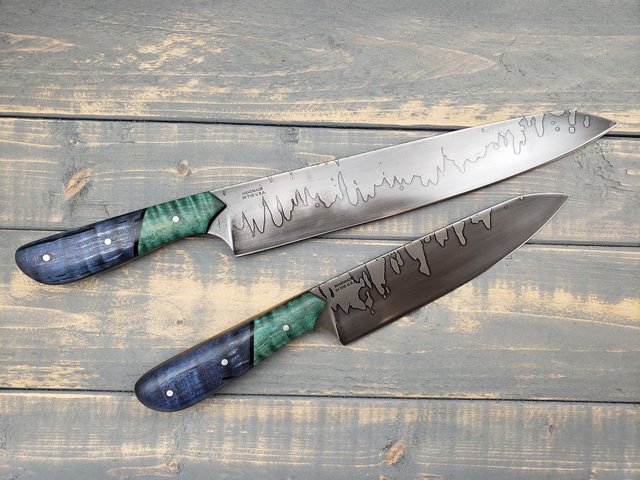

So I finished them. 1084 core, 15n20 cladding. The larger is about 13" oal with a 9" edge. The smaller is about 10" oal with a 6" edge. Both have stabilized curly maple handles with black G10 liners and separators.
I had fun finishing these. Thank you everyone who advised me.
Travis
Travis, what was your grinding/ sanding process before and after etch?
After a lot of research, I found that my usual process wasn't too far off. I grind to 220, then hand sand from 180 up to 800. Then it's into the FC for 4 or 5 cycles totalling no more than 15 minutes, rubbing lightly with a very worn piece of 1000 grit to remove the oxides. That brought out the transition line, but not a lot of contrast. I added 2 45 minute soaks in coffee to make everything pop, again sanding lightly after each soak.
