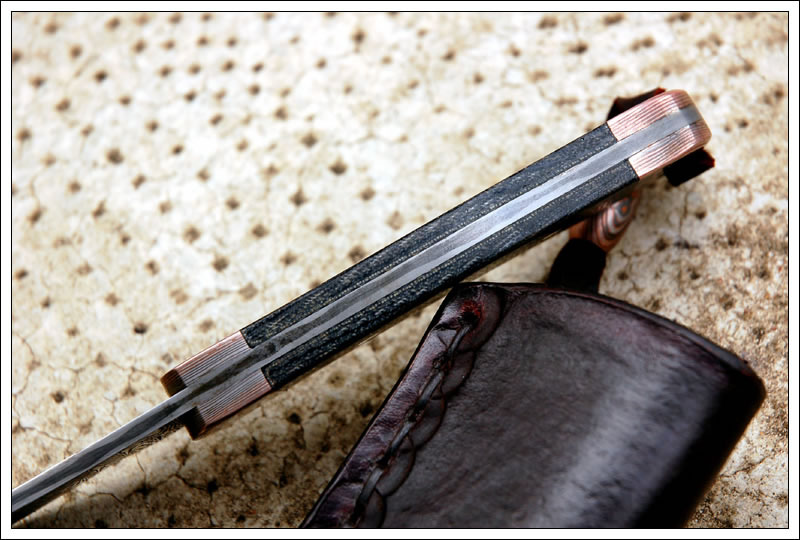

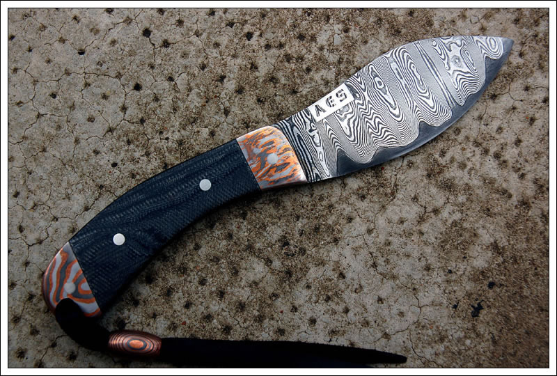

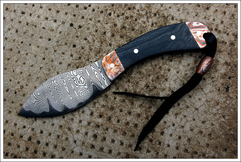

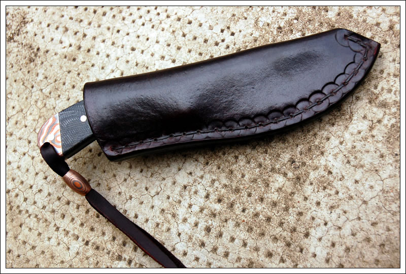

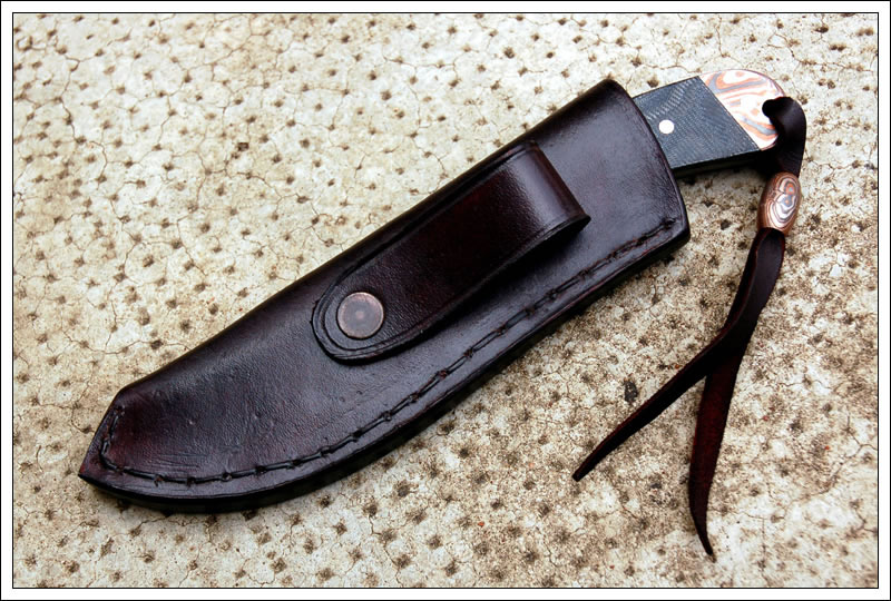

This one is ready to ship now too. Turned out really nice.

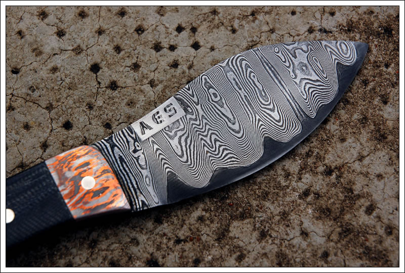

San Mai damascus in 1010/1070 with a 5160 core.
8" overall length with a 3 1/2" cutting edge. 3 3/4" from tip of the blade to the handle. 1/8" thickness.

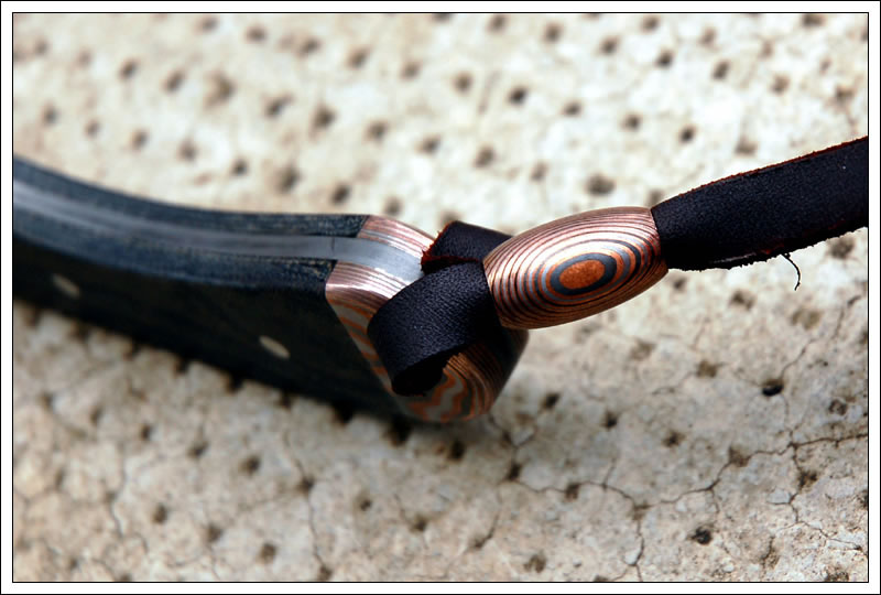

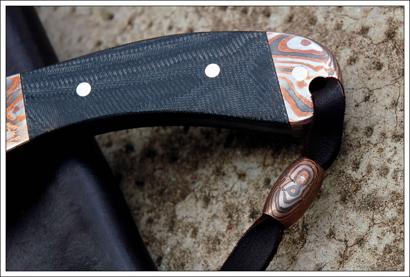

Twisted blue jeans micarta. Lanyard hole. Front and rear mokume (1010/1070/copper) bolsters and lanyard bead.
Heavy duty hand made leather sheath.
