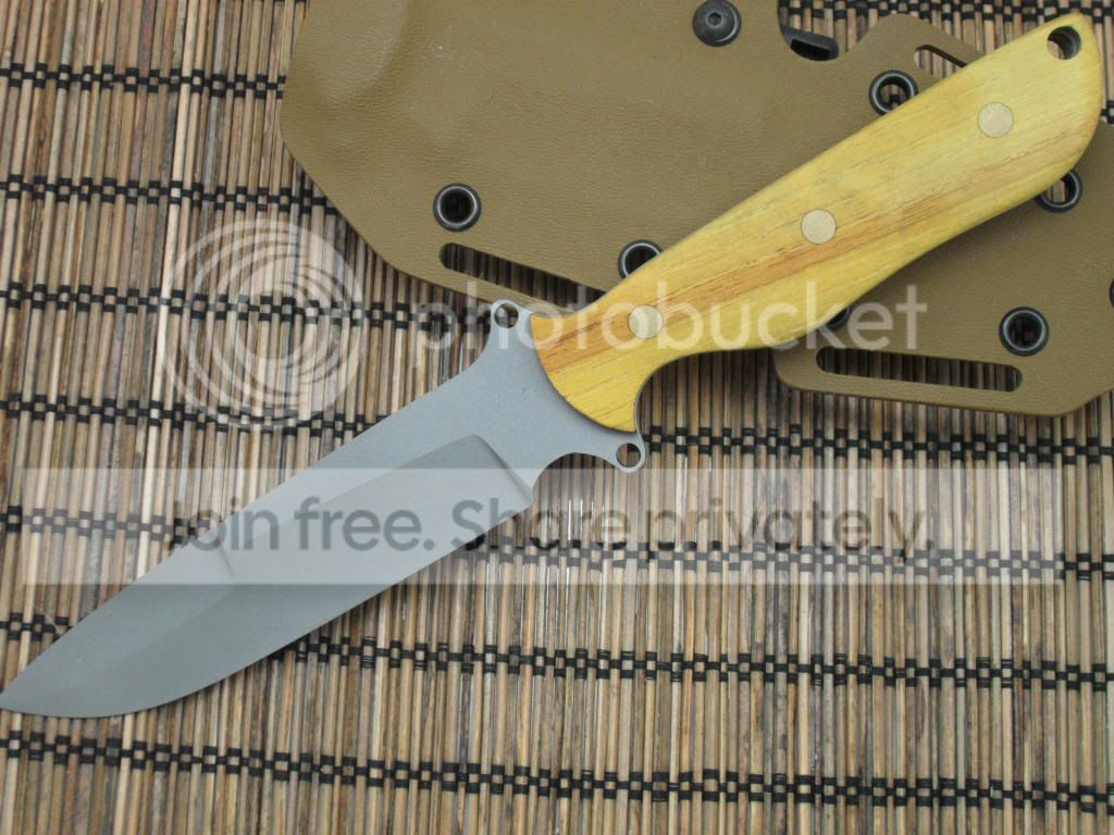

Heres a blast finished fighter i made for a customer.
GHaile
