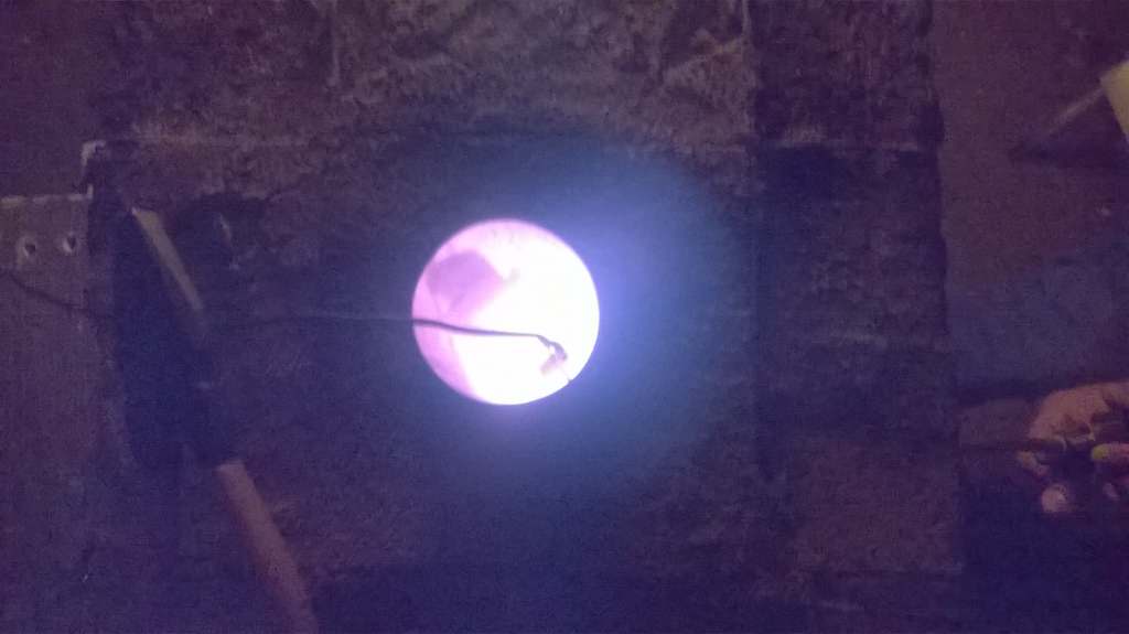

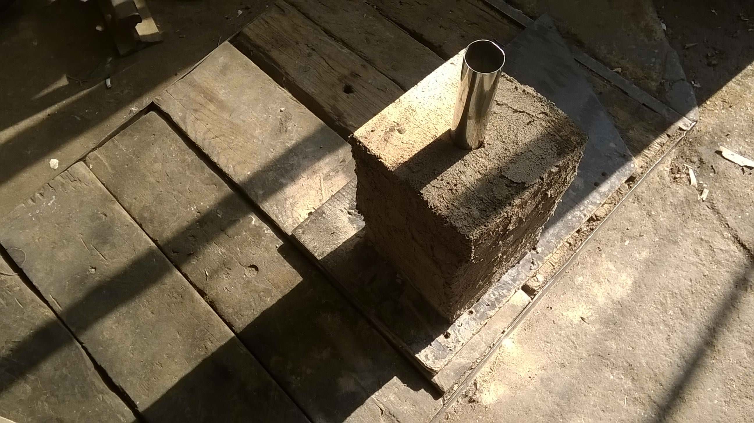

I made a small version and it works . But weed burner I use was weak .It take long time to reach 800-820 degrees Celsius .And it was the maximal temperature I achieved . But it works perfectly... From two inches above the bottom /Right above the place where the flame from burner enters/ and to the top of sand I have stable/constant temperature . Then I discovered that without sand I can quickly warm up and maintain a stable temperature of 800 degrees .........:D Now I'm working on electric version with 4 inch tube , but without improvisation .Much safer , no more that scary sound of burning gas ....Sorry I have just a few pictures .. . The first one is during construction .

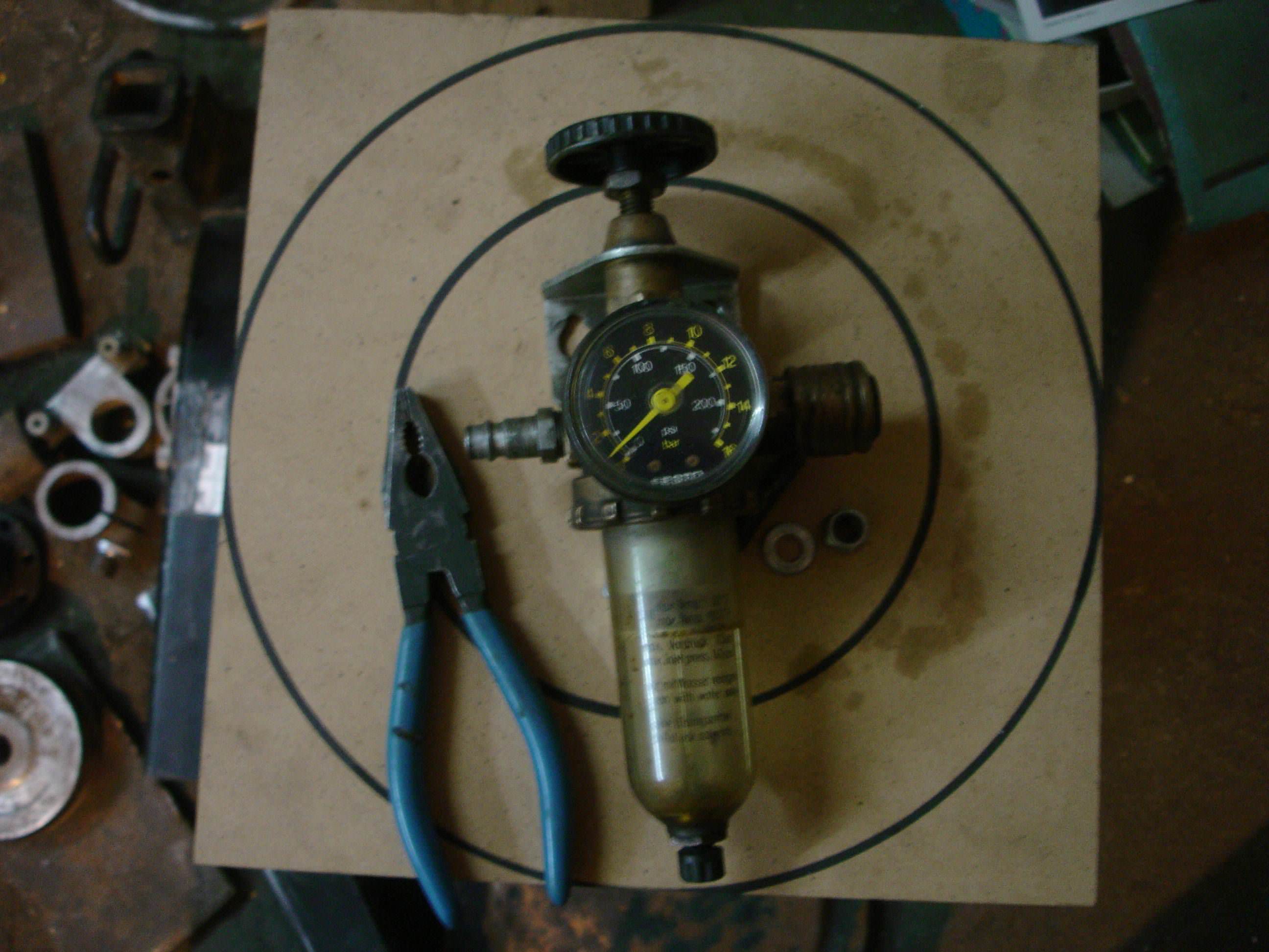

I work on electric sand pot JT .On picture is also with AO sand and with forced air . Air regulation was not a problem, I have a precise tool for that. Little tricky was to find how much jet and size of jet ..... I think I've experimented enough and that the electrical will turn out properly .
