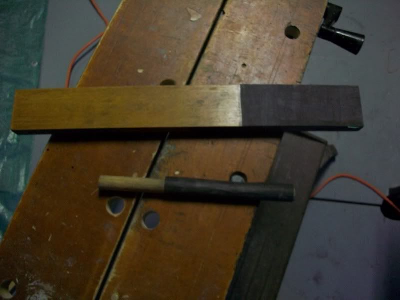

I did a search and could not find anything. I was reading a length thread with pictures of a guy making a knife from beginning to end. In it he showed some sanding blocks of different shapes and materials and now I want to make or buy some to help the hand sanding portions of knife making.
There were wood ones and metal ones. Some had a rubber layer to prevent the sandpaper from giving any hard edges while others were just straight metal or wood. Some were flat, some were rounded.
Also I wondered about various ways of attaching the sandpaper. Glue or wrap and hold, or some sort of clamp type.
I find hand sanding to be tedious and slow but in some ways more precise and thus even faster in a way. Somewhat soothing maybe, as long as you don't have a lot of pieces...
So post pictures of your sanding blocks or places to get them!
My sanding blocks are either pieces of micarta that I hold the paper onto or my metal/leather one. It's a piece of 3/16" x 1 1/4 mild steel, pointy handle ends with golfballs covering the points. I use spray adhesive to hold paper on the metal side and on the leather side I wrap the paper around the block. I'll try to get a picture up later.
The micarta blocks are all different shapes to get into nooks and crevices.
I just started using one of those hard-rubber sanding pads you find at auto supply houses. The rubber is hard enough that it doesn't give too much, and it's very comfortable to hold. I use cheap spray-on adhesive to hold the paper in place and can reach deep into the plunge line.
I also use a 12" piece of 1/2" angle iron. I need to cut it a bit shorter because I see some slight rocking with my hands so far apart. I was just wrapping the paper around it, but soon switched to glueing it on because it keeps my sharp edges sharp.
Nothing fancy, to be sure, but they work very well. Glueing the paper on makes a world of difference.

brand spanking new to making knives, I have yet to finish my first, its just roughly profiled at the moment. but when its time this is what I'll hit it with...
