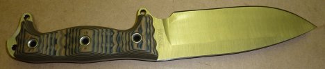

I had some time today to sand the G10 on my BIG ASH1. It took about 90 minutes. I really like the look and feel. Results below.

BEFORE:
STARTED WITH 80 GRIT
AFTER 220 Grit
AFTER 400
Comparison Pics: In after pic handles were oiled...
That looks awesome! I've always been afraid to sand multicolored g10 because the I never know if there will be enough of the lighter color left on top and if not, will I have enough material to get all the way thru the black to reach another layer of the light stuff again before I hit the tube fasteners, if that makes sense.
