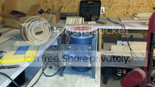

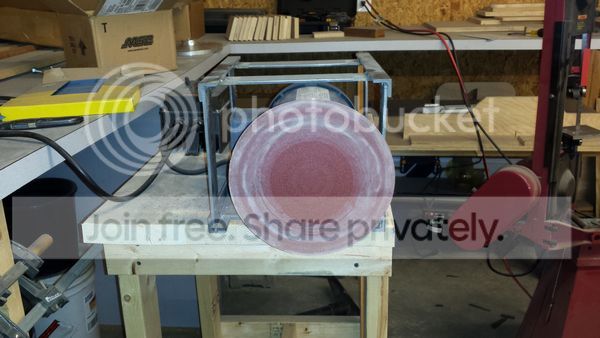

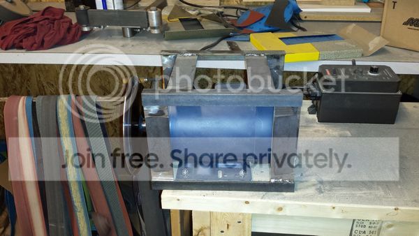

Thanks Barry. Can you post a pic or two of your disc sander set up? I was thinking of cannibalizing a trailer jack to use the locking swivel as a way to mount the motors that way with a little twist I could be in either vertical or horizontal mode.
Hey Marc here are a few pics of my disc sander set up. Don't laugh at my lack of welding skill.
Thanks Barry. Don't worry. You won't get any welding criticism from me. My welds are horrible. Your box design is simple and interesting. I typically over think things. I wasn't sure whether to build a table top set up or make a pedestal. After seeing your design I am leaning now towards a table top rig. My motors are 115v reversible Leesons. I would have loved variable speed but that would have been too expensive. So I chose 1750 rpm motors instead of 3450 rpm models. At least it will give me a bit more control. Are you using a flat or tapered disc?
That is a tapered disc from Nathan. I thought about using some type of hinge system to flip it horizental and vertical but it is heavy enough it really isn't needed. I haven't had it move much when using it to flatten a blade since I mostly use 220 paper on it. It has moved some when using 120 paper and I was pushing hard but I am over all happy with the way it turned out. Now I just need to learn to really use it to its potential.
