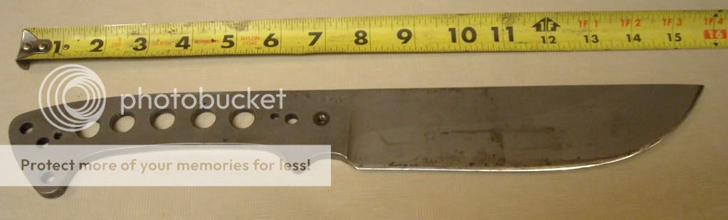

Here's a RC4 and a RAT 3 after stripping with paint stripper and sanding. It really isn't that much trouble to touch up the polish with 1000 grit sandpaper when you need to.

I stripped the coating off my Bill Siegle Cutlass, then re-painted it, and recently re-stripped it....

I found that you want to have the work/action happen at normal temperatures, not winter temperatures.... I have done one knife and 2 axes recently, and the first two I did in the garage at winter temperatures, and it was slow. The last piece I did, in the house, and the higher temperature helped.
When I did it, I spread it with the brush (don't use synthetic brushes, I am pretty sure the citri-strip will eat them, it did the foam brush we bought), getting it into all corners and crevices, both sides. Then I sat it there for 30 minutes, or until you remember it. Then I brushed it to loosen paint, then wiped clean. Repeat first step, then clean with solvent, and you should be good to go.
