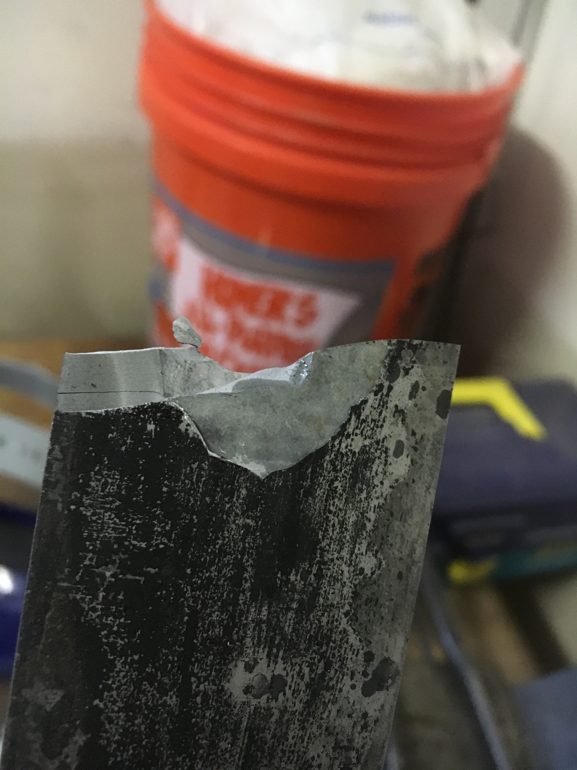

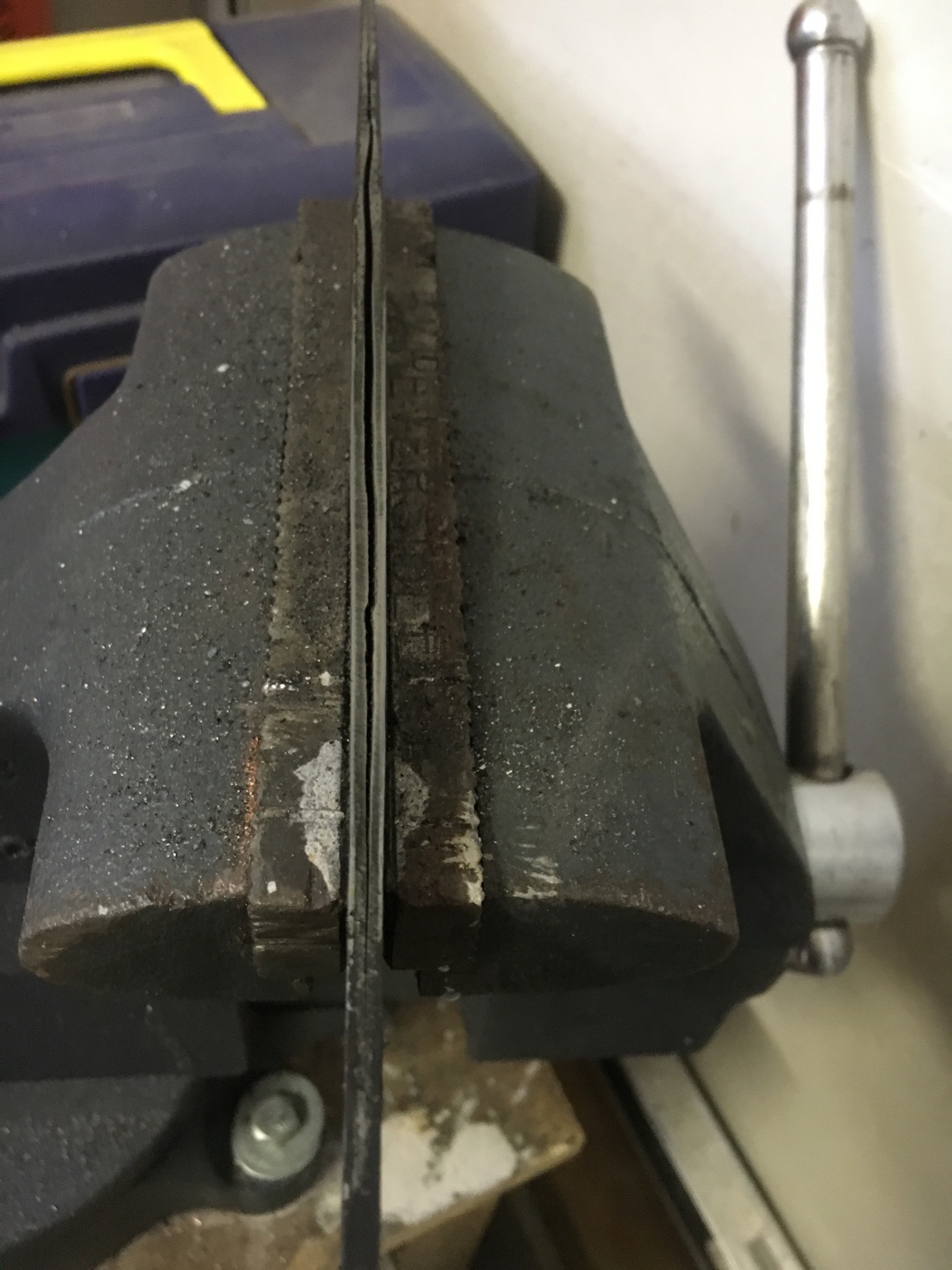

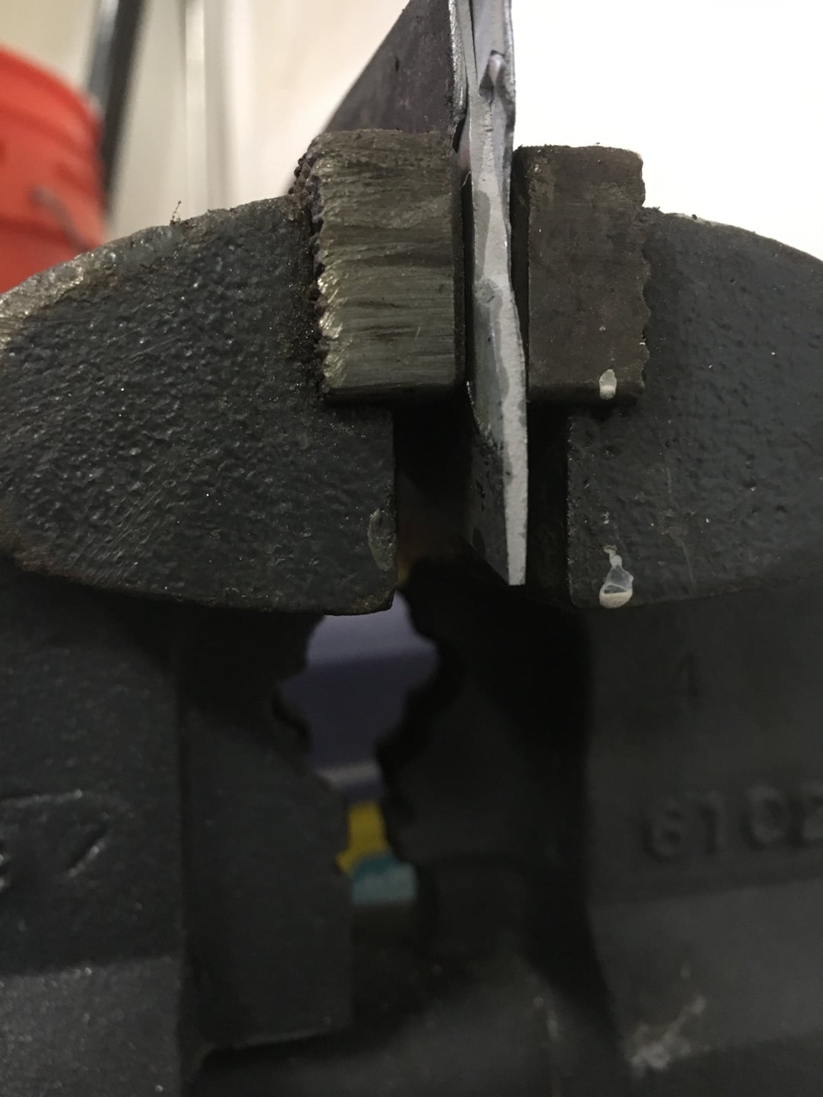

Hey guys I recently made some sanmai 1018/1084 and all of my welds were solid and has no delamination of any sort. I went to heat treat it, thermal cycled 4 times and then quenched in mcmastercarr super quench. The blade passed the file test with flying colors. However upon further inspection there was a crack in the middle of the core steel running the length of the blade...like it just wanted to spilt in 2. What cause this and what am I doing wrong? I know people make low carbon sanmai with a high carbon core all the time. I suspected that I may have over heated it so I took it to the vice and snapped it at the tip, the middle, and at the heel. All of the grain was silky like you would find if you snapped a file so overheating is out of the question. Thanks for the help guys!
Maybe your quench is too fast. You have two different steels and in the quench they will contract differently. You might try a slower quench. Also, you might have better results if you edge quench.
Hmm...I'm using McMaster care super quench which is slower than parks 50. I did preheat the oil like usual. Maybe quenching from room temperature will be better? If I used a slower quench I don't think I would achieve the full hardness of the 1084
I have done a lot of san mai with stainless and 0-1 steel, wire Damascus and 0-1 steel, wrought iron and 1084. I have used Brownells tough quench and have edge quenched the blades. I have heard of some having problems like you have when they do a full quench. I don't know how fast McMaster car super quench is. It might be OK.
I might be wrong but I think the McMaster Carr is just a rebranded version of the brownells. Do you full quench? I heard that tapering the core steel so that it is thinner towards the spine helps to what are your thoughts.
Hardened steels grow when quenched. As much as 1/8 of an inch. The mild steel cladding does not harden at the same temperature and does not grow after the quench. The Japanese cold forge before quenching to allow the cladding to expand to minimize the strain after quenching.
Tempering causes the core to shrink a little but not enough to over come the amount of growth. It is important to temper right away after quenching.
Recommendation: cold forge before quenching, temper immediately after quenching.

I have had san-mai split like that when I didn't normalize the blade fully before HT. also, too high an austenitization may cause problems. With a normalization and using lower HT temps the blades survive fine.
Thanks a lot for the help guys. I really appreciate it and will take all advice into consideration until I get it right [emoji2]
I just heat treated another blade and it came out fine this time. I coated the spine with clay and used room temperature oil. Thanks for the help!
