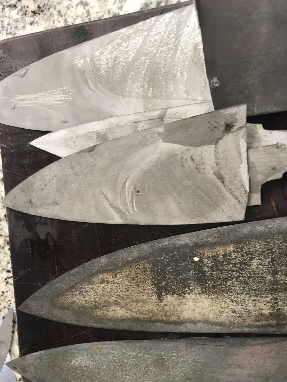

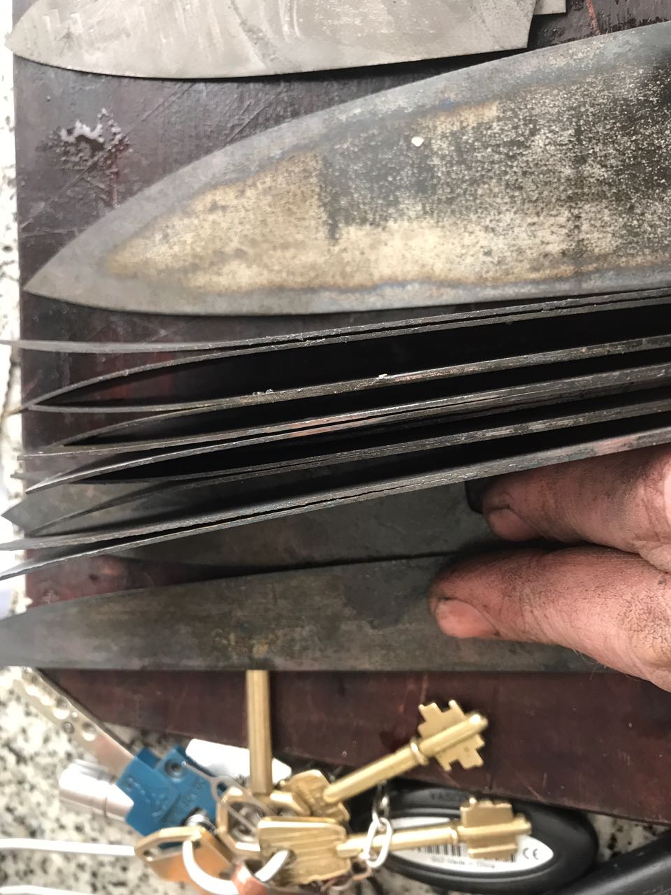

Hi guys, I'll share my pain, I still don't know what happened, maybe you can help me find what went wrong. This is a very thin takefu sanmai 1.5mm total (1/16") the core is VG10 and the sides non hardening stainless steel.
It does not appear to be delaminated, using a digital caliper, both sides of the split measure 0.75mm (1/32") so it appears the vg10 split in two.
I hardened at 1070C, in the middle of the suggested 1050-1100C range, blades were fine out of the oven, then went straight to dry ice in ethil alcohol. When the dry ice evaporated I put the blades in room temperature water, they were still fine. While waiting for the oven to go down to tempering temperatures I left the blades in the water (no snap temper, may be this was the problem?)
An hour later happened what I described above.
I'm puzzled, its not the first time I harden vg10 sanmai, but the first time I harden one this thin.
I splitted one of the blades to see the innards

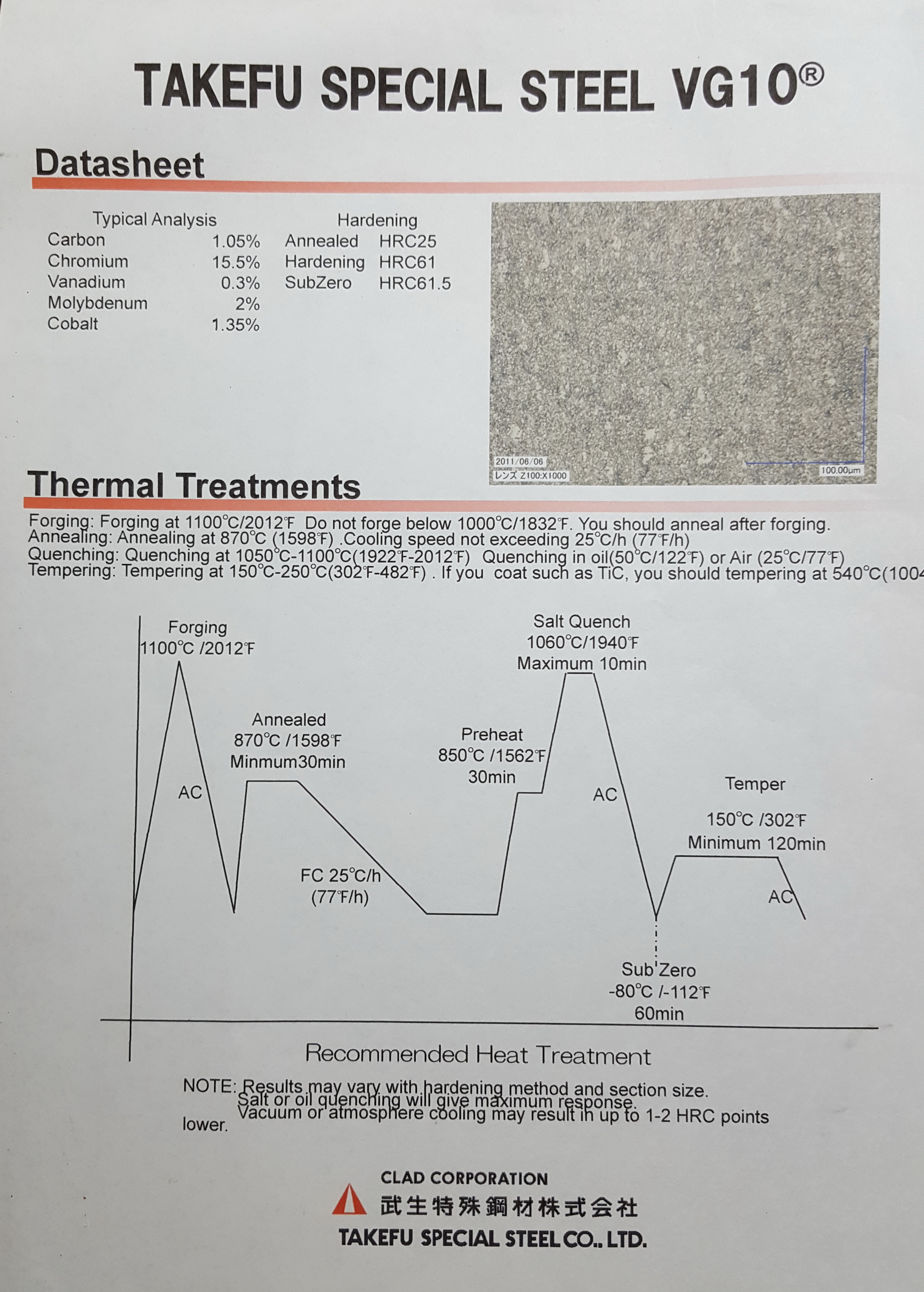

Thanks Mete, the datasheet specifies subzero, so the problem appears to be the delay in the temper...

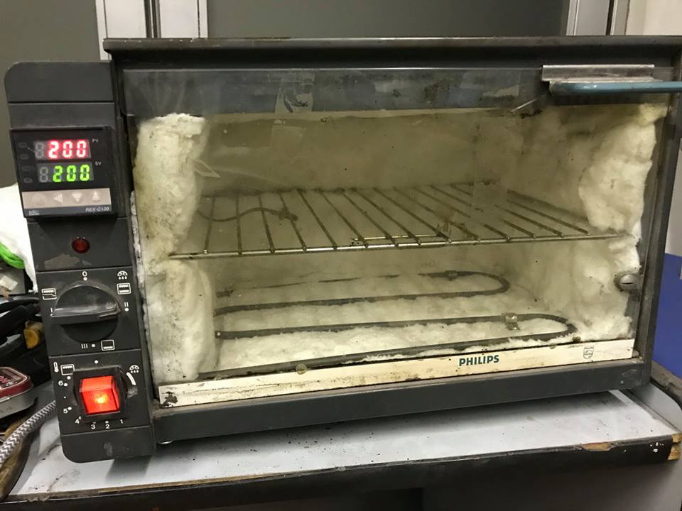

Modified this oven with a PID years ago, but it was awfull, it heated the room like a stove instead what was inside, so after my fail, I decided to try a solution that ended working very well, lined it with 1" thick ceramic blanket, works like a charm, it would work even better if I replace the glass door with something better, but, I prefer to spend time on other stuff :)

It looks like the martensite core wants to grow longer while the sides want to stay since they dont undergo martensite transformation. The only way to accomodate this movement is the core splitting in half and the two halves bending outward. The curvature each half shows has the martensite side longer than the not hardened side.
I don't think the total thickness of the blade might change this behaviour, of course minimizing both stress risers and delay before tempering helps.
