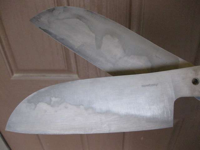

I am working on some santokus in 1095 and I am liking them so far. They are a lot of fun to do as with the wider blade you can play around a bit with the clay.

NICE. Say what you want about the benefits of a full-hard knife, but I do love hamons. So much beauty and a visible representation of our heat treatment. Looking forward to seeing those polished up!
--nathan
May I ask if they are forged or stock-removal? I tried a couple kitchen knives and flat grinding the 2.5" wide blade was a real pain for me. I don't know if forging would've made it more or less difficult.
Your blades look great, by the way!
Thanks guys. These are stock removal.

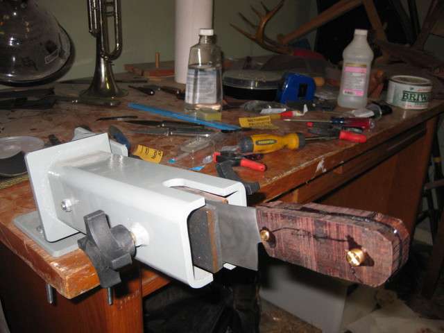

I did the glue up last night. Here is a shot of one of them in a sweet little vise that Chuck Ward made.
