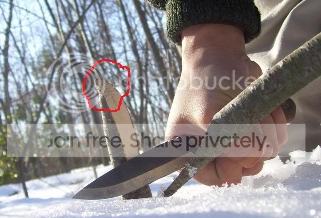

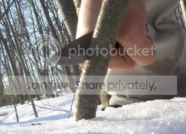

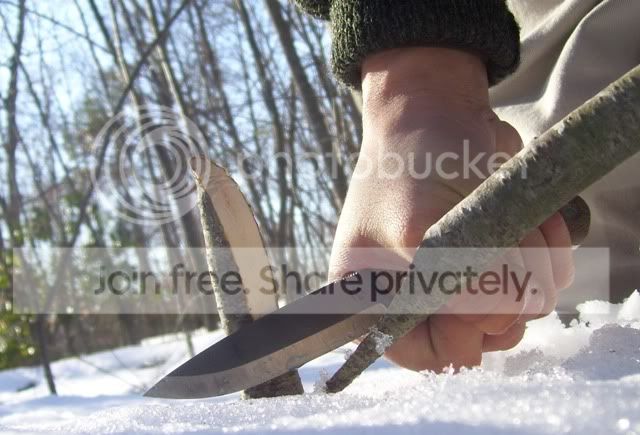

This has been shown before but it is a skill that can be brought up again. On a recent hike, I came across a large (I'm talking hundreds!) grouping of birch sapplings. One in particular was broken over from the top from ice and all that was left was a 4' stump. The tree would grow improperly or die and get in the way of others. I determined it to be a perfect opportunity to show off this skill.
If you guys and gals aren't aware, a small knife is able to cut through a decent sized sappling with ease. Like a rope under tension, the grain and fibers of wood can be weakend if they are stressed. While under stress, a knife is placed against the grain towards the base and rocked, much like a see-saw, through the wood until it is cut through.

It is safer in some respects but it doesn't replace battoning. This will cut through green wood grain and requires stressing it by bending. That can't be done with dry, seasoned and unbendable wood that is thick and is being cut with the grain and down through it.
Maybe I am just an inexperienced batoner but I have never found it particularly effective for taking down springy saplings. To my mind this is an excellent technique, but one that serves a pretty different purpose than batoning.
I'd be afraid of putting my eye out. I carry a Gerber's retractable pruning saw or SAK w/ saw blade for that sort of thing. Not that it's not a cool piece of knowledge I just see stressing and cutting as potentially hazardous.

G'day Kev
I can see where you see-sawed the blade to start the cut (circled) and it looks to have started to split as well once you cut through the outside of the sapling.
The additional benefit of doing it under controlled tension :thumbup:
