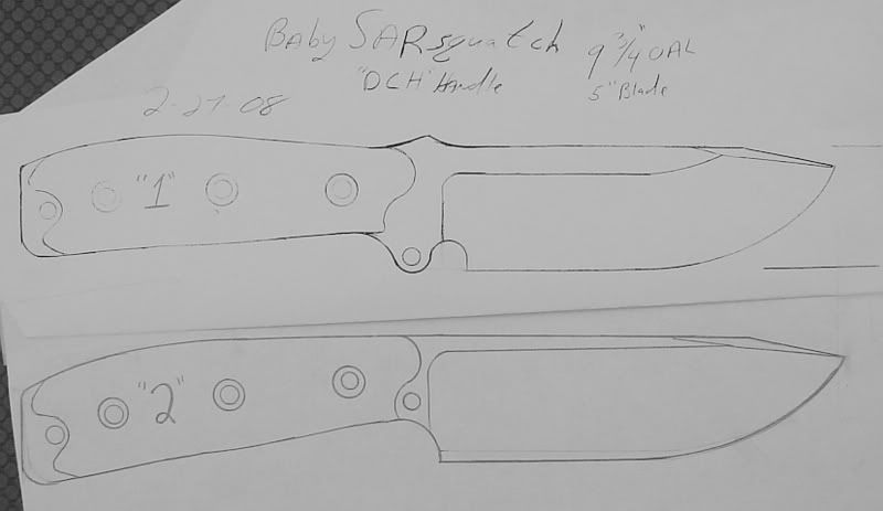

I like the SAR-5 myself, but out of the two of them I would have voted for "1" in the drawing.

If it's #1 I'll be all over it, if #2 I'll pass.
Did Jerry ever say which it would be?
I think Jerry implied it would be both! But personally, only number 2 interests me. The choil on number 1 is absolutely... well, insert ugly word of your choice here. What's the point of having a choil like that on a short blade?
the small choil (like on edcs) is just an aid for sharpening, isn't it? so you can sharpen the entire edge. i don't see the point of a large choil for your finger on a short blade anyway. hell, i don't even really like them on medium sized blades.
Yes, I suppose so, and possibly also "for looks." But the choil wastes the best part of the cutting edge right near the handle, where you can apply the most power and control. Since the knife can be sharpened perfectly well even if it doesn't have a choil to make it a bit easier, I think it would be wisest to leave the choil off. But that's me, anyway, and for small knives. For something as large as the NMSFNO, I actually like the choils and find them useful.
#1 has a straighter handle which would make it much better IMHO.
I would also rather have my index finger resting up against the finger guard/talon hole than being up against the blade like in #2. Thats the only reason I didn't get a SAR5.
The choil could be smaller, but I would rather it have a bigger choil than have no finger guard at all.

I love #1, although I would like to see the choil shrink just a little or preferably enlarged for a whole finger width.
#1 needs the square corner rounded off, you know, the one on the top side of the pommel, make it a radius like the bottom.

only because the square corner digs into my fat...
