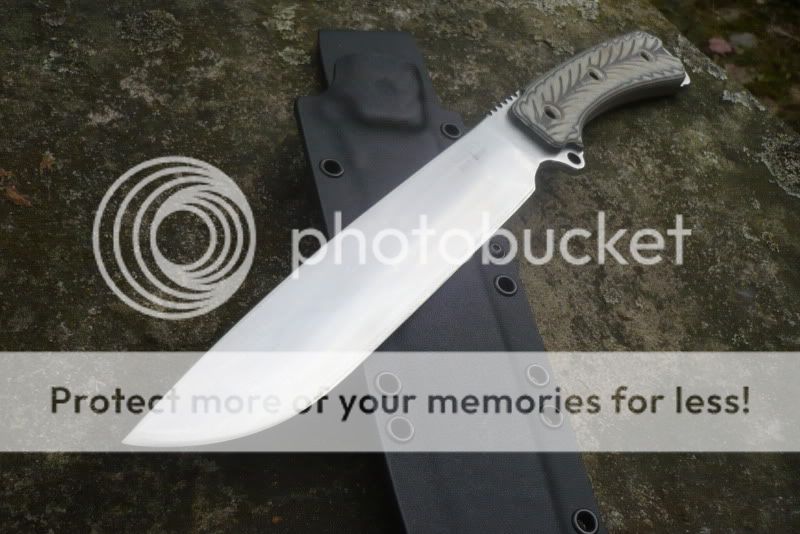

The SAR 8 is like many convex Busse's from the shop .... it has an edge profile for the people who may want to use the knife to chop through a breeze block or other extreme use ... I call this type of convex edge a "pear drop" shape .... I like my fully convex "zero" edges to be thinner in the shoulder or more "apple seed" shape ...
Here is a pic of the SAR 8 I put in another thread by EMT ...
If you angle the screen of your lap top right you should see the brighter polished area near the edge ... more visible on the belly curve ... this is where I have thinned the shoulder down. This radically improves the chopping ability. Hence my comment about a "zero" convex edge ... the early Busse's with the special "zero" prefix came with thinner fully convex edges.

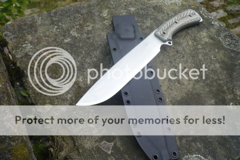

Here is another angle of the same knife ...
This shows how on the "flat" part of the edge I took the thinning from slightly higher than on the belly towards the tip ... giving this area a much sharper edge which bites deeper and the curved belly is sharper than the factory grind but is not too thin that if catching stones on the ground when chopping you run the risk of chips or "dinks". The edge I use will just "roll" if this happens and can easily be steeled back into alignment.

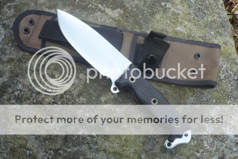

All my fully convex edges are done like this from my Zilla's to my stripped NMFBM and tweaked Skinny Ash and stripped NMSFNO.
Here is the Skinny Ash ...
Here is the NMSFNO ( bottom knife for the newer members )
