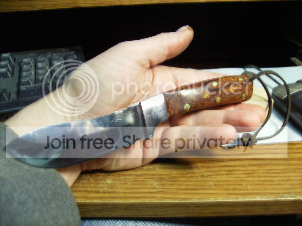

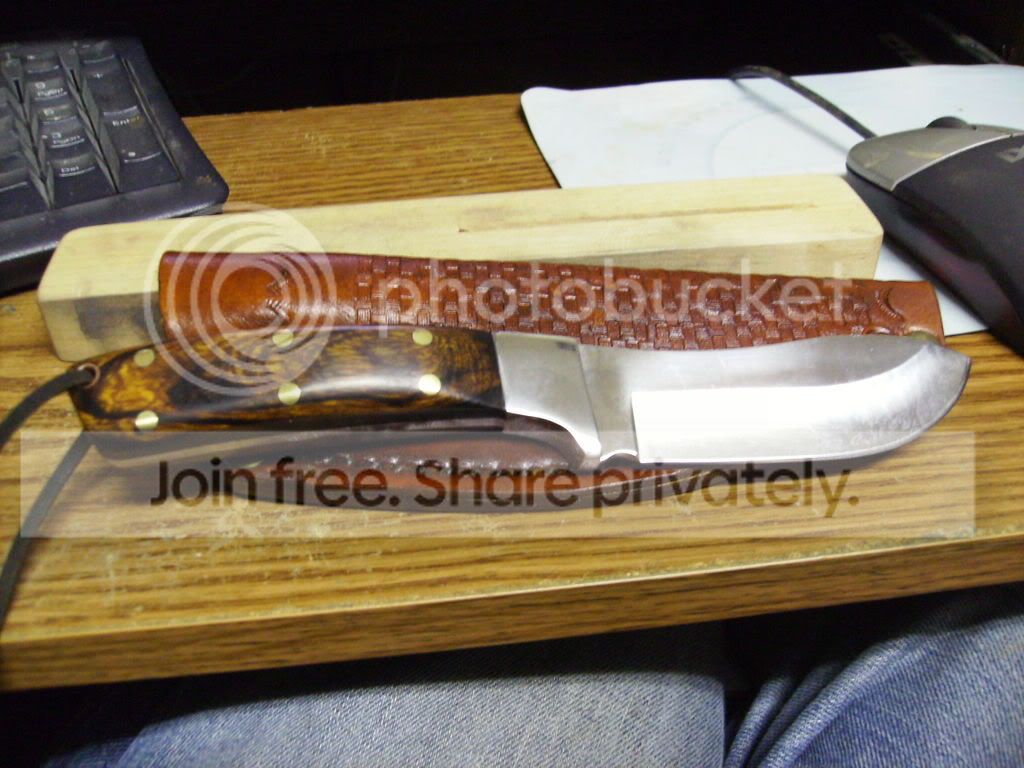

Went to town and did another I need a break im sicker than a dog with a cold and poked my finger 3 times in the same spot with a darning needle AND TWICE IN THE THUMB .Its very hard to type so ill just show the knife and sheath.
Damn Kelly, you're going all out! That's a lot of progress in a very short time, looking really good. I like this knife a lot.
I have 5 more blades to finish that i sent off for heat treat 2 more ready for heat treat and 7 slabs to grind into something i havent looked that far ahead oh ya and i bought 3 chunks of random damascus.
