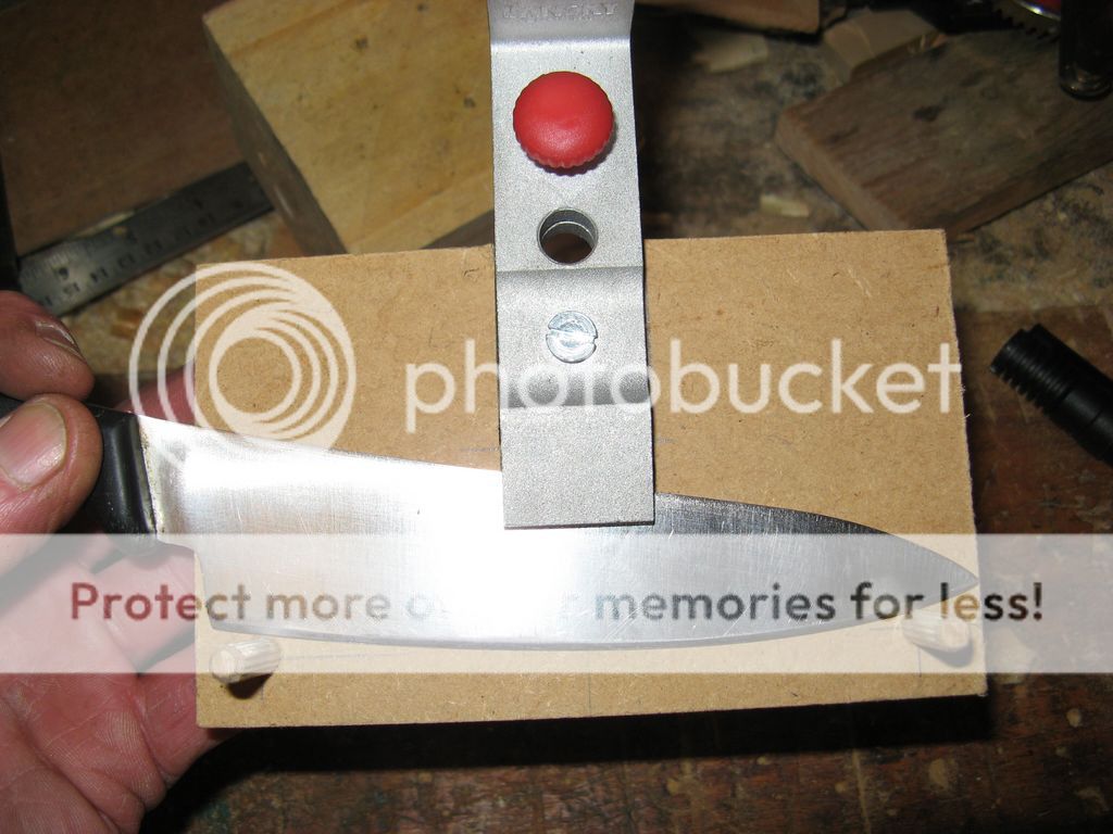

... Also, I find it hard to sharpen skinny knives(not thickness) like style knives because of the clamp being in the way. Any solutions?

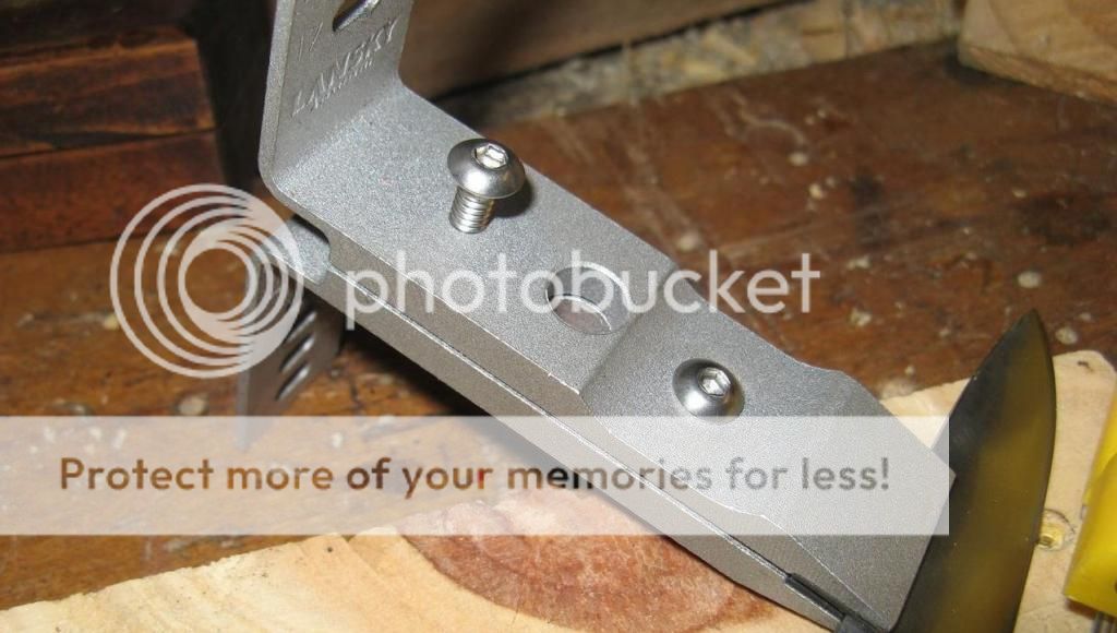

Hi, that was something I found with the Lansky. As I saw it the challenges are (1) how to make sure you always fit a particular knife in the clamp in the same position, so you're not adjusting the bevel every time you resharpen. (2) The supplied screws got in the way at low angles, and also limited travel on the hones (3) as you say, blades that are narrower than say 20mm spine to edge can't be sharpened except at very steep angles.
Some solutions I've come up with, firstly a fixture that allows me to fit the knife repeatably in the clamp, larger knives are fitted with the edge against the dowels, for smaller knives I've drawn outlines on the MDF. It's probably not clear in the picture but once tightened the Lansky clamp just lifts free of the MDF fixture and is used as normal.
The screws are easily replaced ..
Lastly and still at the prototype is an adapter to allow narrow blades to be sharpened. This is an early mock up but should give the idea. There's a magnet set in the MDF to hold the blade in place, and for the working version I've added a pin either side of the Lansky clamp to give consistent reference points for the spine. Again the trick is consistent placement of the blade, especially as in this case it needs to be continually removed and refitted the other way round.
Lastly I've reset the rods on the hones so that the coarser hones have the rods very slightly offset, making them cut at a shallower angle. This means as you move to a finer grit it starts to work on the apex first. What I was finding before is that because of various inaccuracies in the system, I might get what looks like a nice flat bevel say with the 600 grit, then moving to extra fine it was polishing up the bevel but the polished area not quite reaching the apex.
Not sure whether any of this is any help, but looking forward to hearing suggestions from others.
