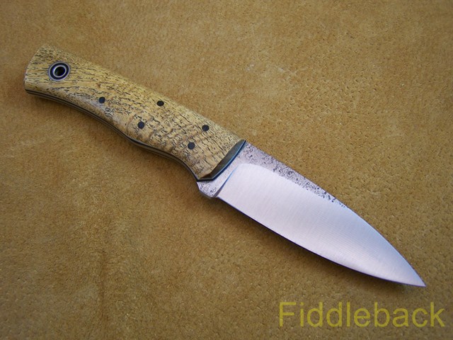

I acquired this little beauty on the flea market earlier in the week. It had been well cared for, but was also well used for the past two years. After she arrived today, I spent an hour or so giving it her very own little spa treatment and after all was said and done, I have to say that I am quite amazed -- even my wife (who is not a knife person) was quite impressed! The knife still might need her maker's mark refreshed (old style, almost not visible) but other than that, I couldn't be happier.
Spa included: handle scales, blade / tang, and resharpening -- total time was about 75 min; results: epic!
Kephart (circa 2012): 5/32" 01, tapered tang, curly black locust over black g10 with a white pinstripe.

Allen, the mark is from the pre-deep etch days, so it is electrochemically applied on the surface but simple abrasives could easily remove it. Currently the "AR" portion of the mark is not visible but everything else is pretty clear.
Try using a paint maker and go over the mark area. Let it dry and then use some hopps no9 and lightly removed the excess. Even with an original "mark", there still would be a small depression or etch from the process. Might work, might not. Could be worth a shot. I have done this color fill process a hundred times on firearms, granted the marks were deep.

Paint marker sadly didn't work; the etch is superficial and not deep enough for the paint to sink in, so when I'm ready to part with her, I'll send her to Cummings for a new mark ;)
