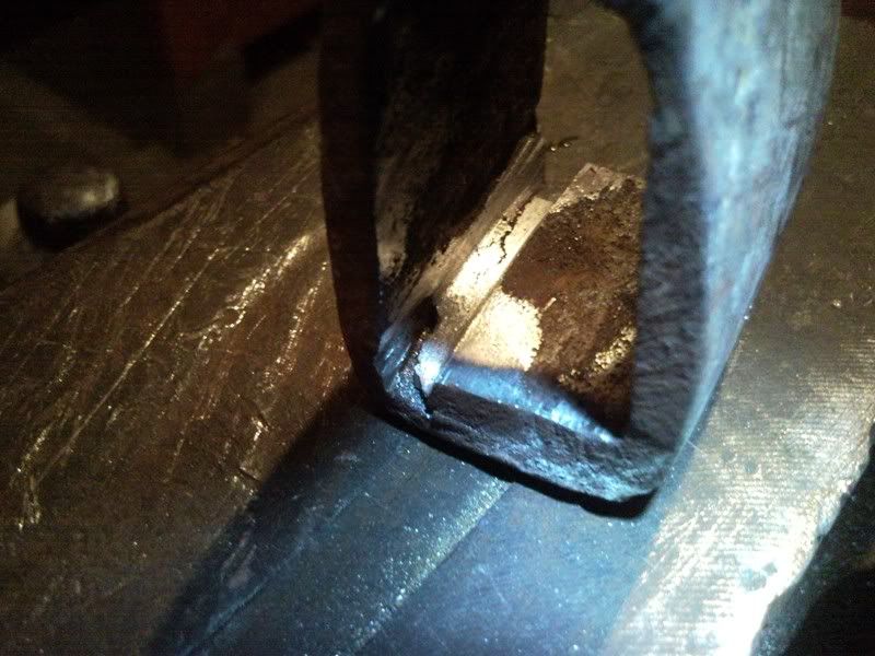

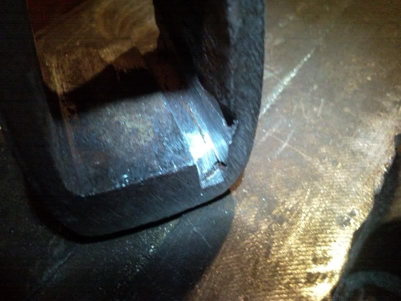

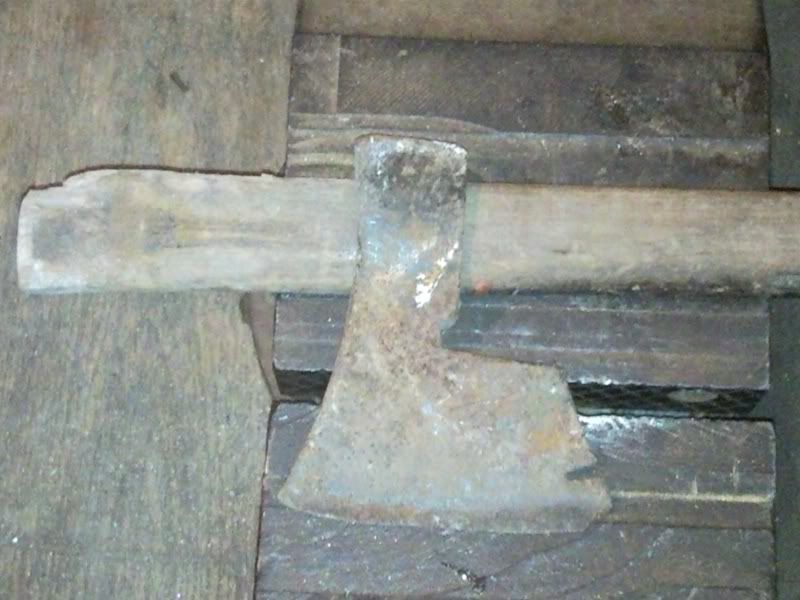

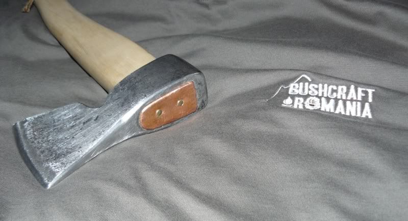

After this transformation (http://www.bladeforums.com/forums/showthread.php?t=789583) I start another abused tool rescue.
Initially it was a carpenter axe and in the end the result is a small camp axe.

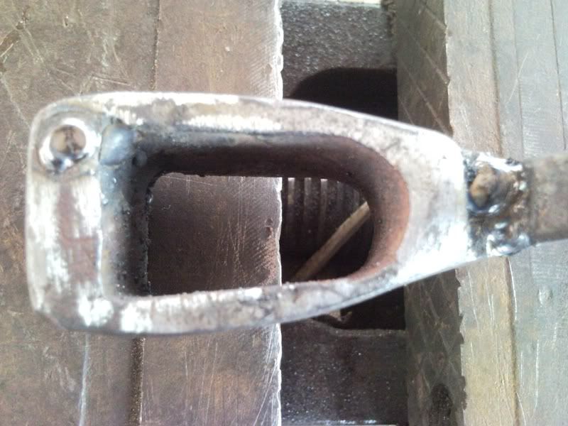

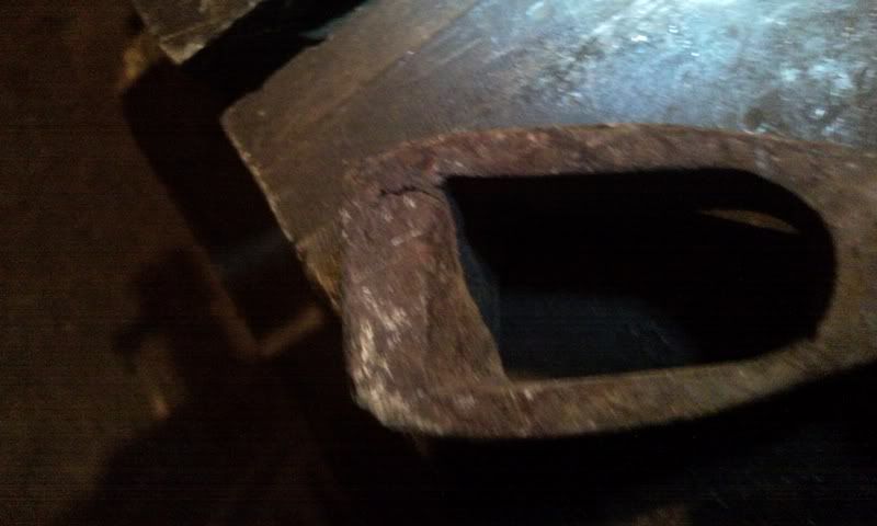

In the same time I put together some photos to see how to deal with cracks (somebody asked here about this problem some time ago).
I think the photos ar like 1000 words, so let see them.
Cracks

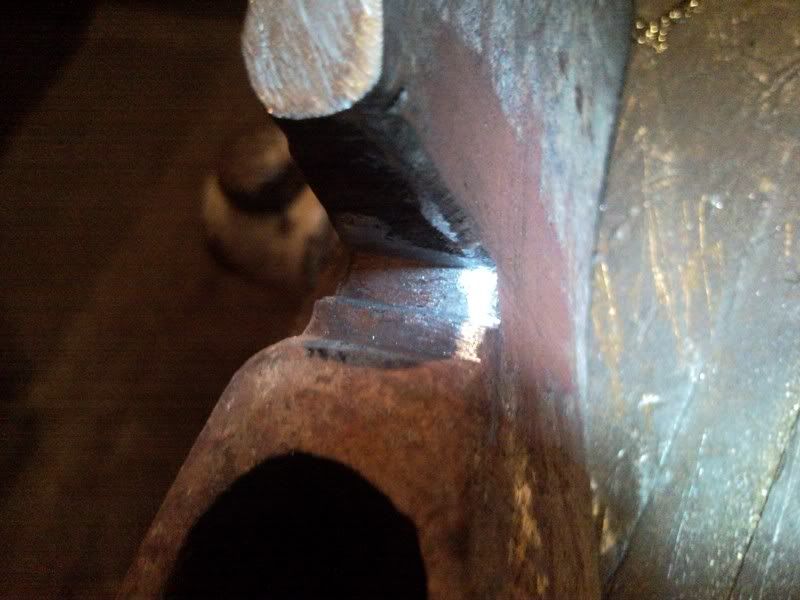

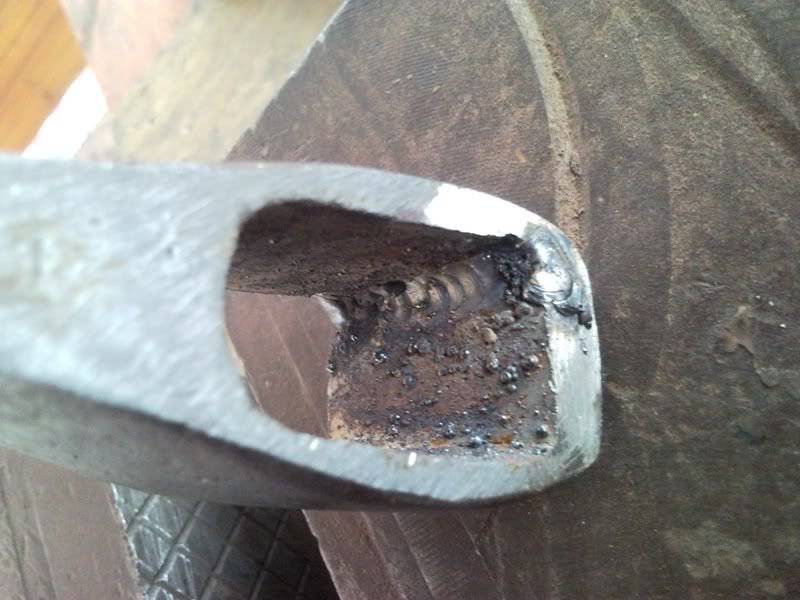

Cleaning the cracks
Electric welding

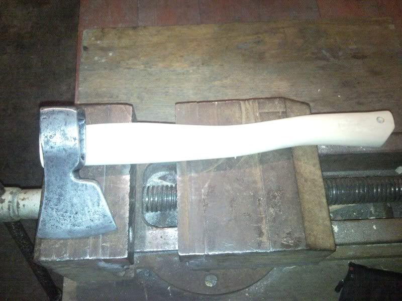

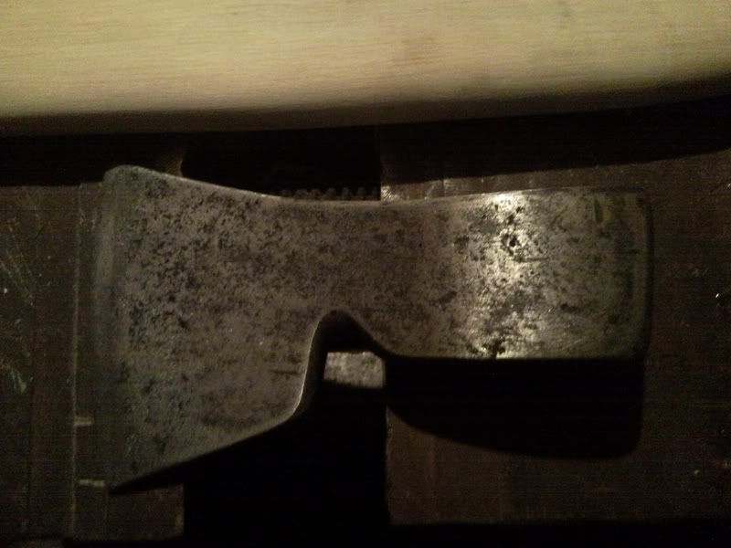

Some shape adjustments and heat treatement

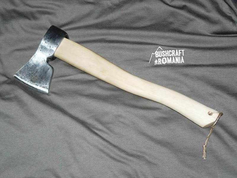

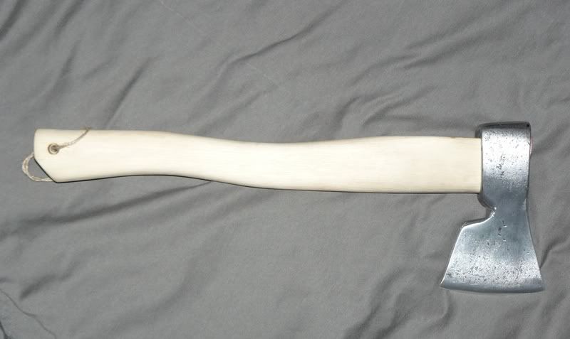

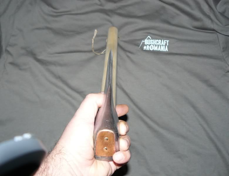

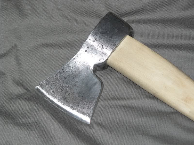

The finish axe (ash wood handle and a copper cap)
The handle need some minor adjustments (some engraving and a proper water protection).
I hope you like it.
How did you do the "heat abatement" portion of the welding?
Excellent user axe you have.
I noticed the fact that the original axe steel was brittle (I guess is spring steel hardened above normal) and, after annealing, I did a selectiv hardening (around 850 C degrees), I quench the activ part of the head (cuttind edge without welding portion) first and the rest after a few seconds.
The tempering process was done at 250 C degrees.
In this way I get a good cutting edge and a softer body, preventing future cracks in the welding areas.
