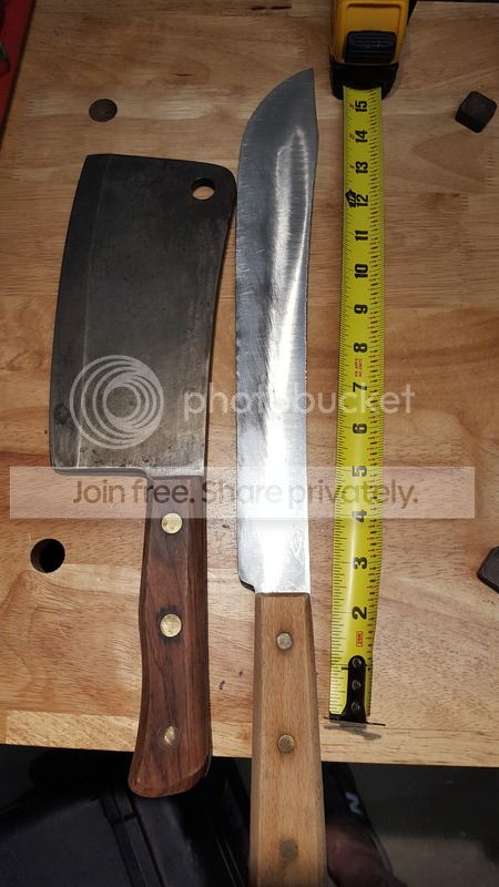

Got 2 antique blades that the scales are loose on kne end and pulling away from the tang. One is a 14" Clyde cutlery butcher and the other a 3 lb Lamson bone cleaver. I can clamp them down.
What are the odds I can get them to reattach or just punt, remove and remake?
Can get pics later. I have no use for that massive butcher but want to keep it to match the 14" cimeter I have.

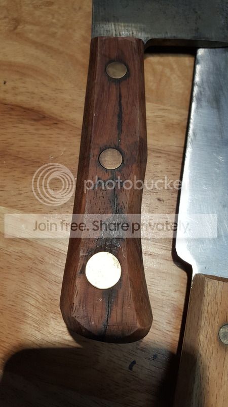

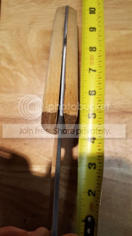

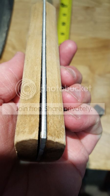

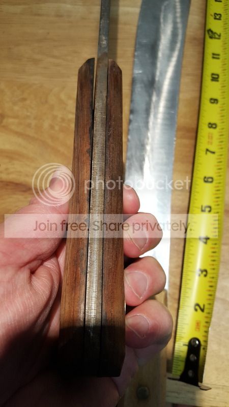

Some pics More I look at them I'm thinking re handling is called for.
Subjects..
Cracks and odd oversized rivet.
Coming loose in the front
If you are fixing them as wall hangers, just epoxy/CA and re-sand. If you want to use them, remove the handles and replace the wood using Corby bolts.
