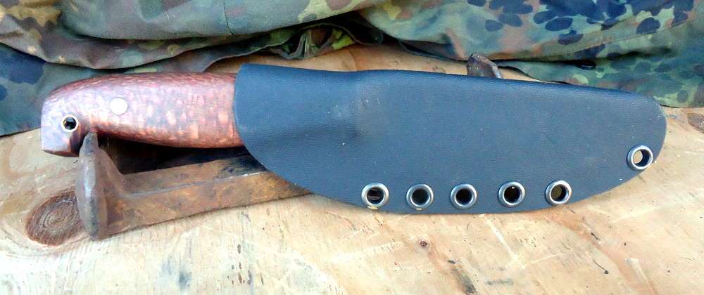

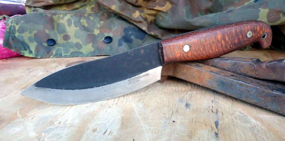

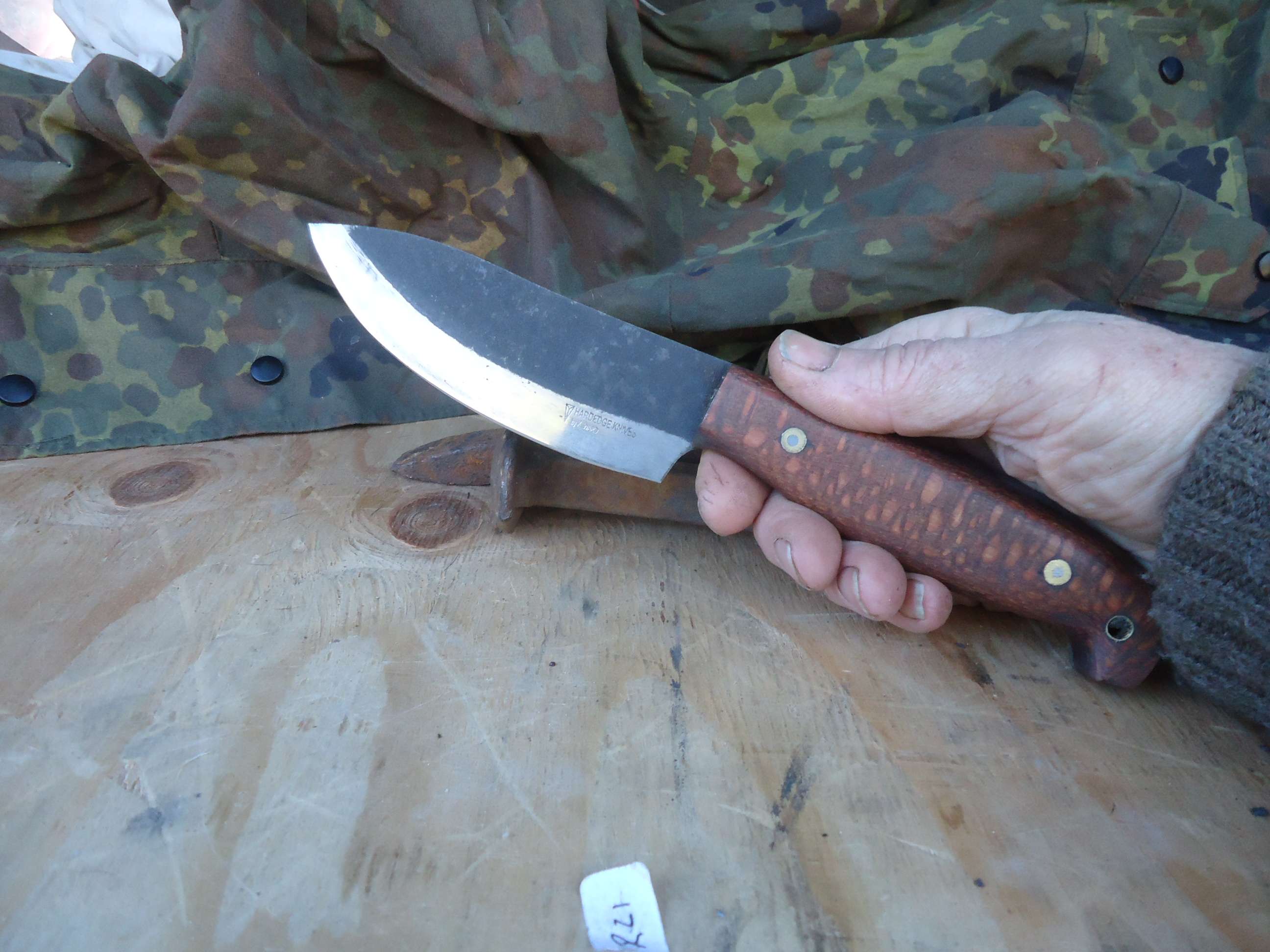

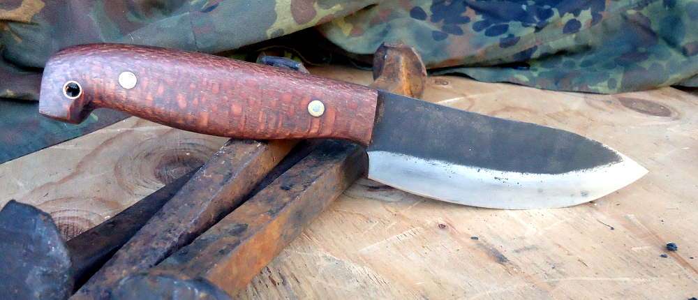

SPECS:
Steel: L6 or similar alloy recovered from a lumber mill band saw blade.
Blade Length: 4.75 inches from tip to wood scale, .1 inches thick , flat ground with dark flats.
Overall Length: 9.5 inches; differentially heat treated with an edge hardness of about 60 Rc
Handle: Macadamian Lacewood scales fastened to the knifes full tang with loveless bolts and epoxy.
Sheath: Black Kydex with grommets spaced for a large Tek Loc
"Hard Edge Knives" in grind
