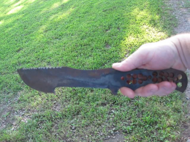

Hi all,
I am looking to put some sharp saw teeth on a knife I am making for myself. I was looking at my leather man wave that has a saw blade on it
and thought I might be able to cut some in like that with a file but when I tried it on a peace of steel it did not turn out the way I was hoping. I used a triangle type of file. Is there a certain file or files I should get to do this and how would I use them to get this done.
any thoughts and suggestions would be great.
I have a pic of the knife blank and where I would like to put the teeth at. I drew some marking with a felt tip black marker. It is a Tom Brown Tracker type of knife design.
Thanks

The blank is 3/16 thick. Correct on the saws you mentioned. I would like to just make some saw teeth like the Knife that Dave Beck made for survival instructor Tom Browns knife.
I I have seen some other makers make a knife with saw teeth on theres. I think one fellows name was Roger and I can"t think of his last name.
That guy made a version of Dave Becks knife. That probably does not help ya lol.
As to really cutting any wood. Yes I just want it to be able to cut some for being able to make notches for traps and such.
Here is the deal I started on another knife like this last week Here is the pic of it.
I took a file that is triangle in shape and was looking at me leatherman wave saw. I placed the file in the teeth of the saw blade and thought it sure looks like I could file that type of saw teeth arrangment in my first knife blank. It turned out ok but not really the way I was hoping.
After I heat treated and tempered it I took the knife and sawed on a 1" plywood peice and it cut right into it just fine better than I thought I would.
I was like holy crap I can not believe how well it cut into the wood. I think if ithe teeth were more even and sharper that it would make it even a better cutter.

For cutting fairly shallow (1/4" or so) notches, like you would want for making traps or helping to lash together shelter poles, the USAF pilot's knife "teeth" work really well.
I've laid out filework and jimping with a thread-cleaning file, just to get evenly spaced marks to work from. You can also use a "blind" (smooth) round or triangle piece, same size as the actual file, taped tight to it. Make the first cut with the file, lay the blind guide in the first cut and continue so forth to make the next cut. That will keep things even too.
You can get "knife edge" files with a much more acute angle than the typical triangle files, I bet those would make narrower sharper teeth.
Or if you plan to do a bunch you could have a waterjet service cut the basic teeth pattern.

I have cut real saw teeth with a Dremel and a separating disk. It's a lot of work.
Find someone who sharpens saws, and have him use his equipment to cut the teeth.
Ive been thinking of making a survival spear tip with a saw tooth side for my hunting kit. I was thinking of using my lil milling machine and a dovetail cutter for the teeth. With the digital readout should make short work of it.
I have cut saw teeth on two knives using needle files. If you google how to hand make a saw there are tutorials on how to cut teeth in different patterns.

These saw teeth can be cut using a triangle file. Look closely at the design used on the Swiss Army knives to develope the pattern. This is what I went by when I designed the saw teeth for the Tracker knives. When these knives were produced on a regular basis, the teeth were cut using a vertical milling machine with a right angle milling attachment & a "V" cutter. This is a quick & easy method if you've got a mill in your shop but the the cutter will still leave quite a burr which still requires truing with a triangle file. Today, I have gone back to cutting my saw teeth using files because I no longer have a milling machine in my shop. You can do a very nice job if you take the time but for anyoneone who has tried this you'll understand why I now only make a very limited number of these knives per year. I can't afford the bandaids.
