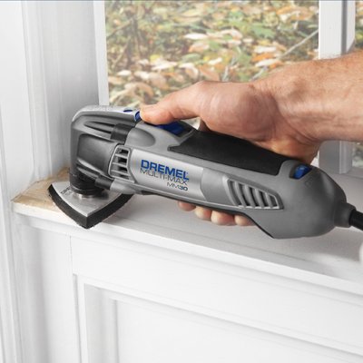

I never thought to try my Dremel Oscillating Tool on blade . I use it for wood on handle but never try to sand blade ? Anybody try this ?
