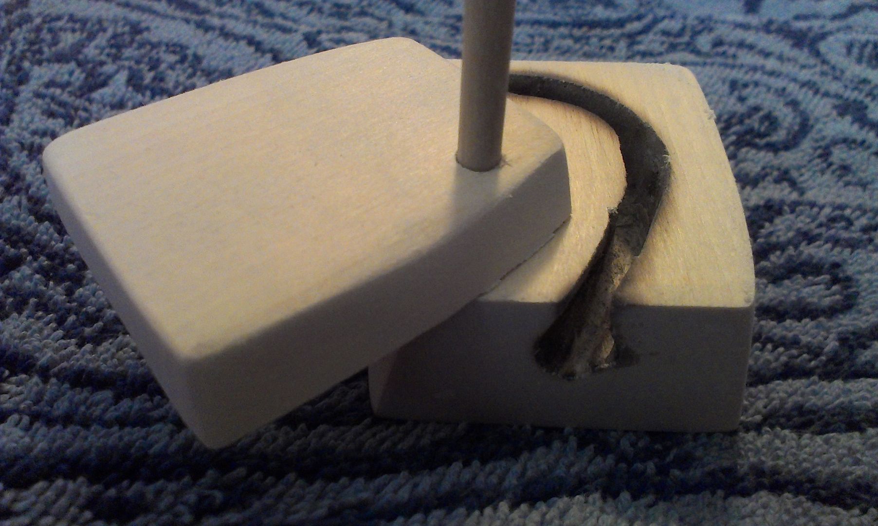

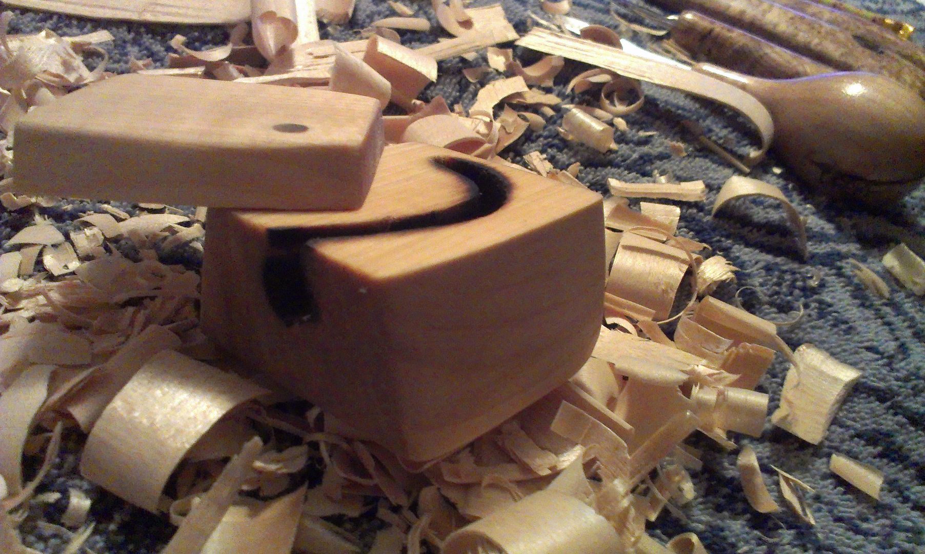

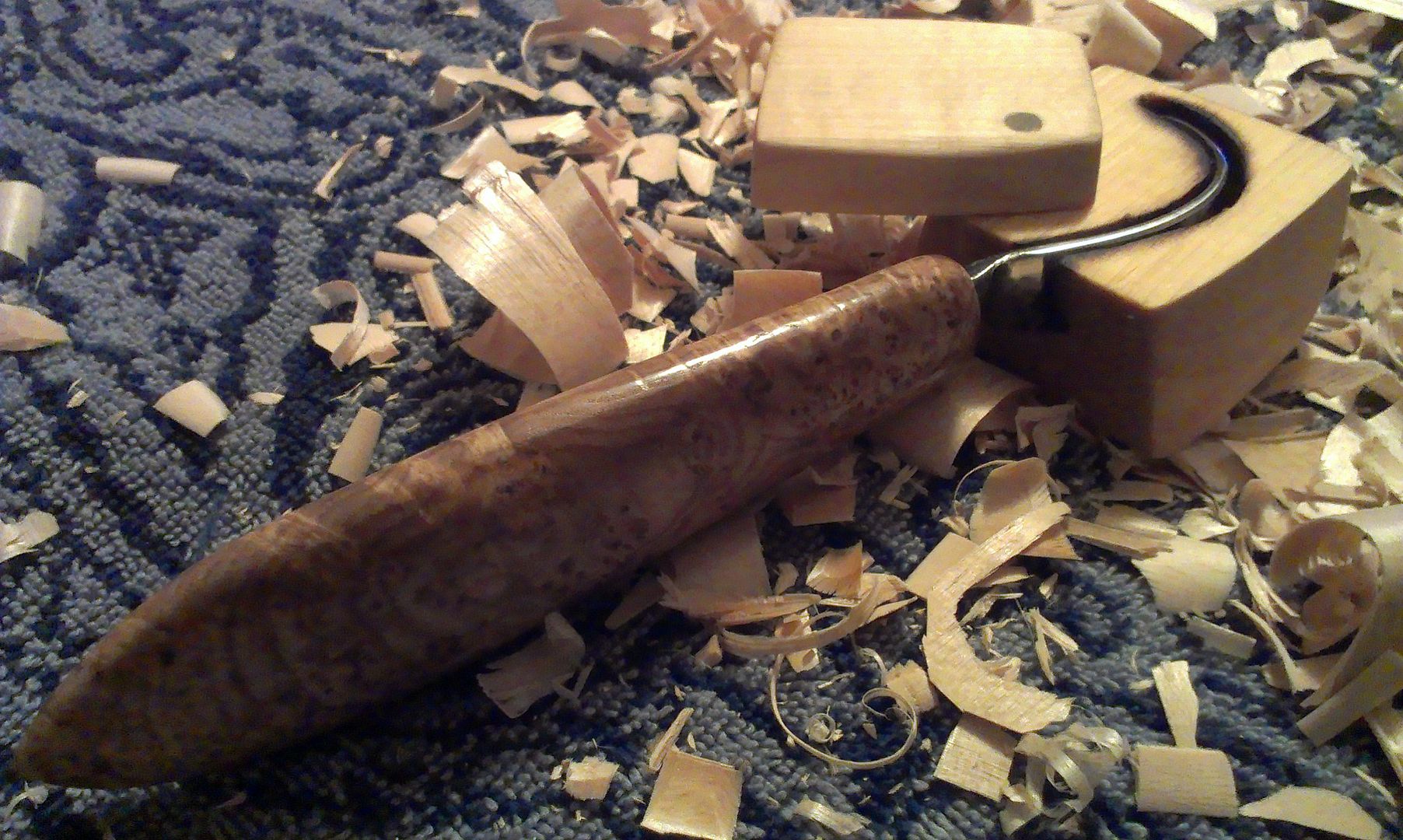

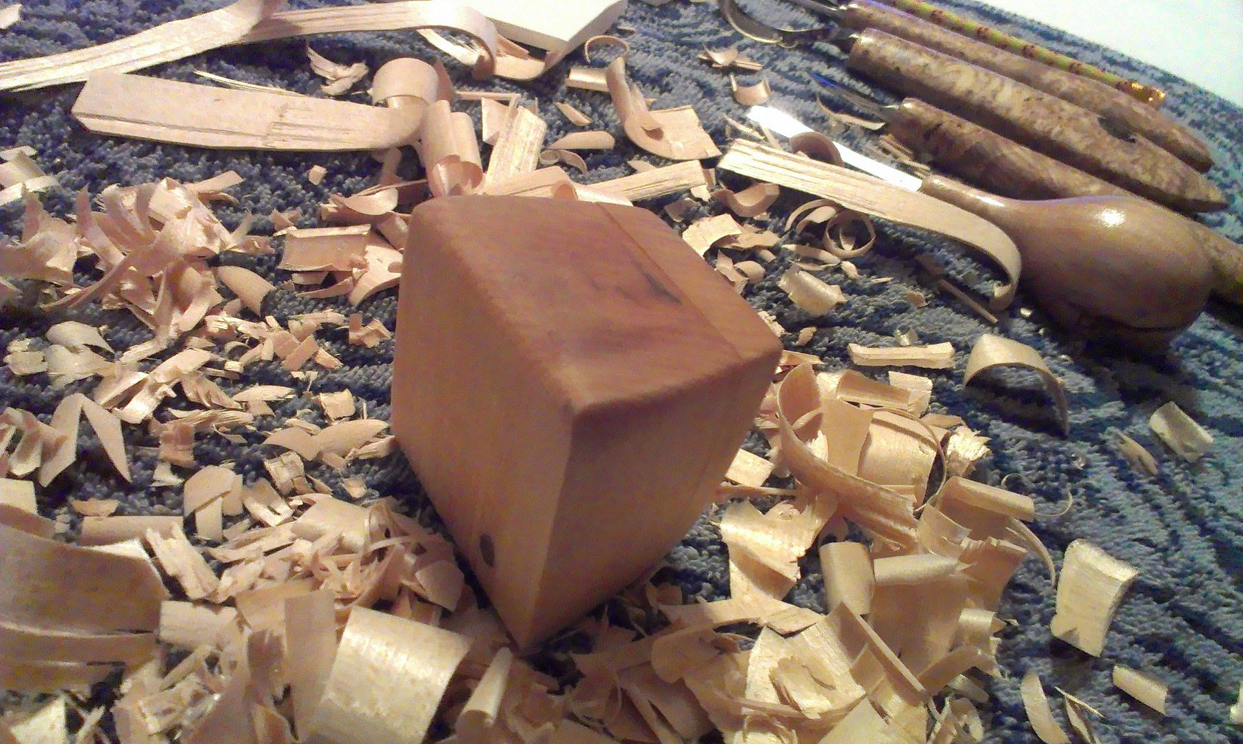

A little swing top box I made for my hook knife. Burned with a steel skewer bent to shape. Poplar pin.
Strig - That's a pretty darn cool idea! I'm gonna' steal it..... don't care what you say.:D
