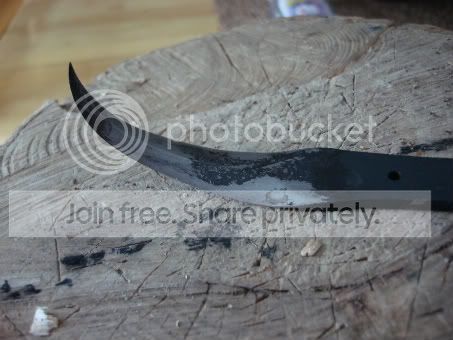

I just quenched a 1084 hook knife using an electric kiln for heating. I took it to non-magnetic... pyrometer read 1500 and quenched in 130F canola oil. This is the first time I've used either the kiln or vegetable oil for quenching and there seemed to be less scale and whatever there was comes off real easy. It just seems like there is something wrong for some reason... I'm still pretty new at this, but my other blades using woodfire and transmission oil there was a lot more scale and it was hard to get off. I've heard that using electric kilns produce MORE scale. But it seems like the hardening went well based on taking a file to the edge....Any thoughts?
Your blade looks fine, well except it's bent :)
If the scale stays on and is hard to remove after quench, it probably didn't harden.
Some scale will pop off in the quench when the blade is hot enough to harden.
I've found that the scale on 1084 doesn't come off by itself when an oven is used for the HT. It looks like a sleek black coating, it's very protective though it does scratch under hard use.
That is what I was expecting (a sleek black coating) which is why I asked the question. hmmm.... I dunno. Are they supposed to bend like that? :)

In my experience, if you have heavy scale after HT of simple carbon steels, you probably go too hot. The austenization temperatures of simple carbon steels are a bit below where scale begins to aggressively form. From the photo it looks like everything went just fine.

That blade looks fine to me just visually. Most of my scale pops right off in the quench for 1084. Some of it I have to wipe away after it's out of the quench.
And boring quenches are a GOOD thing. I never once had a big flare-up with canola oil or the formulated oils I use now. But I do a full quench on almost everything now. When I first started and edge quenched some O1, I did have very small flames at the surface right at the blade, but they went out quickly. Canola isn't all that flash sensitive when it's in bulk liquid form.
