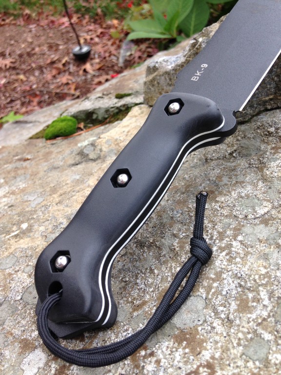

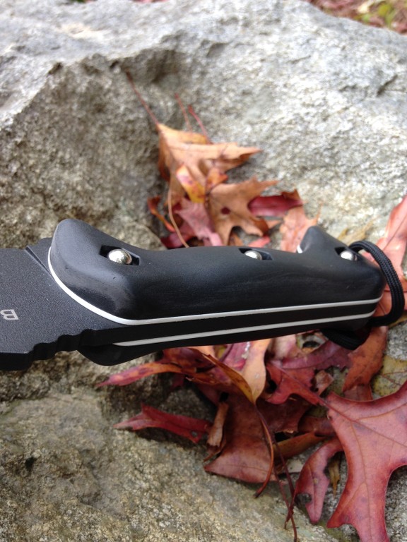

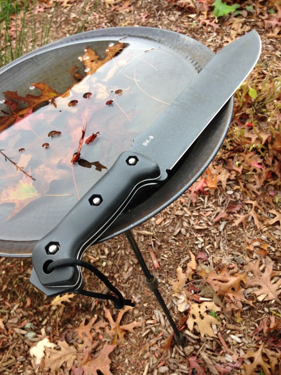

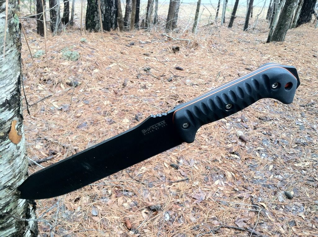

I made my spacers from a DVD case: "Host your Mexican Party!"
I traced around the handle and cut with scissors. Then I bolted just the handle scales and spacers together and used a file to bring it to shape. Then some sandpaper to smooth everything out. Bolt scales and liners onto the blade.

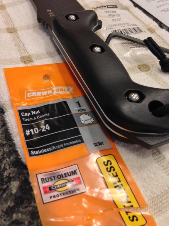

As for the bolts: The stock hardware still fit with the spacers - the top of the nut and the bottom of the bolt came flush. However, when I switched to stainless bolts, I saw these Dome Cap nuts. I got the next longer bolt and then capped 'em!
I really like the way it fills my hand now. Cheap, good looking, functional.
One last thing - my factory sheath did not accommodate the new fatter handle. I had a shoe repairman resize so I can snap her into place.

Man that is now one sweet looking blade. Well done come out brilliantly, thanks for showing us. Gonna have to try it.

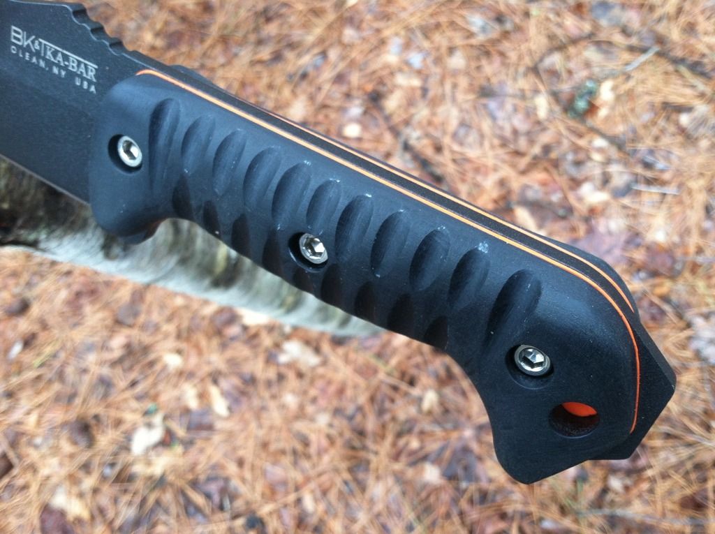

This is the tide pod container liners...
These days I pretty much only use Rubbermaid utensil drawer organizers from the thrift store. For .25-.50cents each you can make several sets and they're abundant in many colors. My favorite are avacado green and that dirty dark yellow. Still searching for that burnt orange lol
I use the cap nuts too...home depot has shorter ones, Lowes are taller and stick up too much.

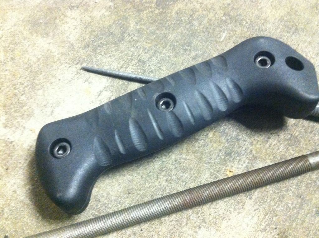

NCSlice,
That's some superb craftsmanship on the handles and those spacers look fine. Very nice. That 9 sure looks like it was customized like no other I've seen.
I find that type of plastic turns white where you slice it. That's why I use something more flexible like Rubbermaid stuff
NCSlice,
Thanks! I just used small round files to make those marks. I went for a fang effect that didnt really turn out
