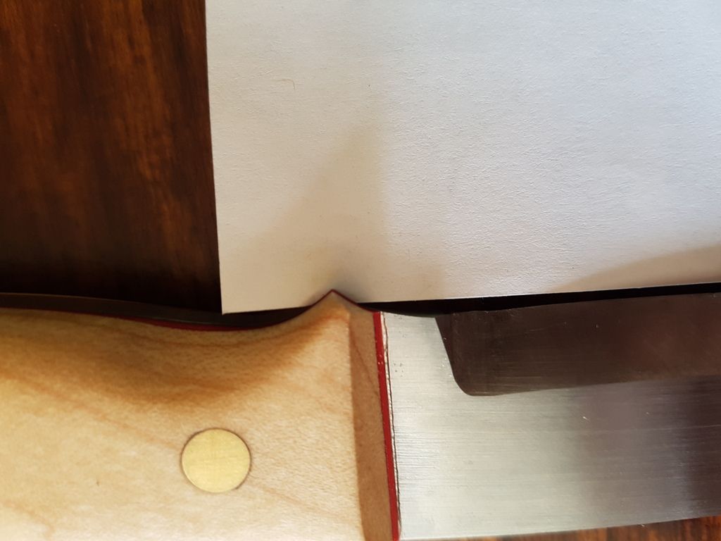

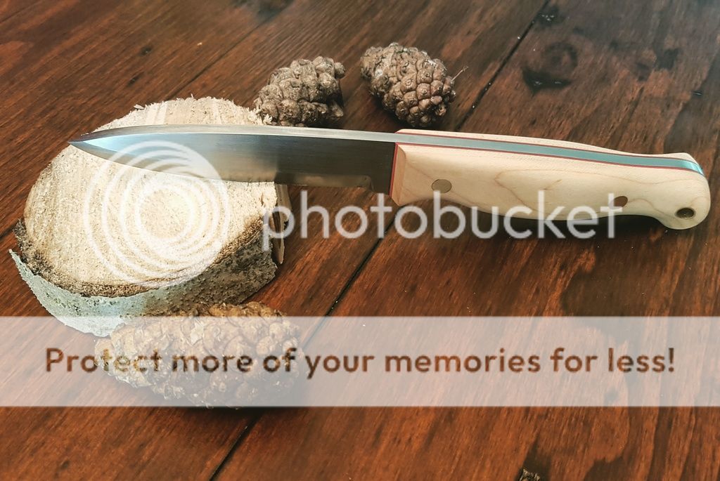

This is my 3rd knife I have made. It's the first with a full metal tang. So it's my first crack at doing scales.
This knife is just a beater knife, it's a proof of concept. I am going to use it a lot and see if and how it fails.
Here is the knife
And here is my problem.
The scales have pulled away at the points.
I sanded the mating surfaces with 60 grit
Cleaned the metal with varsol
Glued with gorilla glue epoxy
Long story short, I was cleaning off my work bench of greasy tools. I used varsol to clean the tools.
A few days later when I was putting the scales on, I had everything laid out ready to glue and I grabbed the varsol to give the blank one last cleaning. I had the acetone out and sitting there, but in my excitement I subcontiously grabbed the wrong one. Didn't think of my mistake until after it was all together.
Would the varsol prevent a good adhesion and cause this problem?
My main concern is water getting in. Can I just use crazy glue to fill the the tiny gap?
I can't imagine it would have slid back with pins in there. I could be wrong but it looks more to me like some squeeze out that didn't get cleaned off
You are correct. I'm not worried about the squeeze out. It's the piece of paper that I slid between the wood and the blade
Varsol is mineral spirits? Not a good prep cleaner for glue up. Will leave a residue like acetone. Alcohol is the best bet for cleaning prior to glue up. The epoxy was a 5 or 15 minute type? Those are also not great, most of us use a 24 hour structural epoxy. How flat were the scales and liners before glue up? How flat was the tang? Is it possible there was a gap there from the start and you just didn't get it filled with epoxy?
As for filling with CA glue to prevent water intrusion, that should work fine.

So this is the exact information I was looking for. I used 5 min epoxy. I cannot find a source for anything else in canada. I can order some good stuff from the states. But the cost would be hundreds of dollars. I produce a couple knives a year.

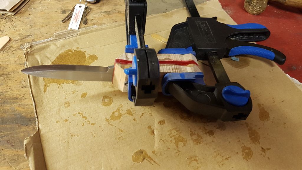

How hard did you clamp the scales down?
You may have clamped too tight and squeezed the epoxy out.
How hard should the clamps be? I used this style.
Hard to say how much force they produce.
Probably too much.
Should I use a spring style clamp instead? This is my first knife with scales and it may seem like an easy thing to do, but for a first timer their are a lot of things that can go wrong.
Yeah, spring clamps are best for this. I've used the standard style on nearly all my knives without any trouble. The key to good glue up is #1 flat surfaces #2 clean surfaces #3 good adhesive and don't squeeze it all out. Past that, the handle material can pull and move with humidity changes but if you've got 1, 2 and 3 right, it can make up for a lot of other variables.

Clamp scales as lightly as possible. The clamps you used are far too strong, and squeezed all the glue out of the joint.
