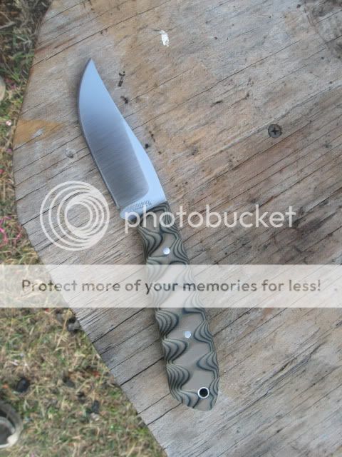

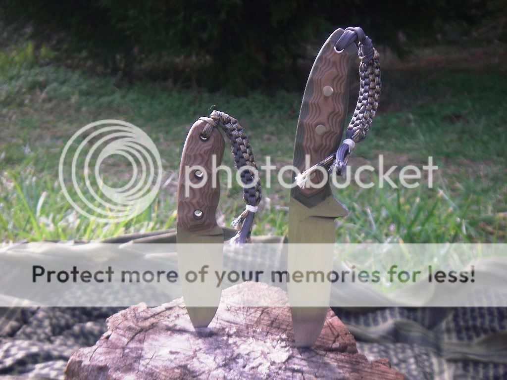

Kentucky, are you taking about texturing the scales similar to this:
These 2 were done with a 1 1/2" small wheel and 180 grit belt. I grind/file the pins flat to the scales and the scales even with the tang like doing a normal knife handle. I then round over the corners of the scales with the 1 1/2" wheel and a 100 grit belt, getting close to final handle shape, but oversized. Then I switch to a 180 grit belt and cut the scallops in. For G10, I leave the scallops at 180 grit but take the handle radius at the tang to 400 grit. I've never done it this way with micarta. I hope this helps. I've got one to finish this way tonight and I can add pics if I remember to take my camera home.

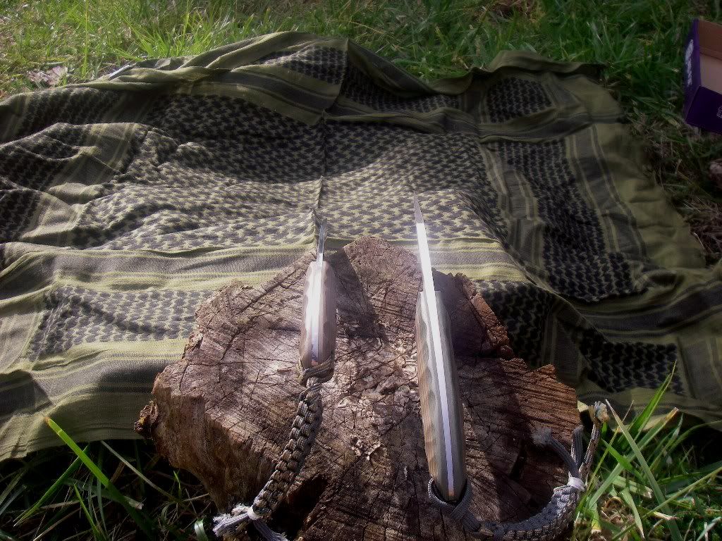

I don't want to highjack Kentucky's thread, but here is a spine shot of these two. I think the overall thickness of the smaller one is just over 5/8" and the larger one is about 3/4" thick.

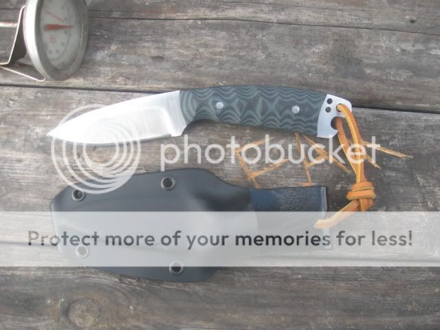

I use a 320 grit belt, then finish with the blue fine scotch brite belt. The wheel is a 3/4"
That would look really good on that black and blue 2x2 g-10.
