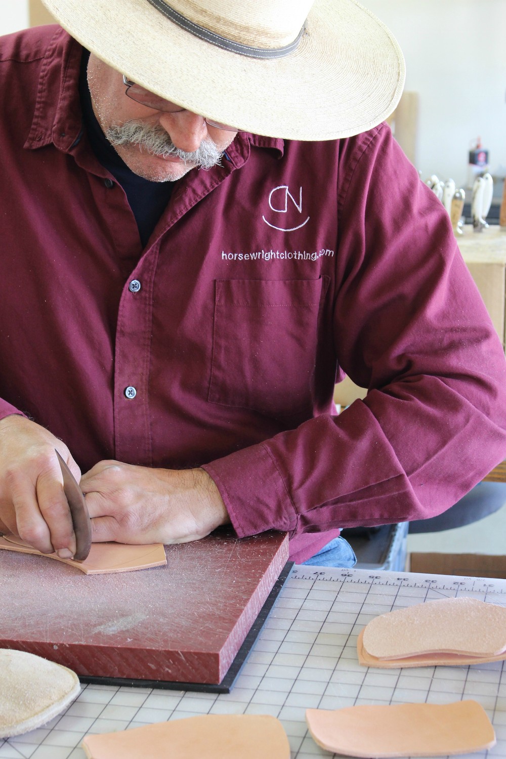

I do some leatherwork. Why not get the knife and learn to use it, that leather workers use? Its called a roundknife or a headknife sometimes. They've been around for centuries and used in that trade because they work. Tight curves, inside or out, large curves inside or out, straight lines it will cut them all and work on light leather to the heaviest saddle leather. I also do almost all my skivving with one. It is literally the only tool on the bench that is never put away. I use mine daily and I probably put it on a stone every 3 or 4 months. Strop a good one often or a quick pass on the buffer (what I do) as soon as it starts to drag and literally I can cut for hours a day, day after day, week after week well ya get the idea. Cheap ones suck, good ones will cut and cut and cut.
These are a couple of mine:
10-12 oz saddle leather, cut with one pass and the knife is stuck in the hydroma cutting board its that sharp.

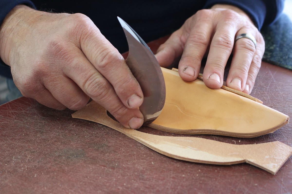

To cut tight curves flip it over and use the long point that is up in this photo, trimming a sheath:

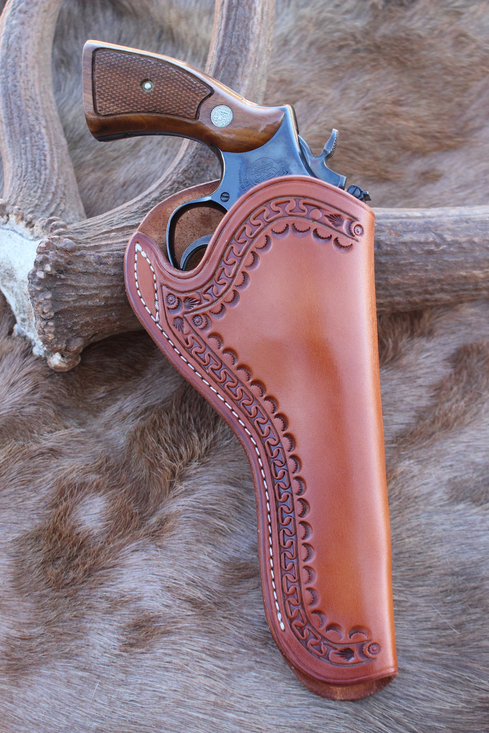

About the tightest curves I cut in actual use are like the throat and trigger guard area of this holster:
