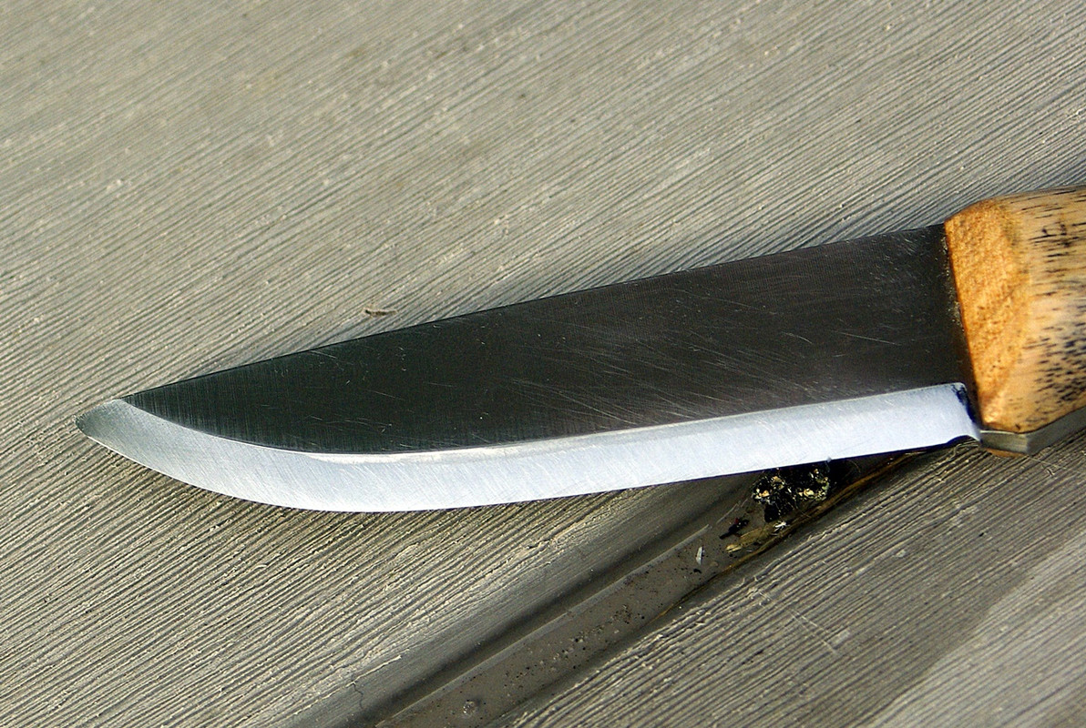

Time for my Mora Robust to step up to the plate !
Sharpening = VIA guided system ..
First I create the bevel I want ( creates a bur both ways )
Then I 320 grit the edge :
I have already posted a video on how I am sharpening ..
Doing dual grit in the video , but the method/process is the same whether it is DG / CG / or Scandi .
So ............................... I stopped at 650 slices with the Carbon Robust because clearly the edge had worn ! Clearly where the edge is biting into the wood as I slice rope . ( High wear area )
But I think because the edge was 100% Scandi , No Micro bevel / No Convex .....
Even though the edge had dulled , it was still slicing the paper . ( And I could detect No Edge Roll )
That's just ..................................... !
Where was the Scandi roll ?
I always got Scand roll before ! So I have been wasting my time doing a 5000/10000 grit finish on my Scandi edges ?
Is 320 grit diamond the magic ?
That's 3 Scandi knives in a row that have been seriously improved with the 320 grit diamond cut edge . ( And no Scandi roll )
I mean ......... Even my convex edges roll , my Micro bevels roll ... What the parking lot ?
And the freshly sharpened edge ( 320 ) slices paper with the best .. ( What ? So you can have your cake and eat it )
So this knife has done a previous best of a 200 slice roller .. & Now it has gone 650 and No Roll ! That's ...................................... ( Do some math ) 225% Increase ... That's crazy !

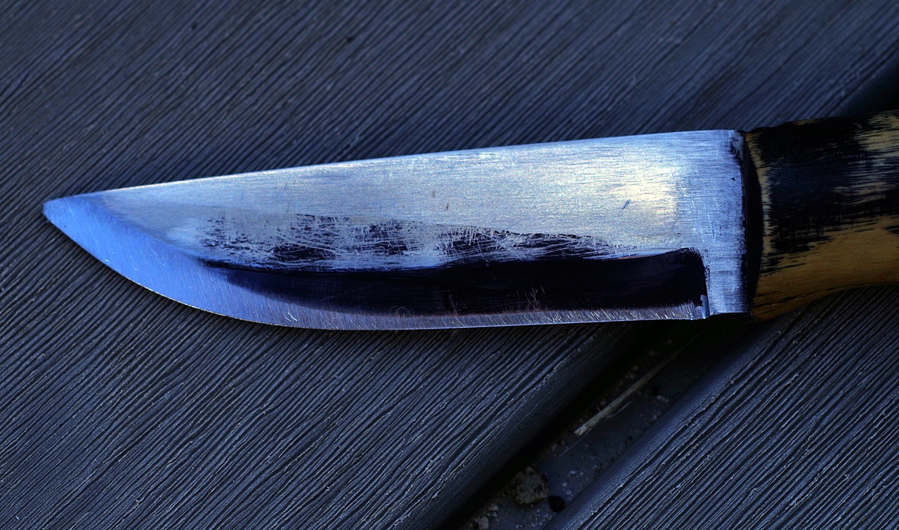

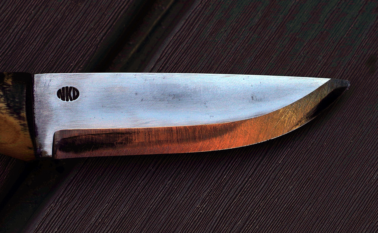

My NKD ... Oh dear / oh dear / oh dear !
The edge was ""FUBAR"" Factory FUBAR ...

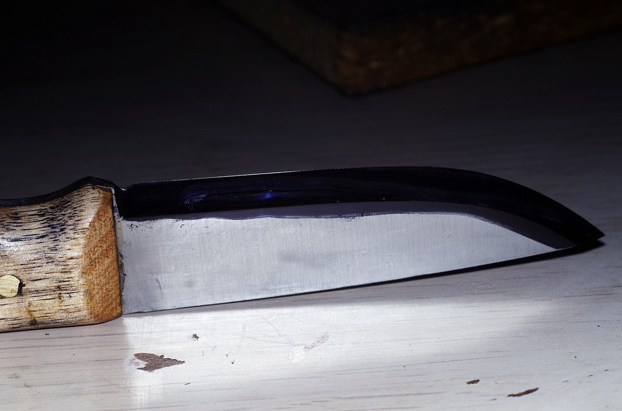

I did want to 320 grit the edge ( and I have ) , but the amount of work needed to ?
Neither side matched the other for ANGLE .. Also whom ever ground the scandi edge lingered here and there making hollows everywhere .
I took these pictures about half way cleaning / re profiling the edge . I was hacking away at the blade with 80 grit diamond ( Cos there was a lot of FUBAR to remove )
Don't I just hate taking a closer look at a knife edge ! They really can push out Rubbish sometimes !
1st Picture . Near the tip .. Is a very large hollow created by lingering on the belt (?) grinder . There was one such hollow both sides , but I was able to clean up one side ( Pic2 )
But the angle of the bevel was complete rubbish ..
I was planning to 320 grit test the NKD , but it will have to wait for another day ..

NKD Timber 95 / 80crV2 Carbon Steel .
Previously 100/150
Carefully hand sharpened 300
Scandi edge was some what corrected ( Still lots of FUBAR left ) Yes , the factory Scandi edge was quite horribly done !
Anyways , what grit was used for making corrections does not matter ..
Because the finished edge is 320 GRIT .......... & Full Scandi / No micro bevel / No convex .
20 passes each way ( 20 one way then 20 the other )
10 passes each way ( yes 320 grit )
5 passes each way
2 passes each way
followed by one pass each way for a total of ten passes ..

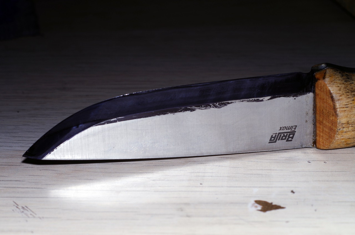

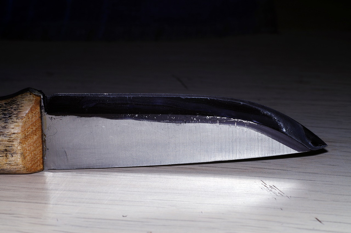

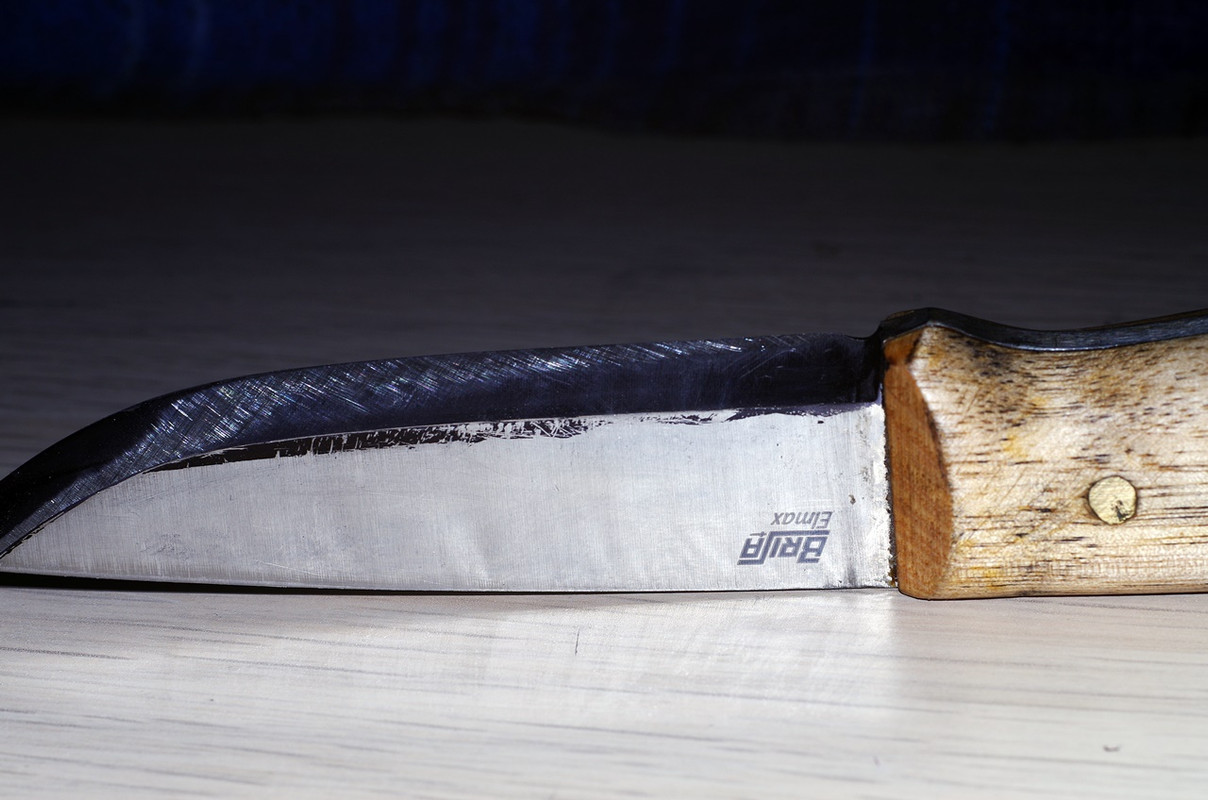

Oh dear ! Brisa Elmax ( Scandi )
Just how rubbish can a blade be ?
Is Brisa and NKD coming out of the same factory ?
Because the FUBAR looks to be the same !!!!
Blade edges have been blackened out so we can see where we are sharpening , & how FUBAR the factory edge is .
Folks , don't do this .. Your delusions might be seriously ruined ( in regards to your fav knife ) . Doing this is a serious reality slap in the face !
Oh yeah ! That be some serious FUBAR ........ Doing both sides at the same angle & .............................................................................................
The result of about 3 hours work !
And there is still FUBAR ..........
I did another one hour ( maybe more ) today , & I'm all re profiled out ! Yeah , I'm done / no more .....

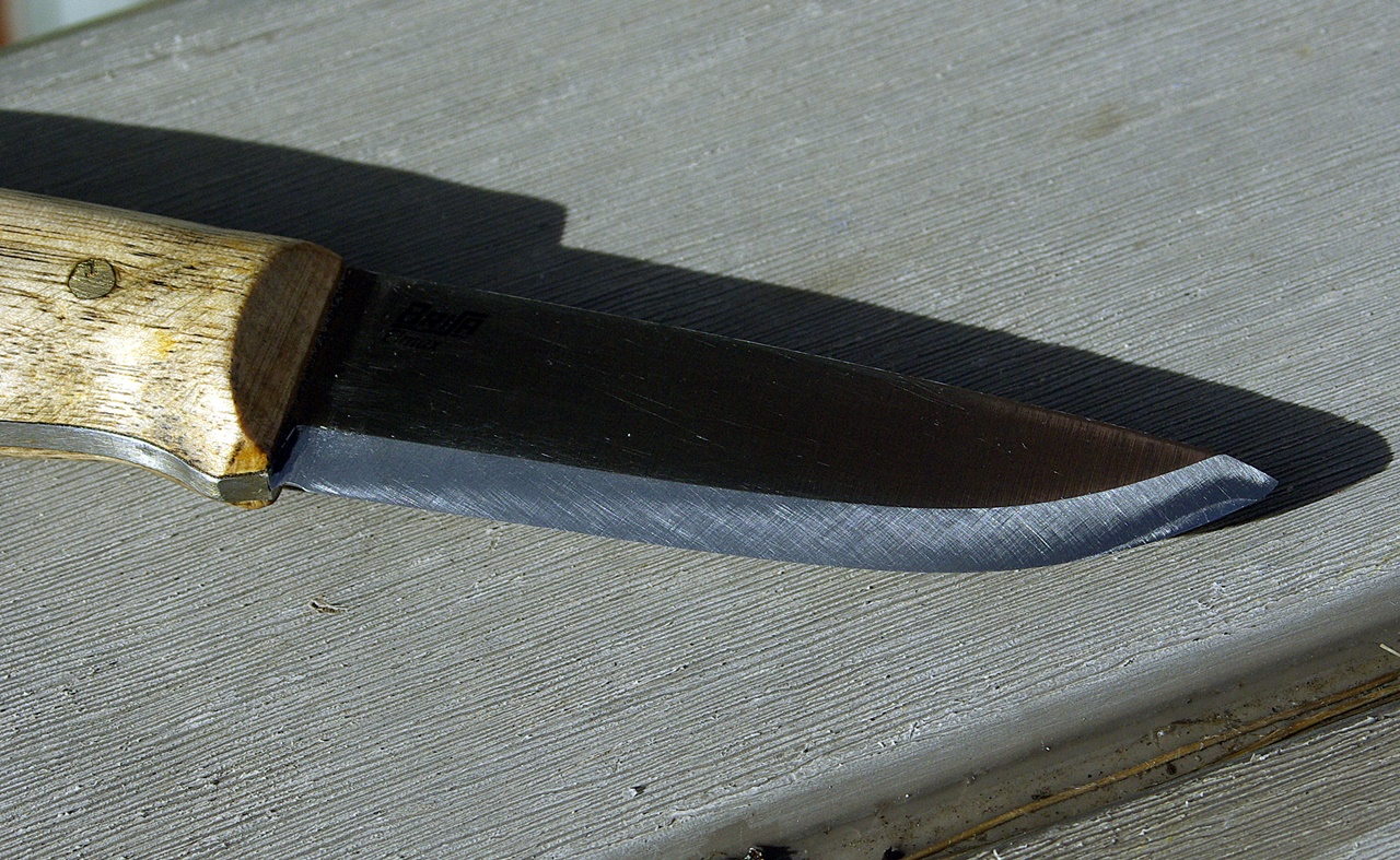

My Elmax Scandi will hit the rope @ 180 grit Oxide ... ( It's toothy )
I mean 320 Grit Diamond is just something I settled on by chance ( No rhyme or reason ) , well besides I was testing coarse grit sharpening ! It could easily have been 240 grit .
And next it's 180 grit Oxide because I'm sick of hacking at that Factory FUBAR edge and just removing years of use .. ( Ok , it's a much better looking edge )
And can stone replicate Diamond ? It might be a case of - Got to do your own thing ! I mean / 150% gains / ain't nothing to sneeze at ! So , maybe worth chasing ? If you chase edge retention ?
I'm not here to spoon feed anyone , maybe just kick over a few grey cells !
Just know , these edges are toothy - Micro hacksaw toothy . The 320 was much less toothy and still gave gains .. So nothing is a GIVEN , who knows what the magic grit is or if such a thing exists .

I have two knives on my table that have bling edges . Both are go to knives at the moment ( ATM ) and I am just seeing how it is to live with polished edges .
So far ? The only real benefit .............. seems to be maintenance . ( Easy to maintain )
How much easier I can't say , but so far they certainly seem to be easier to maintain . ( Not scandi / just conventional edges )
Ok . one Morakniv knife sharpened Coarse by hand with a small stone ...
Didn't take that long , feels very hacksaw like thru paper .

BAHCO Laplander - Sharpened with small / cheap Chinese stone . Cos the stone is so small , no edge correction will take place .
With shipping , I paid maybe around $2.50 each for these stones ..
They work fine for me sharpening Scandi ( stone size ) ..
Previously I went 5000 / 10,000 grit .. But these are maybe 180 grit (?) maybe . The add does not give a grit .
Result was a 250 slice fail though .. And no edge correction has taken place this time around ..
I will re sharpen the knife the same way and see if it gets better or worse or makes no difference .
