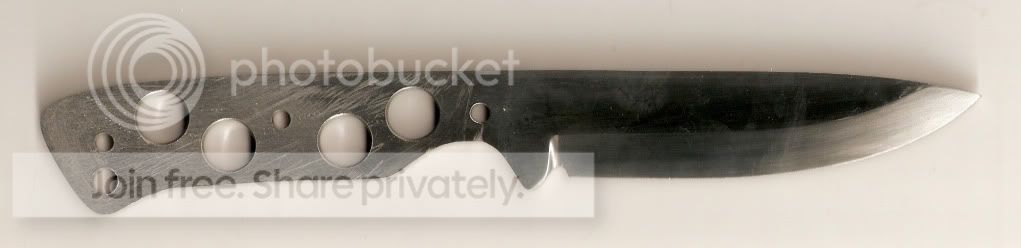

I just finished up the grinding and am doing the pre HT sanding on my first scandi grind right now. They are flat ground and follow the cutting edge to the best of my knowledge.
I just whipped it down and scanned it so not a HQ pic
Looks like it will be a great camp knife similar to what I had in mind. Thanks for clarifing havn't found too many posts on this particular grind but it has my intrest. would love to see the finished product!
It has a sister knife too that I am doing as a convex. They are the exact same profile, just the grinds are different. Once they are done I am doing a belated:o 1000th post give-a-way and the winner will get to choose from the two
