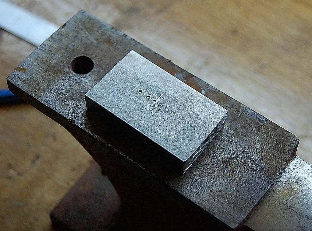

Well didnt get too much done today. Cut the gaurd stock from some 303 stainless. Oversize enough to make sure I dont come up short anywhere. Scribe a center line and mark off the width of the blade. Be sure to mark where it will taper as well, you dont wanna get it filed out and find you took the thicker portion down to far. This is where having a mill would be very nice. Going with files takes a little while. I got some of it finished today but need to file a V at the bottom and continue fitting.
Marked and alignment punches set.

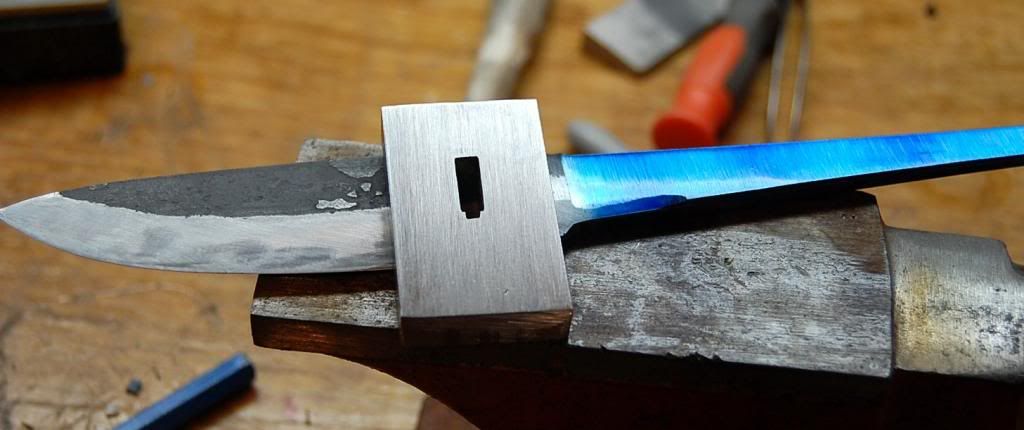

Here Ive drilled two holes then started filing. Very important to keep your file work even and neat. Take it out of the vise often to ensure your not drifting off to one or the other side. I also sprayed the tang with blue to see where it hangs at. Makes it much easier to see.

Wow! Very good idea with the blue on the tang!
Looks good!
