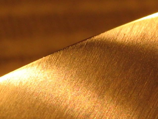

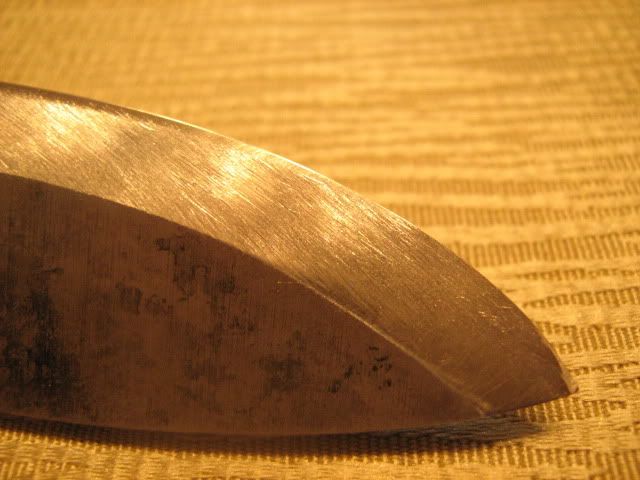

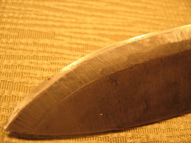

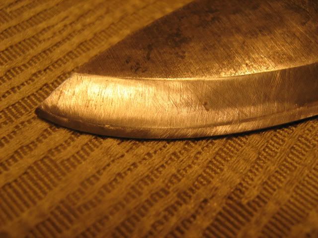

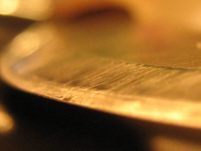

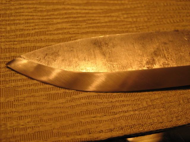

Well it has arrived at my door step and to say that its still a scandi would be just being nice. I don't even know if I can fix it and if not it will be coming back to you for a regrind John.
When the first reviews were popping up I emailed john asking him what he would like to see from these reviews. To me this was a test run of the scandi grind and the knife it was used on was simply a mule for such grind. I asked John and he confirmed that info on his grind was what he was looking for.
Here are some Pic's of its current state.

Bring it back to a single bevel. Single bevel=simple sharpening=easier to get sharp=happy knife owner.
Wow that would take a while to fix, but I think it should be doable on an XXC.
Lets just say I have a few hours more work before you can call it a scandi again, even with the XXC.

Progress is slow because the way O1 grinds, its very close but still needs some work. I've worked on it everyday but because of its condition I should have picked up some 40 grit sandpaper, you only think a DMT XXC is coarse until a job like this.

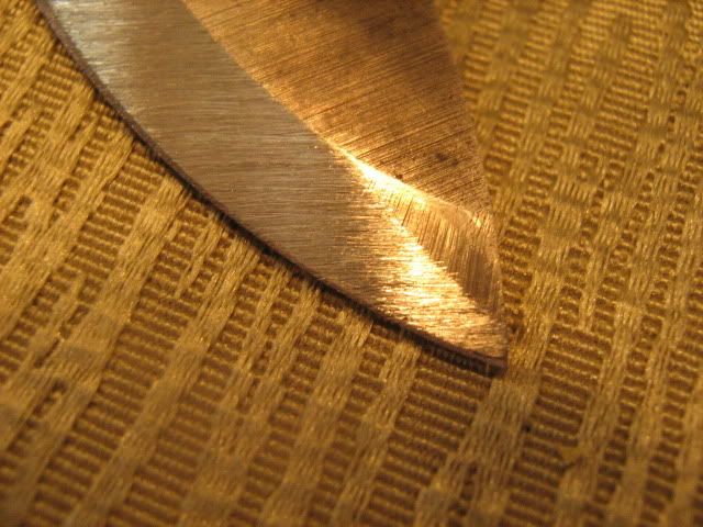

So after a whole lotta grinding and a bit of polishing it back to a scandi :D
There were a few things I had to fix though and is the main reason it took so long.

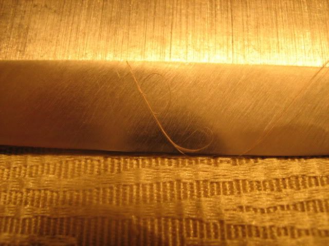

I finished with my natural Aoto stone then added a micro bevel :eek: with my 12k naniwa super stone. A little strop on hard felt and its nice and sharp.
Don't worry the micro bevel is so small you probably won't even know its their. It will not effect normal flat bevel sharpening either.
Its not my best work and its not perfect by any means but its 1000x better than before. Lets try and keep it this way ;)

And that's the key to a micro bevel, they need to be micro. Though it may sound slow using a spyderco UF ceramic, 8k water stone or higher, or any other very fine abrasive you only need 2 or 3 strokes per side and its ready to go. My review will cover many of the things I think a scandi edge should be and hopefully make yours one of the best on the market :thumbup:
